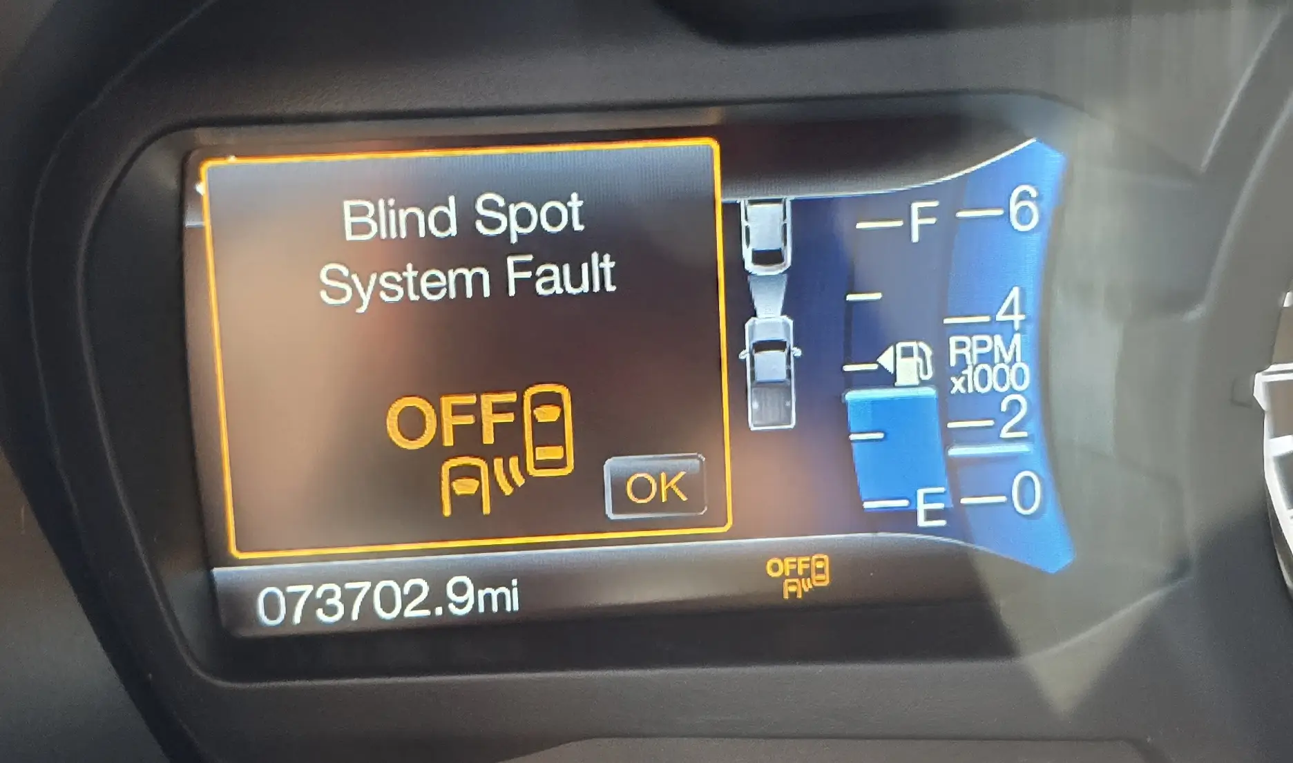

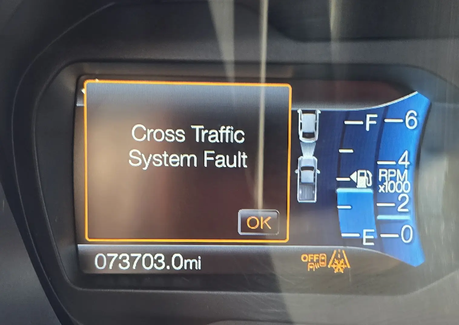

This started a couple of days ago and has persisted. It is intermittent but continues to happen and is getting very annoying. What happens is I get an error on the dash for "Blind Spot System Fault" followed almost immediately by a "Cross Traffic System Fault". It will stay there for a bit and then clear itself after a while. And then the cycle repeats. It is not completely regular - meaning it doesn't happen every 30 seconds or every minute or any consistent length of time - but it is consistent enough to occur quite a bit. I just got back from an hour drive and it probably happened 20-30 times during the drive.
A couple of other weird/interesting things happen when this occurs. I have the "cold weather monitor" (snowflake) turned on in Forscan and when this occurs, the snowflake usually appears. Sometimes the temperature readout on the screen will disappear, sometimes not - but the snowflake almost always appears. I've also seen the airbag light come on sometimes when it happens, but that does not happen very often.
I took the taillights out just to see if something had happened to a connection or something - both looked fine other than a lot of dust (I drive a lot of dusty forest service roads)- no damage to the wires - I'm guessing that there may be some mouse damage somewhere - I had a mouse in the truck a while back.
Any ideas for what to look for would be appreciated before I take it somewhere to have it looked at. This is kind of a weird one.....
Also - until I can get this fixed is there a way to turn this off? I haven't seen a setting that turns off blind spot monitoring or cross traffic alerts.
Look in the menus under Driver Assist to turn BLISS and Cross Traffic off.

One other symptom I noticed is that when these errors are displaying the turn signals flash fast - when they are gone they work normally.
Yikes! There are a lot of them - I know the U0422 is nothing to be worried about - that is due to a change in the tire size to fix the speedo - but some of the others look very concerning:

Have you checked for water/moisture in either taillight and its corresponding BLIS module? You might want to remove each BLIS module from the taillights and check for corrosion on the module and in its connector. Many of your DTCs are communications related and a corroded BLIS module or wiring can cause problems with the communications buses.
RedlandRanger
RedlandRanger
Nov 14, 2018
44
5,196
11,371
I took one of the BLIS modules out (the drivers side) and it was VERY clean - the connector to the taillight was very dusty but the BLIS module connector looked great - I did not remove the connector though.
RangerBill
Bob
Jun 8, 2022
1,853
2,600
PA
You could also try unplugging both taillights and clear all the codes. Then rescan to see what codes come back.
RangerBill
Bob
Jun 8, 2022
1,853
2,600
PA
You need to look at both taillights and their BLISS modules.
Grandaccess
Robert
Jul 8, 2023
1,180
2,749
Binghamton, N.Y
2021 Ford Ranger XLT FX4
Computer Consultant
I have something like that going on too, I figured it was because of my bull bar blocking it, I click ok and move on?
Grandaccess
Robert
Jul 8, 2023
1,180
2,749
Binghamton, N.Y
Computer Consultant
I had one replaced by a body shop and he said they couldnt get the error to go away, I dont know what program they had, I dont want to spend the money at the dealership for them to trouble shoot it, I have forscan I just dont have the time :(
RangerBill
Bob
Jun 8, 2022
1,853
2,600
PA
I believe that you have to enter the VIN number in the BLIS module if a new one is installed. Forscan should be able to handle that.
RedlandRanger
RedlandRanger
Nov 14, 2018
44
5,196
11,371
I took it out for a hike today and for now, I've disabled the blind spot monitoring and cross traffic functions. I needed to disable those when it wasn't displaying the errors - once I did that it seems like the warning stopped. I could see the disabled icon in the dash appearing and disappearing (the issue is still occurring), but at least I'm not getting bugged by all the warnings over and over and over. I will try and dig into this tomorrow or Monday to see if I can see anything.
Cabose-1
Eli
Jan 19, 2021
2,021
7,665
Student
Obviously a module is on the fritz. Question is which one. Check grounds, one part of the system is wrong it makes everything connected to it act wonky. You will have to find a wiring diagram to see what all the devices have in common and start the search for individual modules. With fords it is a long and learning process. Maybe a unplugging until one of them makes the codes go away. What i used to do for ford vehicles.
Good luck
RedlandRanger
RedlandRanger
Nov 14, 2018
44
5,196
11,371
Good luck
I've had mice in the cab (I can see the damage from them) - I'm much more concerned that there is some wiring damage somewhere rather than a module on the fritz.... Fingers crossed I'm wrong, but time will tell. I'm no wiring expert so this may end up at a shop for this.
