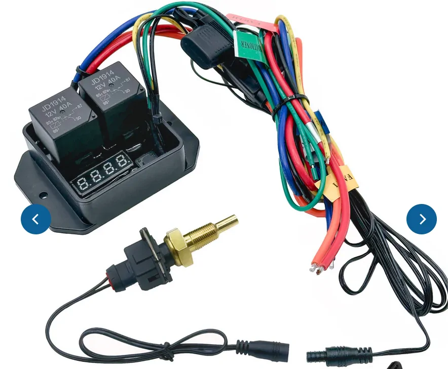

I think the simplest solution for an electric fan conversion is to determine if the electric fans and shroud from the 6G Rangers will fit the 5G. I just checked RockAuto and they have the 6G dual fan /shroud assembly for $249.

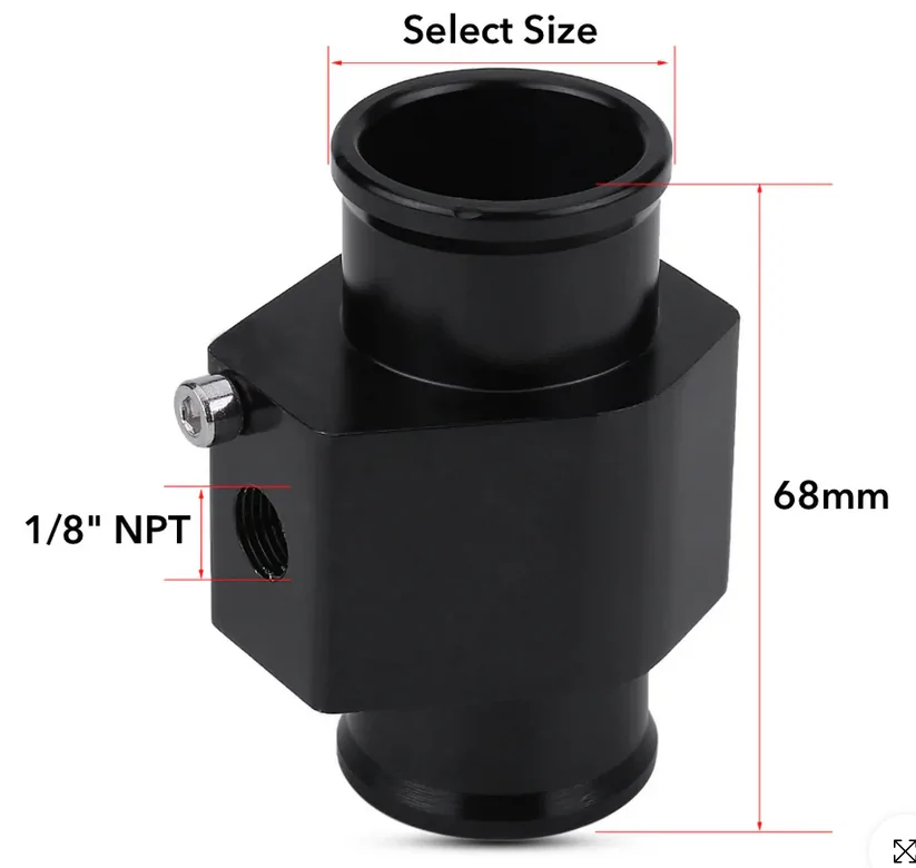

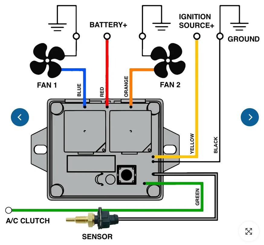

It that is the case, the next thing to figure out is the simplest way to control them. I think something like the Digital Fan Controller from American Volt is a great option. You can select from 3 types of sensor adapters- inline hose, mechanical fit in radiator fin, or different size NPT sensor into a coolant port or hose adapter.
Easily under $100 and it handles the AC by tying into the AC clutch power feed the (AC on circuit). No need to open the AC pressure lines.
The only thing left to do is determine what to disable using Forscan to keep from throwing any DTCs. This is great programmable independent system. I've got one that is going to control the fan on my remote transmission cooler project. There are clones on the market for less, but the relays are trash... and you'll end up spending far more to make it right.
  • 104-230'F digital adjustable electric fan thermostat switch wire kit.
  • 1/8, 1/4, 3/8, 1/2 inch NPT threaded temperature sensor for any port.
  • 40 amp relay harness with 14AWG wire powers up to 2 electric fans.
  • This fan switch kit is compatible with either 12 or 24 volt applications.
  • Maximum 30 amp continuous draw with 30 amp in-line fuse per fan.
  • A/C override or manual toggle switch wire built directly into harness.
  • Optional second fan starts 10 seconds after first fan begins cooling.
  • Turn-off temperature is preset always 10 degrees less than turn-on.
