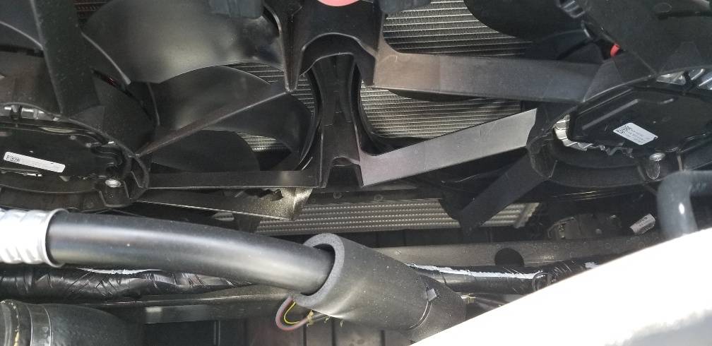

here is a pic of the 24-ranger fan assembly

intercooler pipes run under the radiator now
