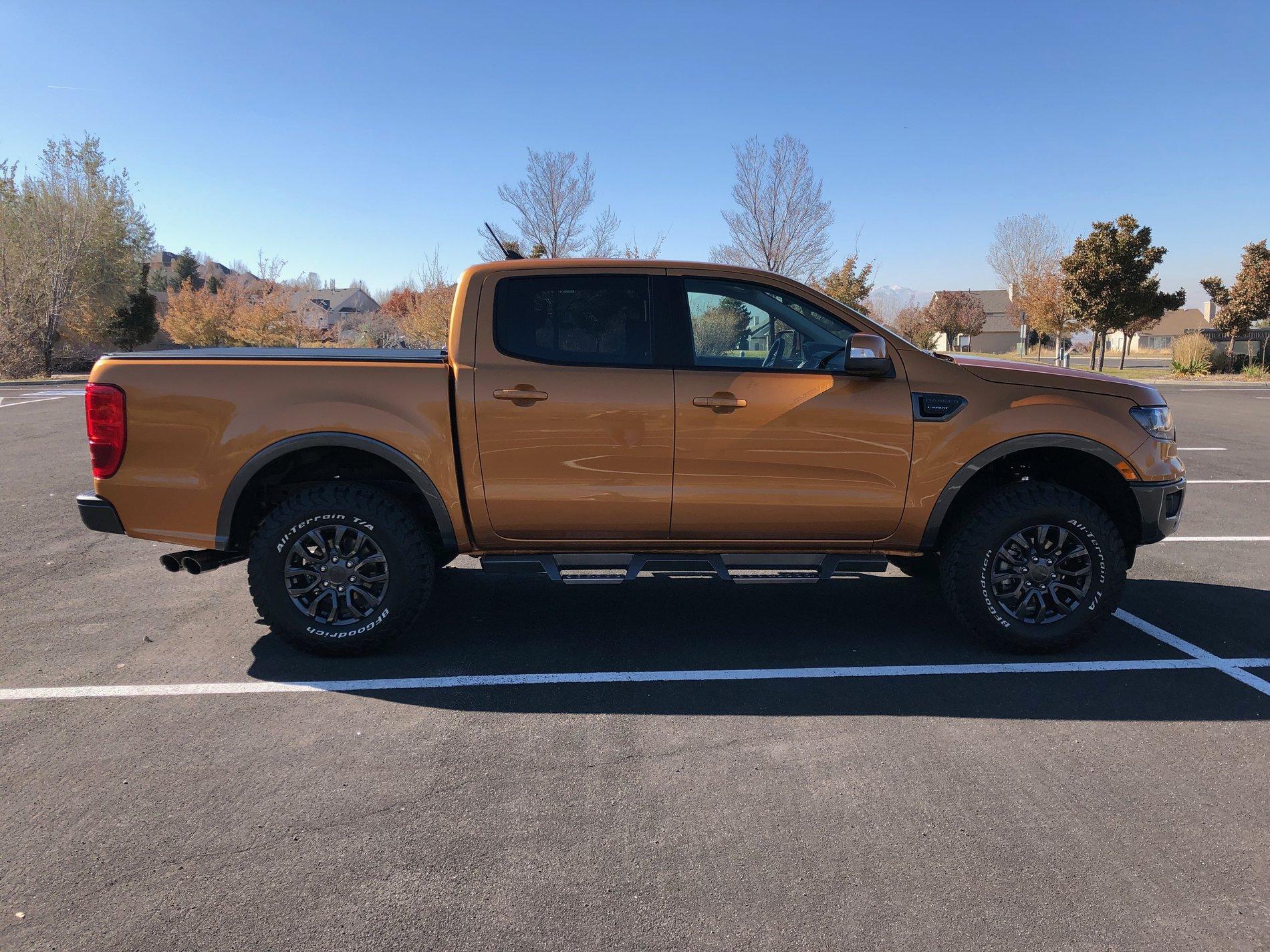

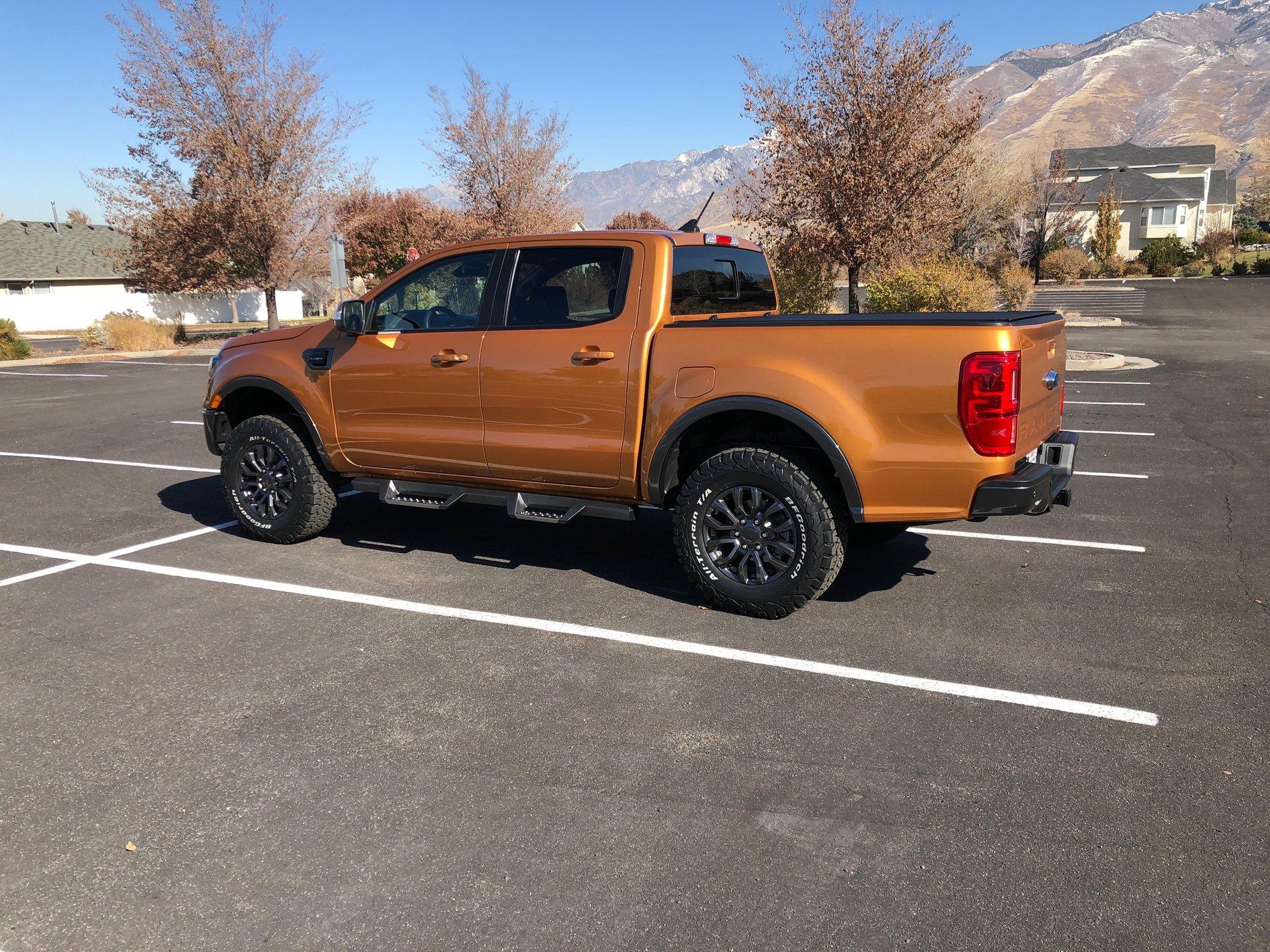

Just finished installing eibach pro truck lift with black rhino armory and 285/70r17 wildpeaks
Perfect! Exact same wheels I plan on running, just waiting till some more free cash-flow. I like the tire/size choice. I see your in NV so asking about the grip/braking in the rain with those tires would be silly. Zero experience with Wild Peaks.
Looks Great!

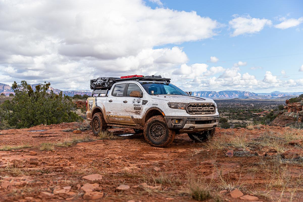

That's not entirely correct. While we do list the coilovers alone, we also have our Fox 2.0 Stage 1 Package that comes with both front and rear. That's the system we put on our 2019 Ranger Project.

According to Fox, the ride height adjustment is roughly a 2:1 ride height-to-collar thread ratio. So to get down .5", you'd drop the collar by .25".
That being said, you may want to see where you're at in regards to ride height when you first get the coilovers. In our experience, Fox is not super-consistent with their out-of-the-box ride heights. The 2.5s we put on our 2014 Hunting Truck were set at essentially 0" of ride height, and we had to raise them up quite a bit, considering we had both an add-a-leaf kit and larger block on that truck to handle the DECKED System and quad.
I know it's annoying to essentially do an install twice, but better safe than sorry.

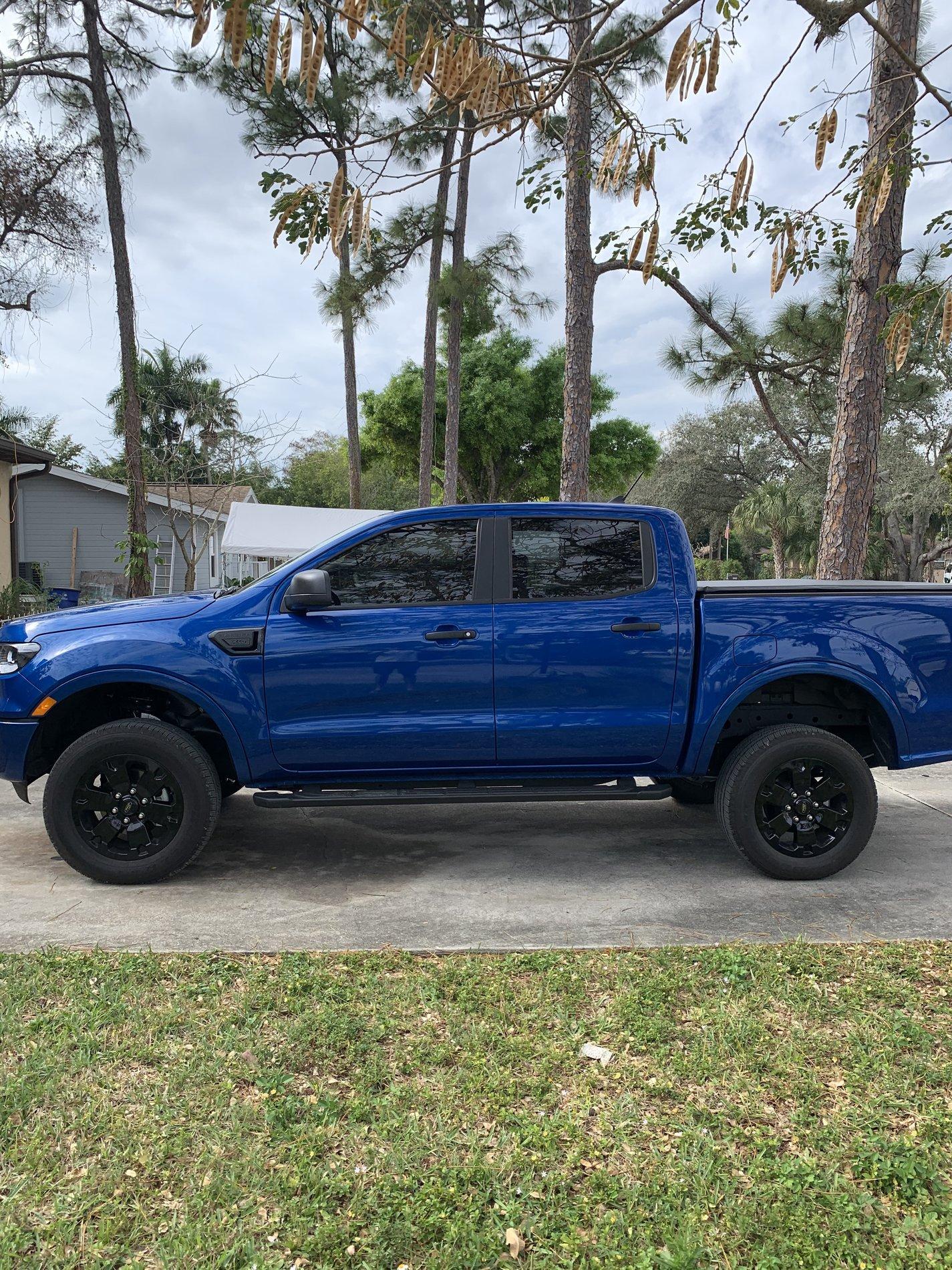

I got a quote from the dealership I bought my truck from to see exactly which level kits they endorsed/installed. They offered both Ready Lift and Tuff Country. I decided on the Ready Lift based on all the research I could find. Not surprising, the dealership was over double the price of a local off-road specialist.
I considered installing the Ready Lift myself, but after reading the install instructions, as well as some of those who have done it, I decided it was above my pay scale!
So I had the Ready Lift 3” Level installed at the shop where I bought my tires. The whole deal included 4-BFG LT KO2 275/70R17, level kit install and alignment. The shop specializes in lifts/levels of all sorts. They have done many Ready Lift installs, but this was their first level on a 2019 Ranger. The tech said it was “more involved than he first thought”. They had the truck for 7 hours, and I had to wait ½ hour after closing to pick it up…. So I think it was pretty tough and I’m glad I didn’t try to install!
(BTW, no trimming or modifications were required on the level/tire install and I have had no rubbing issues either)
The 3” Ready Lift Level Kit puts the truck virtually level (unloaded). I don’t plan on towing much if anything (I use the tow receiver for my KUAT bike rack). I measured from the garage floor to the top of the wheel well trim (straight thru the center of wheel) and the fronts are 38-1/4” dead-on and the rears measure 38-3/4”.
My Wife and I both agree the leveled ride is better than the stock ride. Because the tires were swapped as well, it is not possible/fair to credit only the level for the ride improvement. The ride is great and we love how the truck sits!
