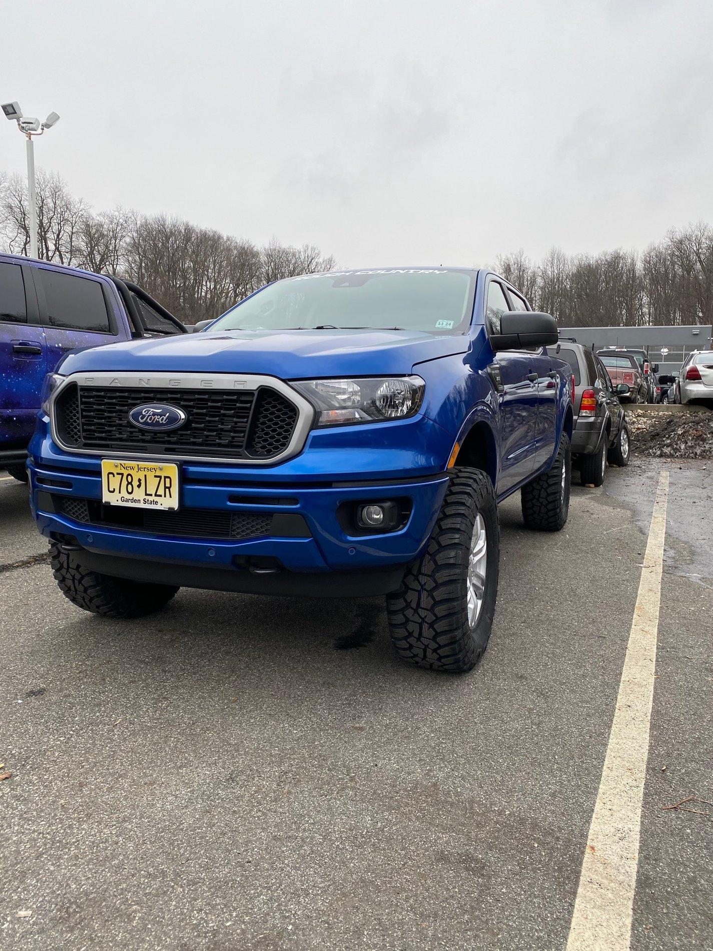

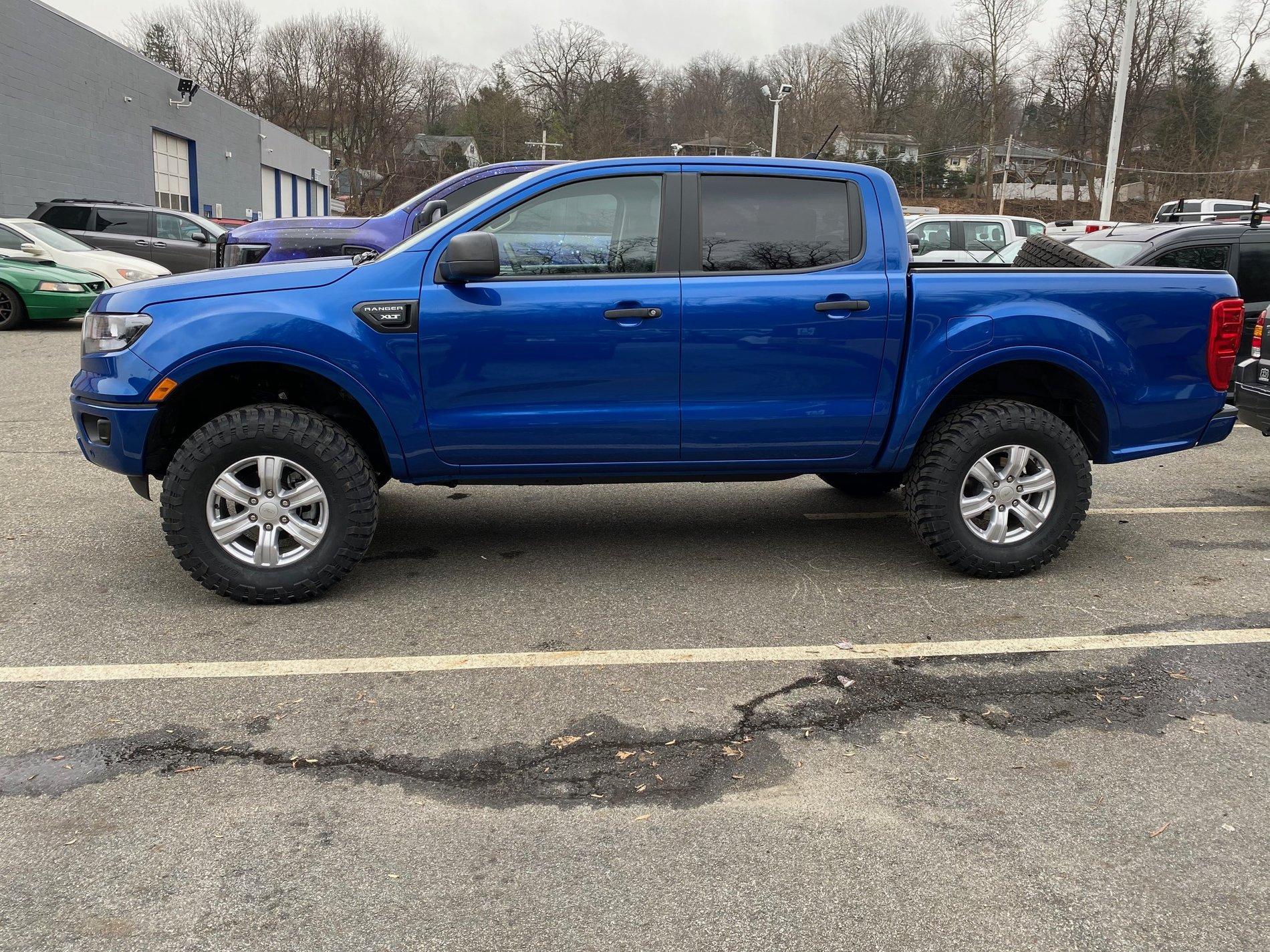

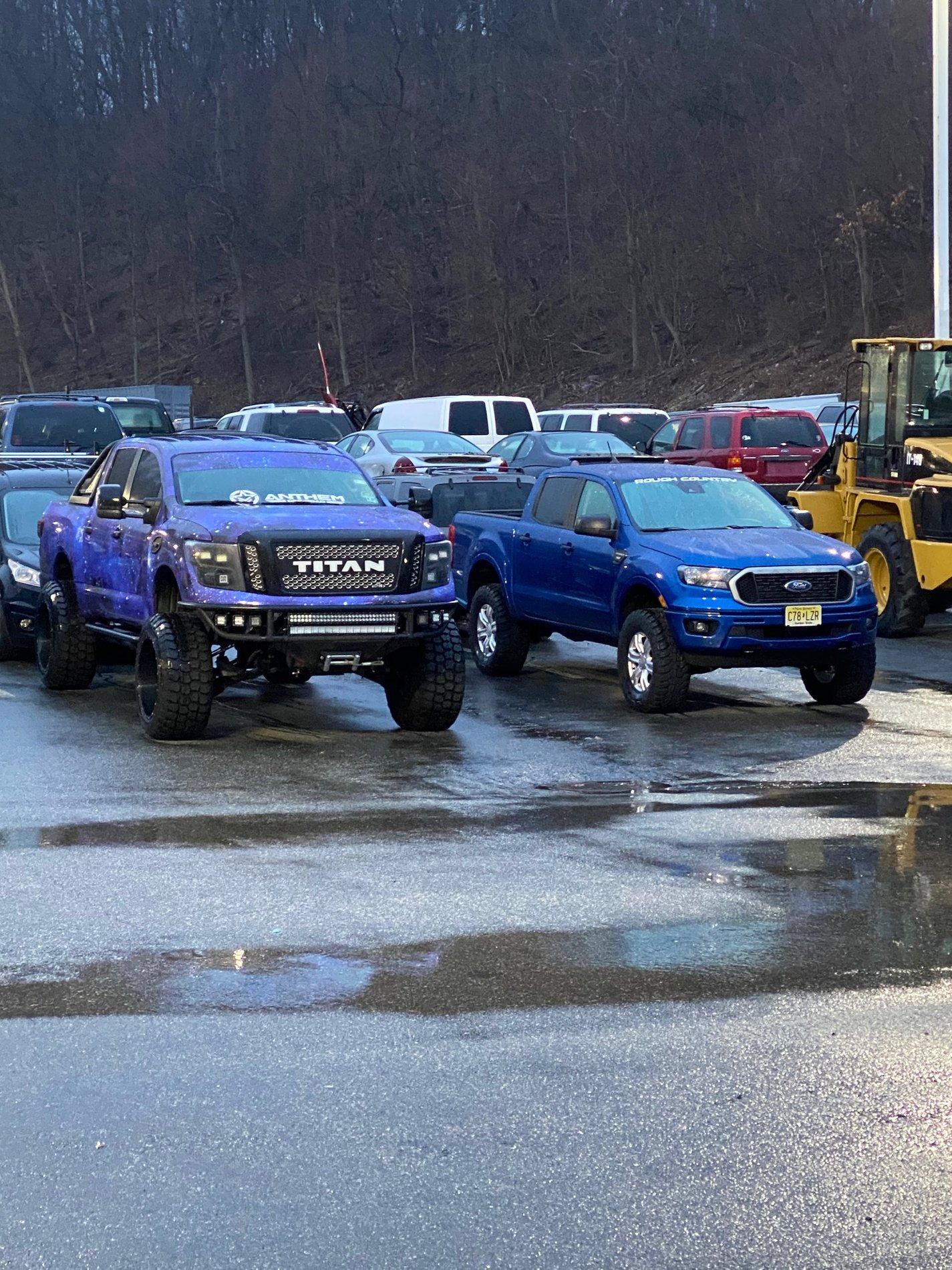

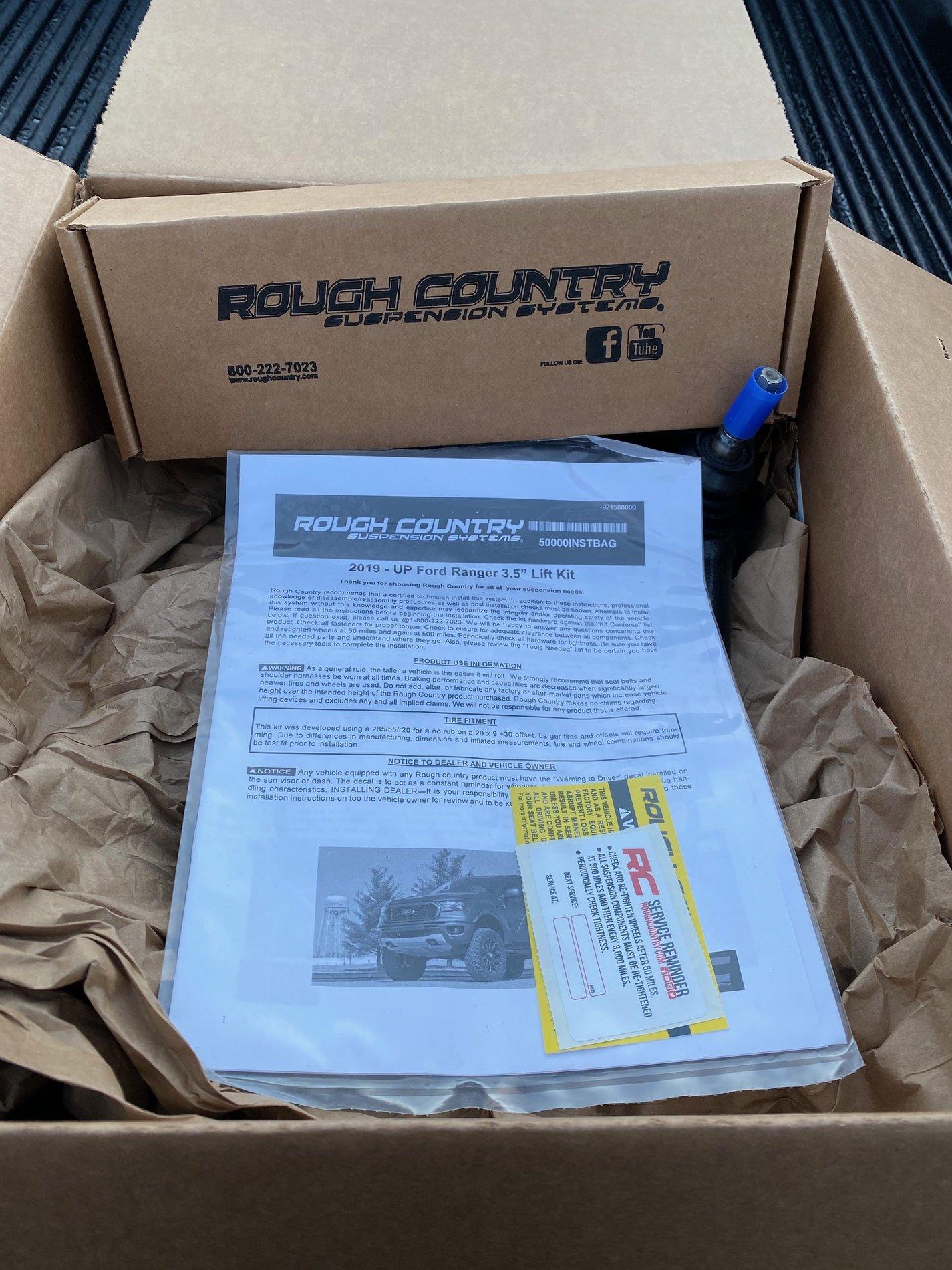

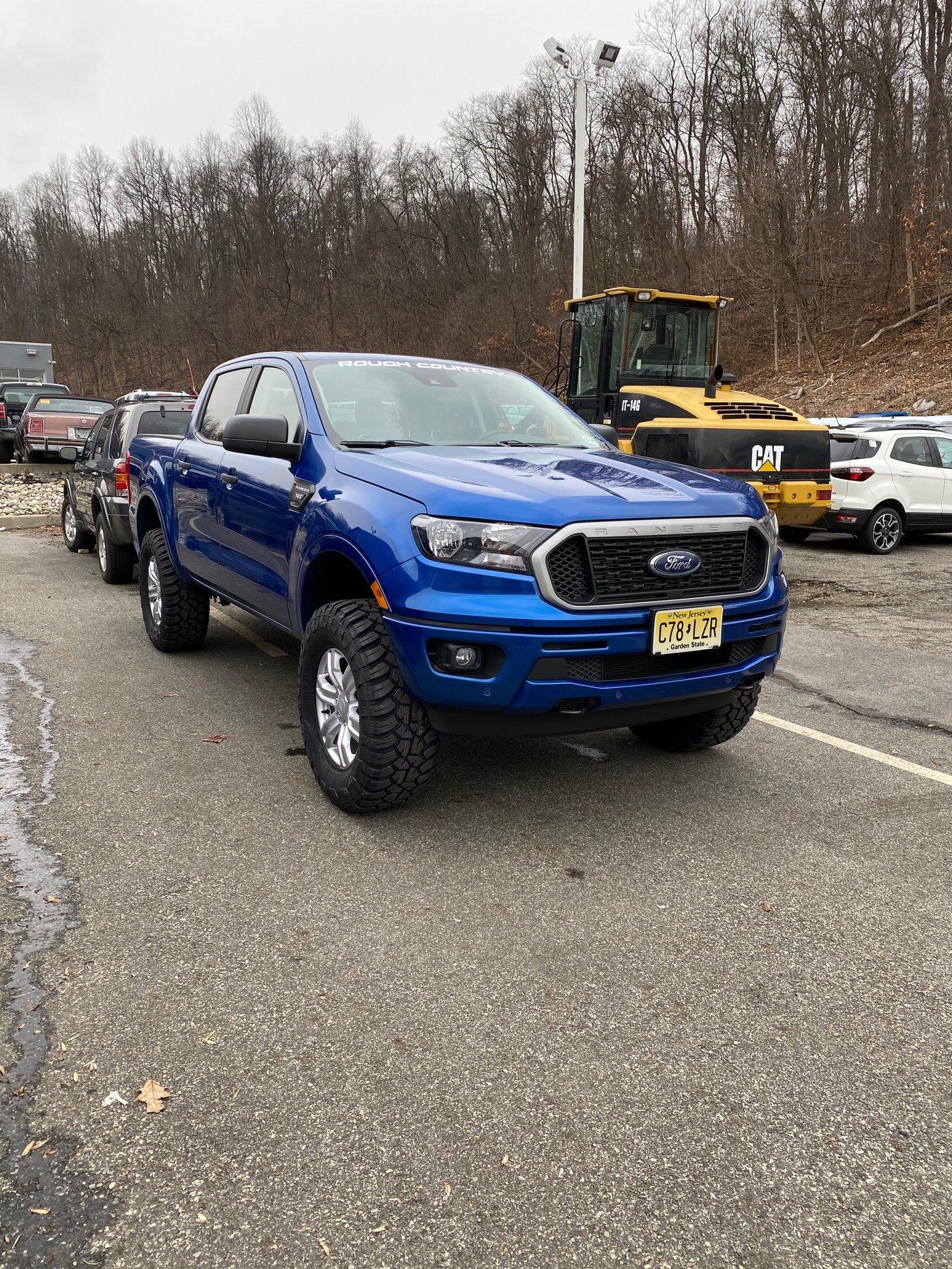

    Just finished installing a 3.5 inch lift kit from Rough Country with 33x12.5 on 17 inch factory wheels. There's slight rubbing but nothing serious just need a minor trim. I had to get an inch and a half spacers for the front because the tires were rubbing the knuckle. The ride is great though.

    Good looking truck! If you went with a 1” spacer instead would it help the rubbing?

    I have an inch and a half spacers in the front and it still rubs a bit. When I put the wheel and tire on in the front it was already touching the knuckle without the spacer.

    I was meaning if the rubbing was from the outside corners of the tires, a smaller spacer might bring the wheels back in enough to clear.
