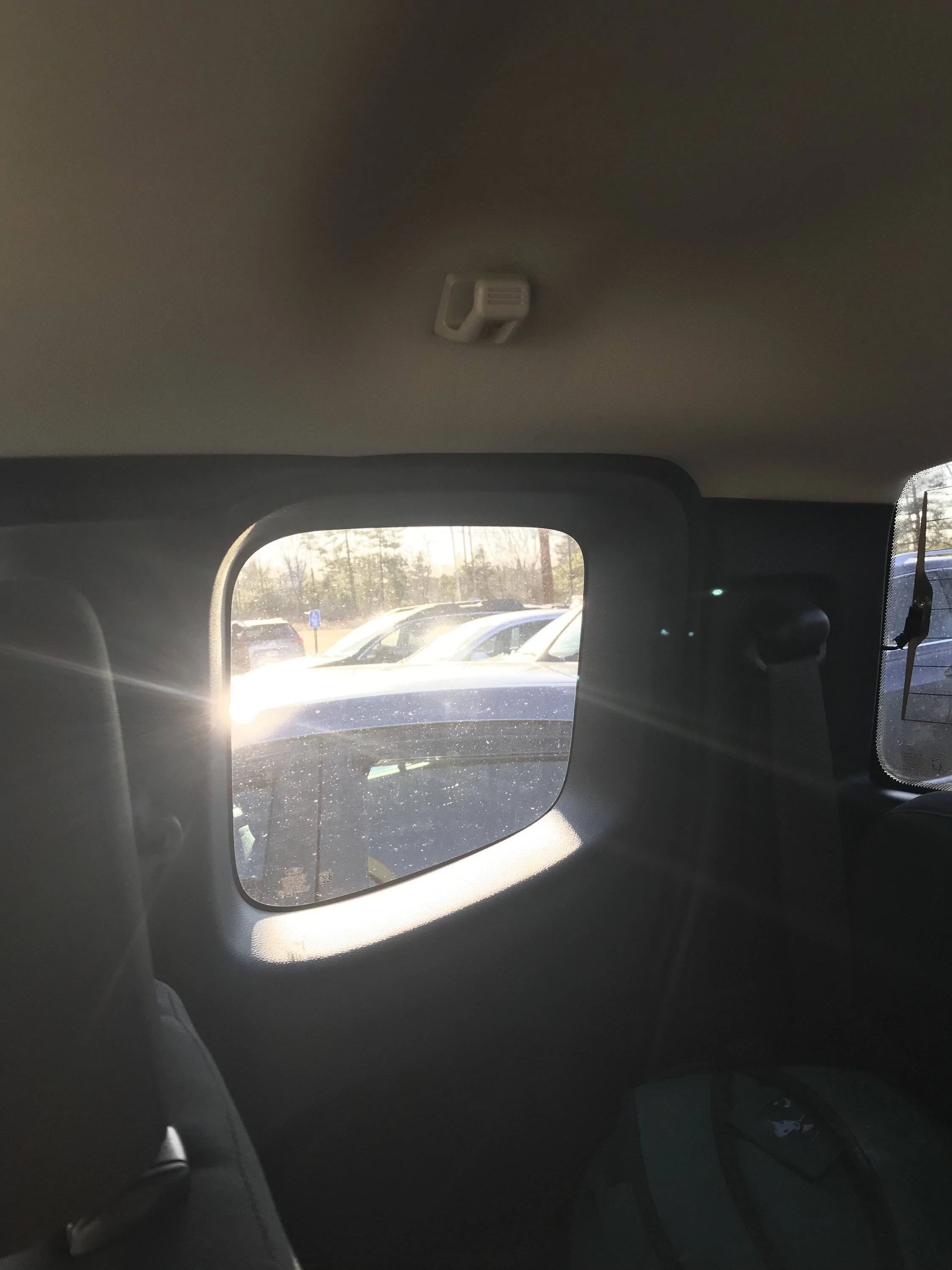

The SuperCab has them over the port hole windows in the back on both sides
