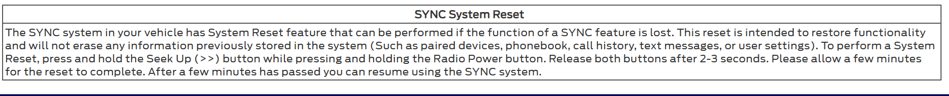

Well, I tried the reset Idea to no avail.
