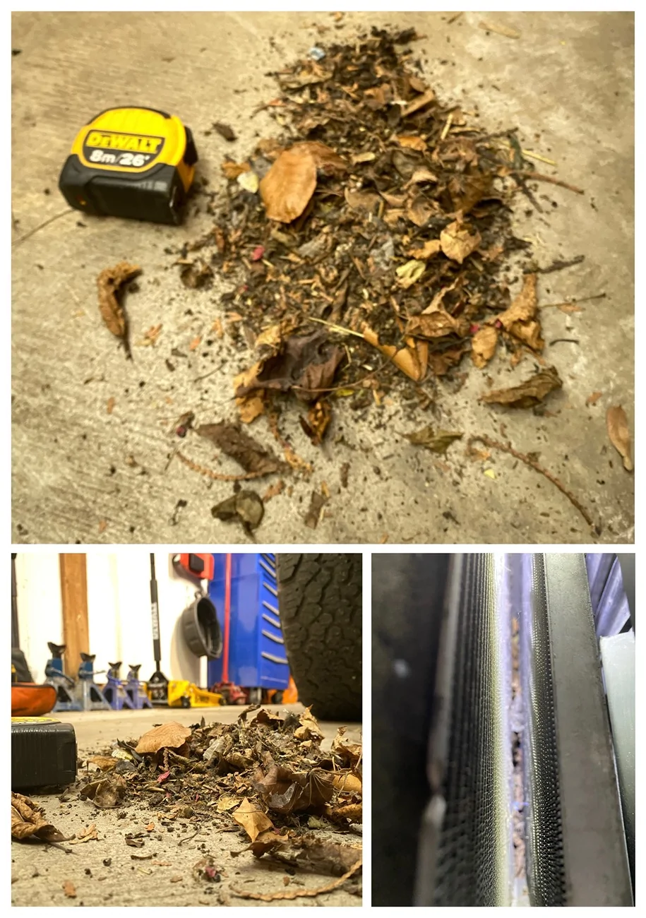

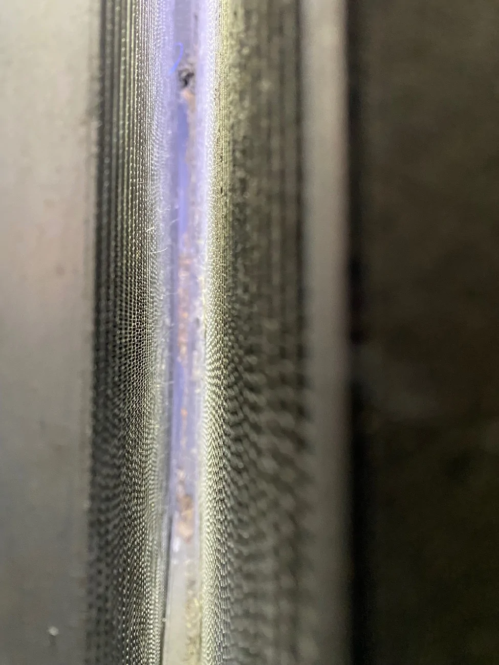

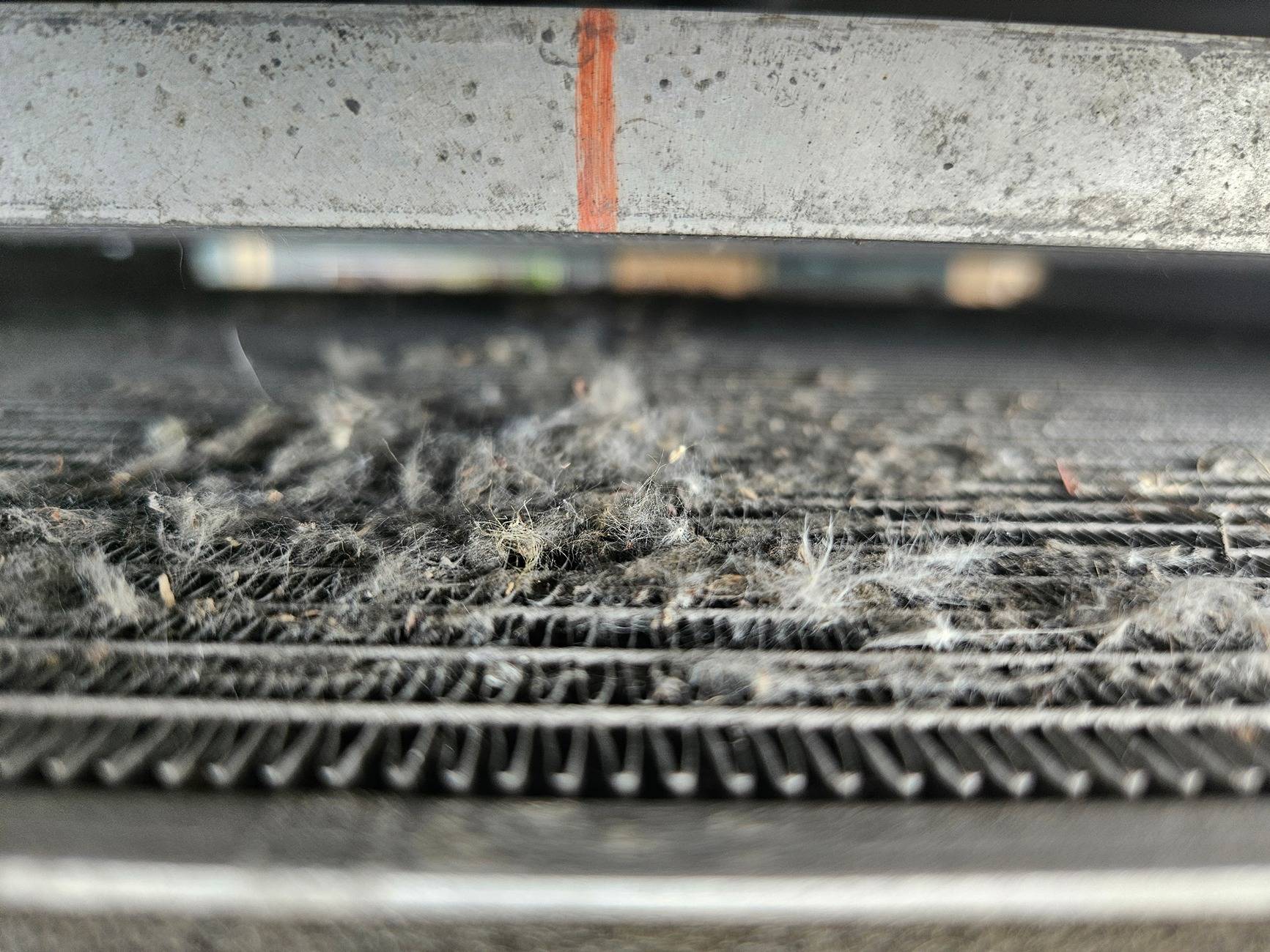

resurrecting this thread as I had this same issue.

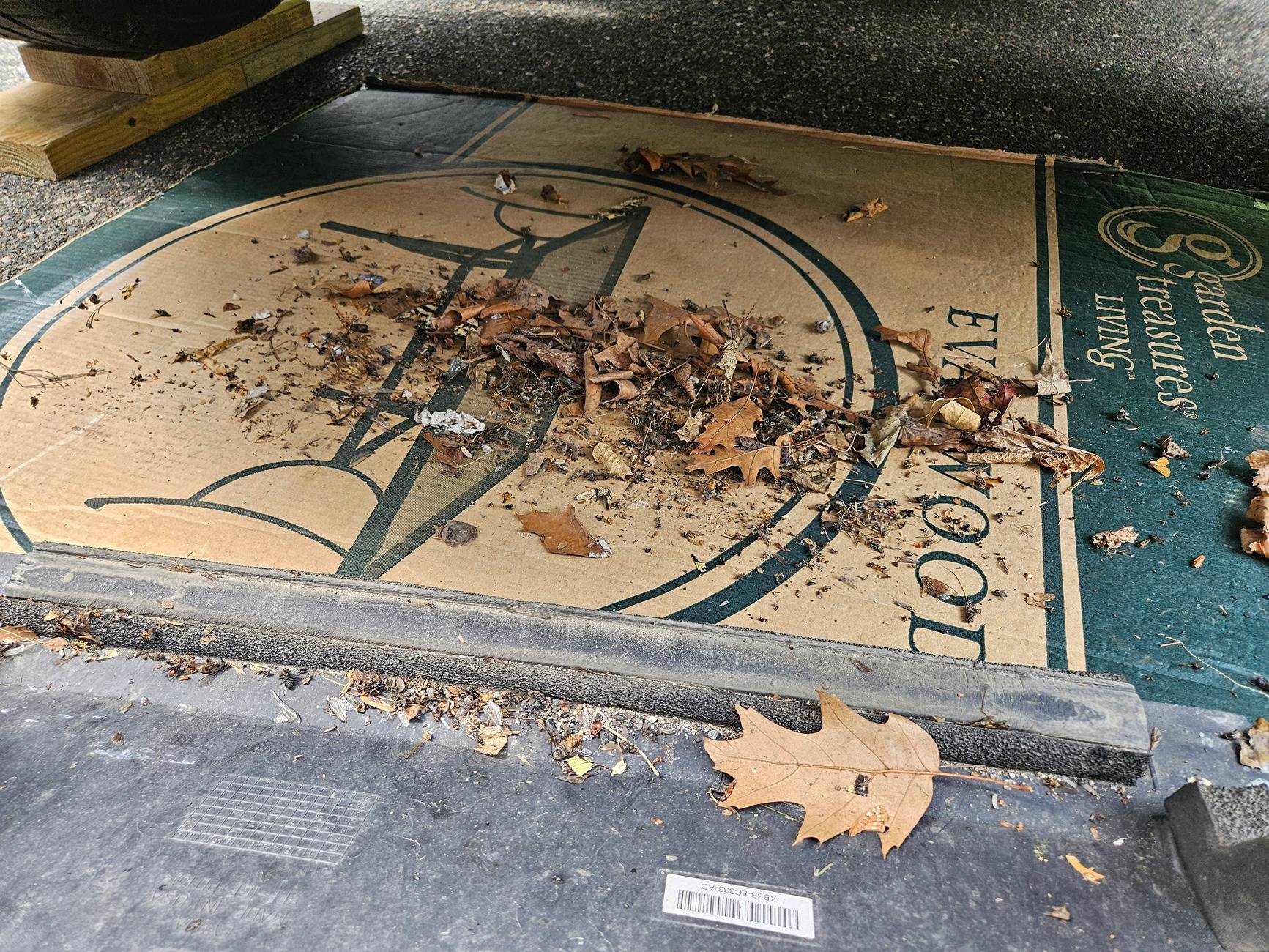

I had the large trim piece that covers the radiator off to fish wires for my front camera. While it was off, I noticed quite a build-up of debris on the fins. It looked a bit like dryer lint, dandelion seeds, or cottonwood tree fluff. It was quite loose and a gentle touch with a swiffer duster was doing a fairly good job. I grabbed the work light I was using to see how far down it went. It only went about as far as the length of the swiffer duster and I was clearing most of it but I was surprised at the pile of leaves and debris down at the bottom - about 2” deep, all the way across!
There is a plastic bottom shroud that was keeping it trapped in there but there was a way to get my fingers in from the bumper area and clear it out.
At first, I was thinking rodents but I’m just not sure. It wasn’t matted together with hair or anything else. It just seemed to be dried leaves and cedar tree bits. Any fluff that was in it likely fell down onto it while I was clearing it from above.
PSA for anyone coming across this…if you ever have that large upper trim piece off, have a look between the radiator and condenser (or whatever that is in there). If there is a build-up of fluff on the fins, you might want to clear it out.
You can also reach up onto that lower plastic shroud from underneath to see if you can feel any leaves or debris. It was easy enough to clean.
Note: No overheating events prior to this discovery.
Clean as a whistle now…
