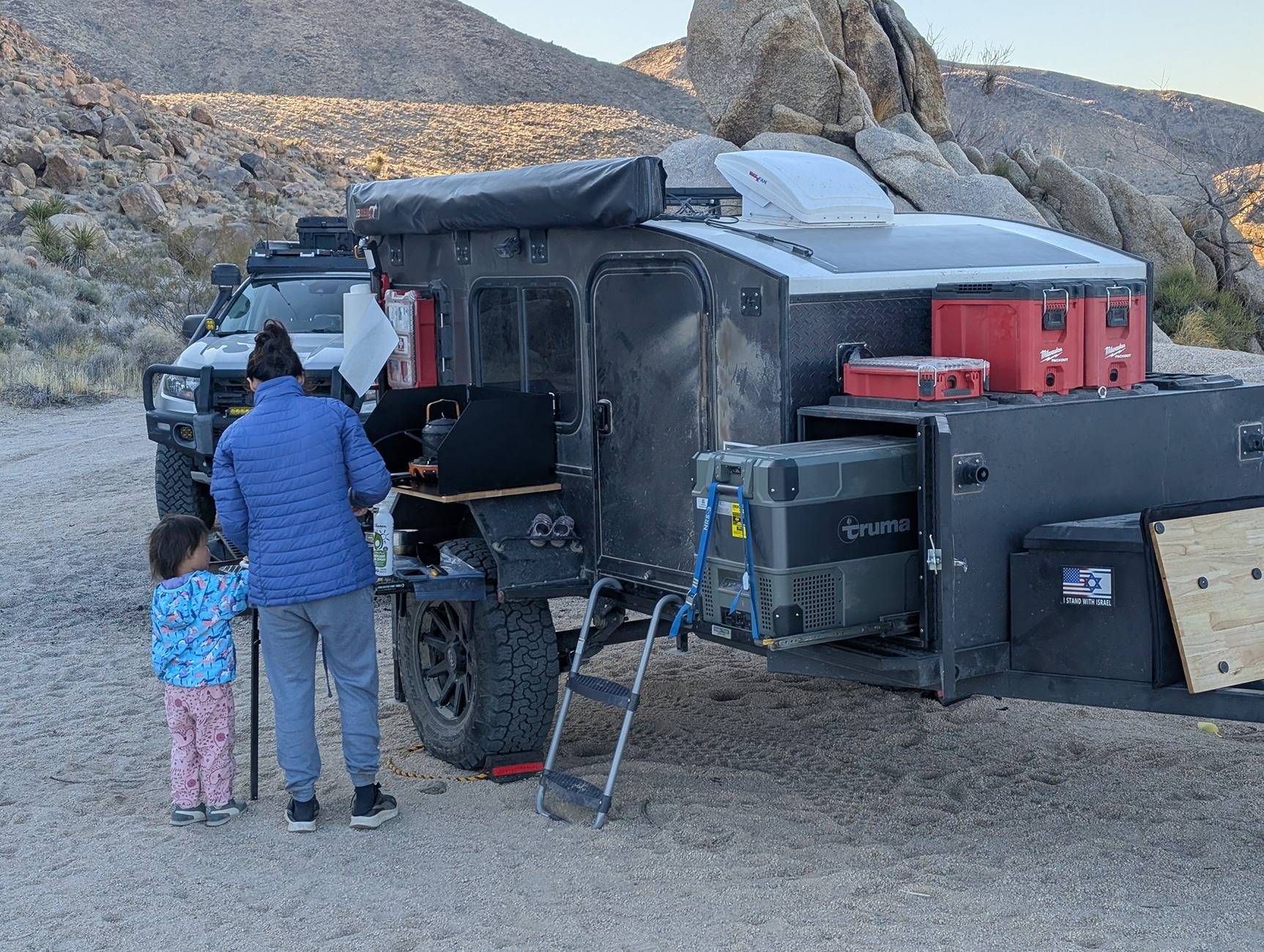

Well I bought the Mountune Radiator. Now I need to find a shop to install it. Mountune is about 45 minutes from me so hopefully shipping is quick. Total was $357 with free shipping and 10% off code.
To give additional feedback on my setup here are some contributing factors.
  • Fox 2.5 suspension set at roughly 1.5 inches above stock
  • 650lb coils up front - up from stock 550lb springs for the Fox 2.5
  • 33" Wildpeak mud terrains. I prefer KO2's but I got this set for free so I can't complain....although my truck complains. These tires are heavy!
  • SmartCap EVOa - first edition with roof rack
  • Roam 95L cases on top of cap.
  • UptopOverland roof rack above cab
  • Big ARB bumper
  • Warn Winch
  • 55l fridge in truck bed
  • Dual battery system with 100ah Renogy battery in truck bed
  • 1000 watt inverter, and accessories also in truck bed.
  • OME heavy duty leaf springs
  • Air Lift 5000 air bags
  • Hiker Trailer - Extreme Offroad with 33" all terrains. (approximately 3000lbs fully loaded.) Dry weight is 2200lbs
Sounds like right off the bat you are overloaded. Pickup only holds 6050lbs. Pickup stock is 4800 pounds, so 1250 cargo, 500 worth of family, 700, 300 tounge weight so you are only left with 400-300 of cargo. Winch, fridge, cap, extra battery, bumper, airbags, aftermarket springs, roof rack, all gotta be below 300 to 400 lbs. Plus anything else you carry in the truck. Then you tow, so you carry overweight and tow putting all the extra stress on the truck.
I have towed overweight before, 6500 on my truck and an 8000lb trailer. Well part of that weight was tounge weight. 500 miles in texas. All in the same state of course.
You might want to check on weights. Just a thought after seeing your setup. Cat scales can provide peace of mind, and be eye openers
