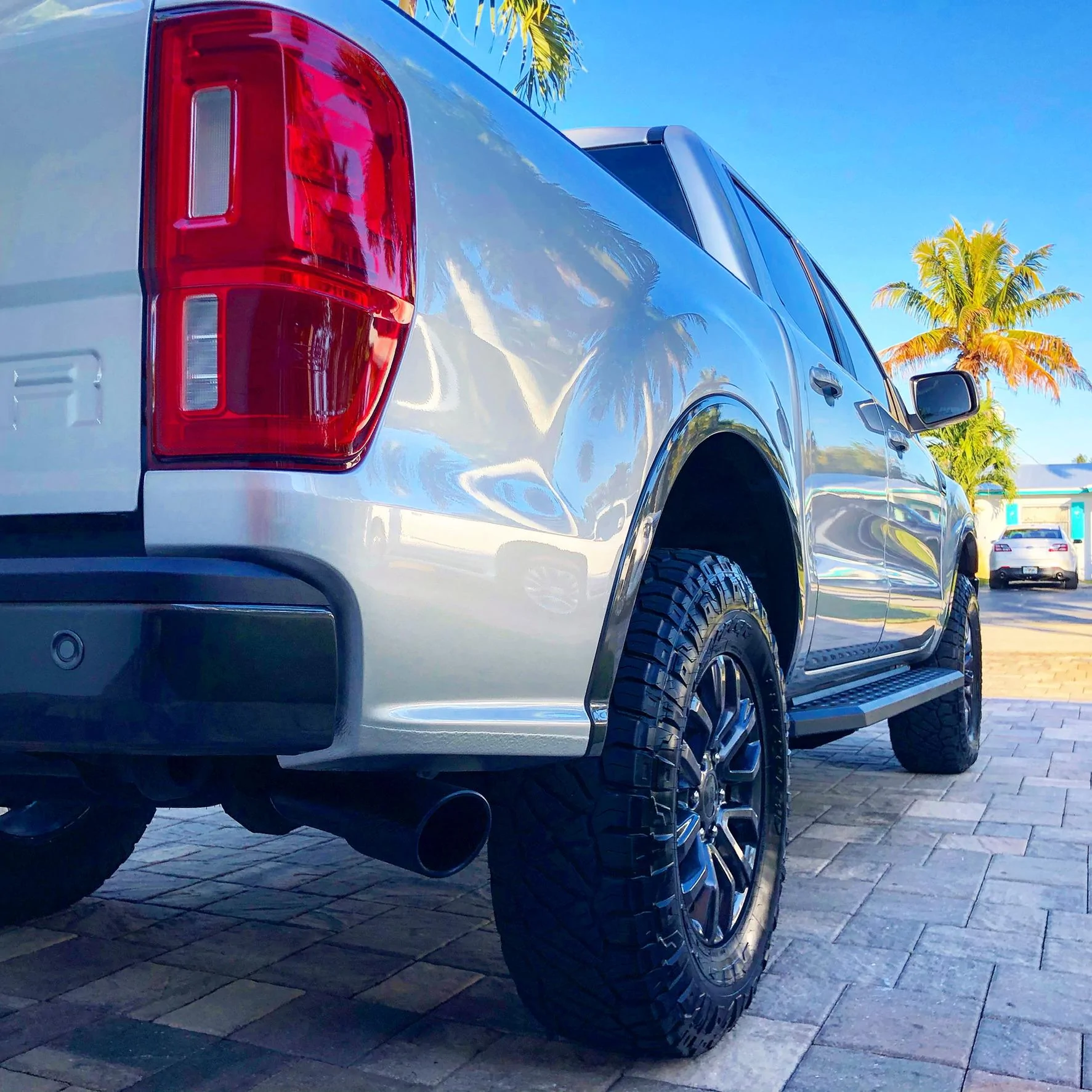

The Mbrp exhaust in my opinion is quiet. I put it on my truck you can’t hear it at cruising speeds and regular driving. When you get on it you hear it a little bit but not loud at all.

MBRP here, I like it. It’s not overly loud. Let’s be real, it’s a 4 cylinder truck. Let’s not highlight that. The MBRP is all you need and for the price, unbeatable imo.
