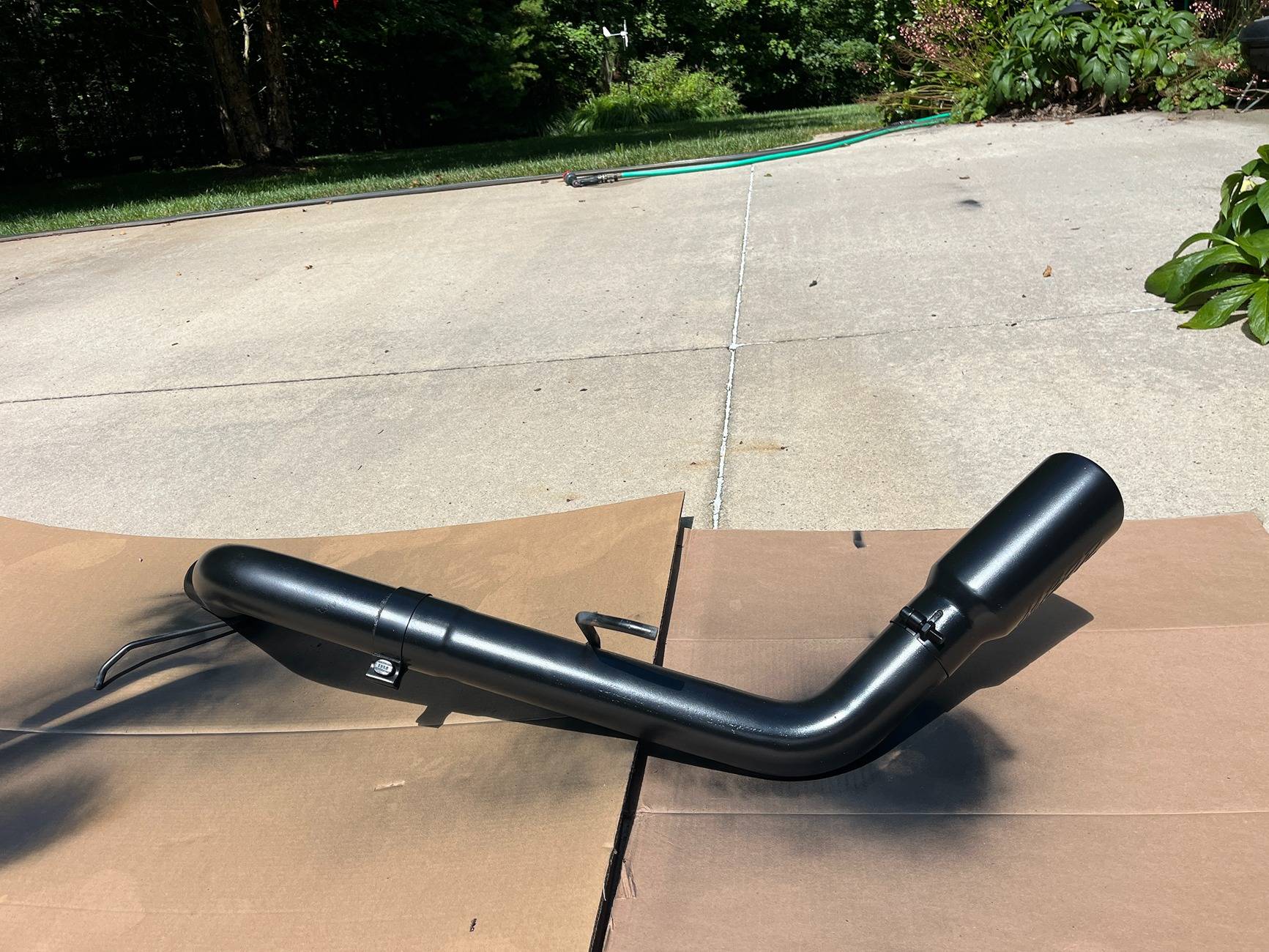

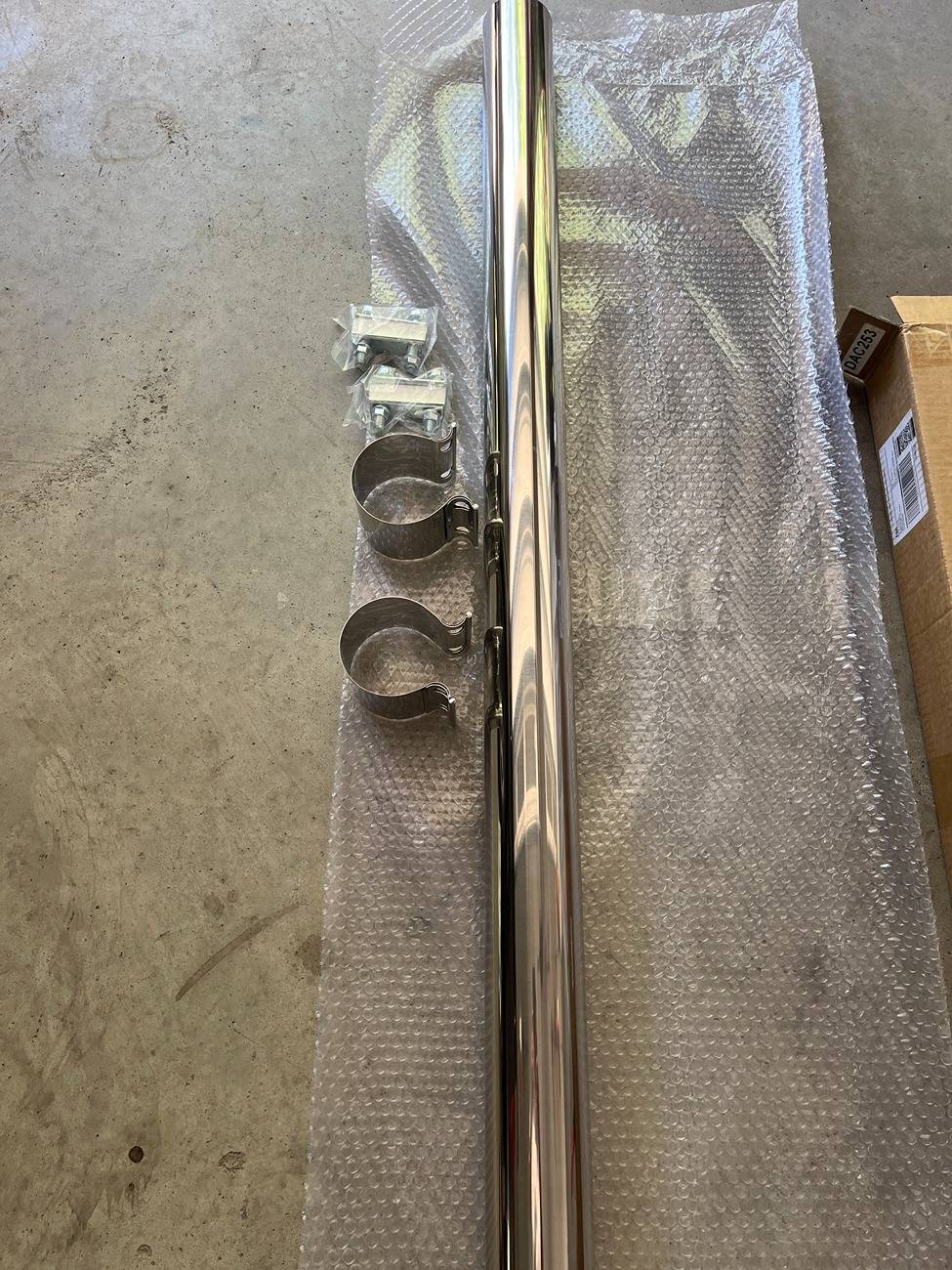

Making lemonade today...prepped the rear half and applied two coats of high temp satin black...the 48" SS 3" pipe and connectors arrive tomorrow ready to bypass the rotten MBRP muffler that was donated to the landfill yesterday...

Lol at landfill but your paint looks great!

But of course! You sound surprised lol... Right now, all I have is a self deleted muffler with exhaust coming out under the cab...I plan on replacing it with a straight pipe to the tailpipe out behind the rear tire...

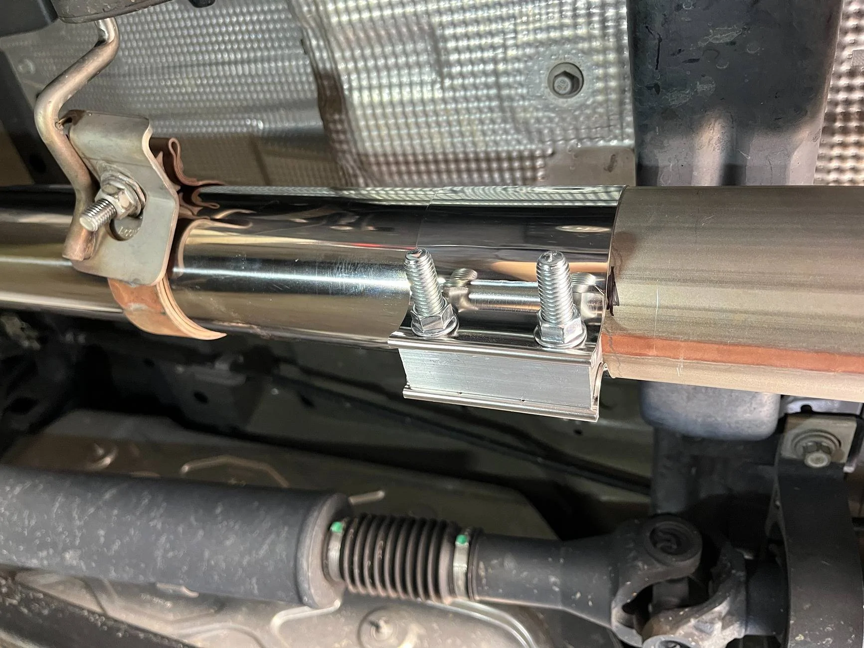

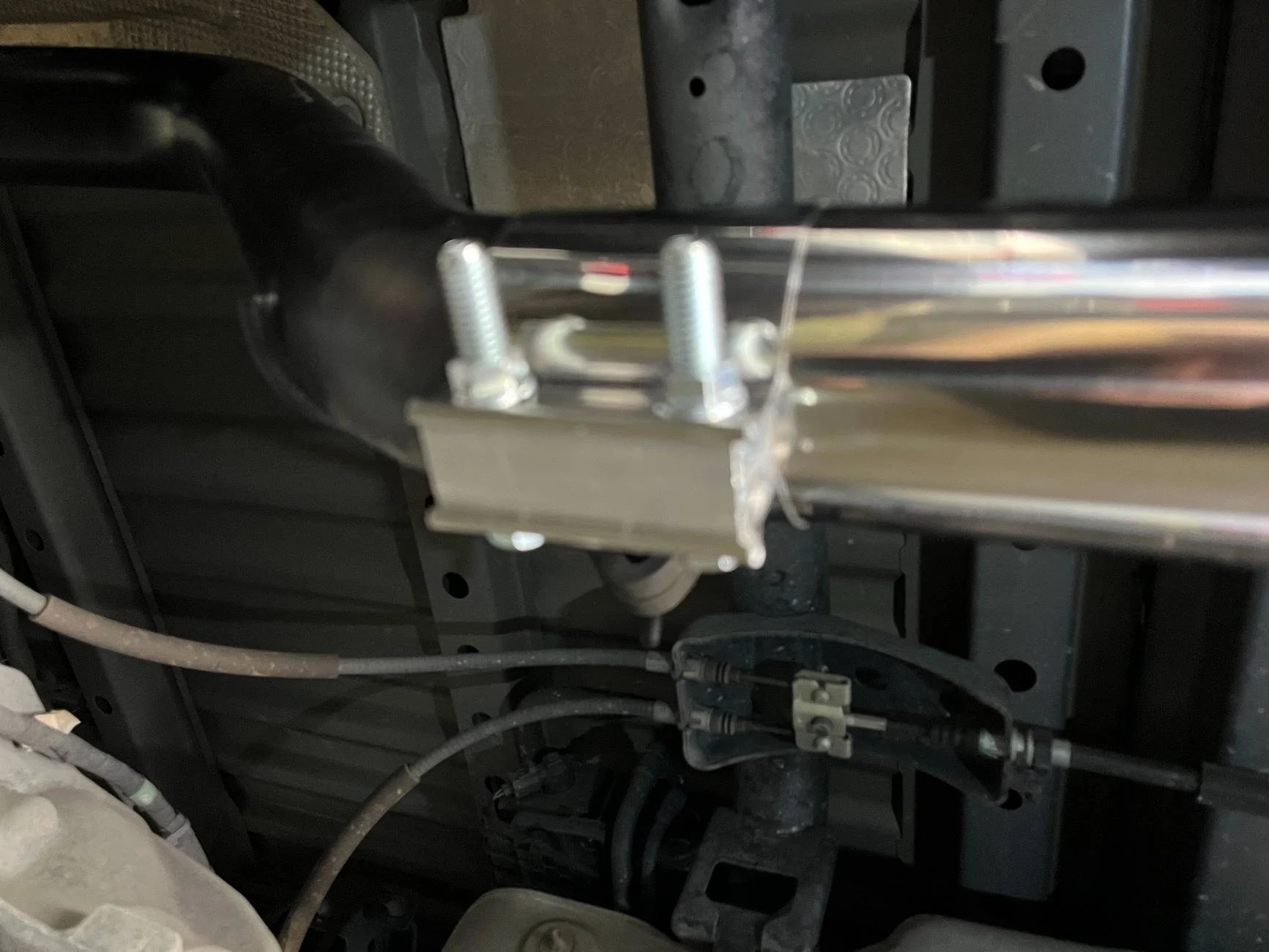

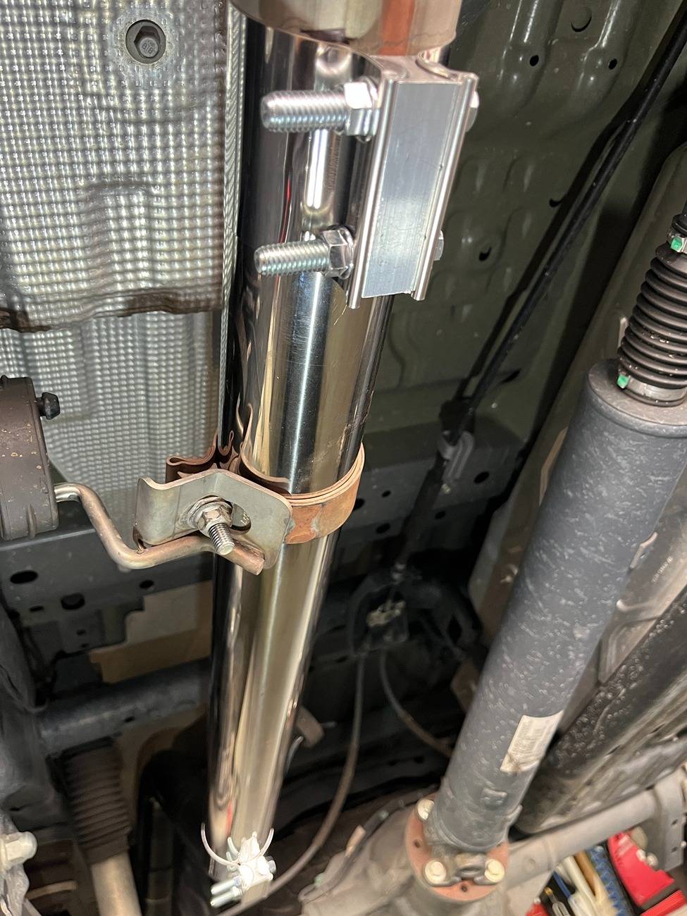

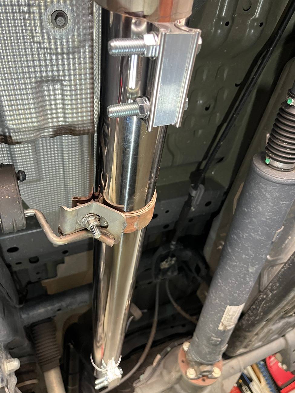

All done...a few pounds lighter and little more bling...?

I've never painted exhaust parts, what kind of prep did you have to do and paint/primer brand?

I didn't go crazy...just scrubbed it good with soapy water and brush...rinsed it off and let it dry in the sun...then rattle can Krylon high heat black two coats...thats it...
