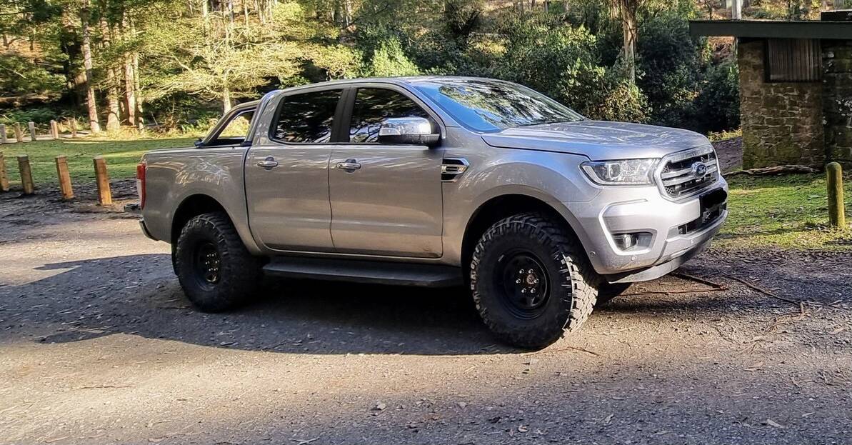

My gut says that squeezing in 34s that are 11+” wide, without issues, will be tough. Another member (@tentspast) has 285/75R16 (32.8” x 11.2” ~same as 285/70R17) tires. They look pretty darn cool but look how tight it is. It seems to be an Aussie Ranger but maybe he can provide some insight.

Yep the Aus Rangers have no crash bars and different front bumpers, fog light housings and wheel well liners I believe. My tyres fit fine without a lift but I think 34s would just touch the inside liner on full steering lock. I can double check clearances tomorrow for you. Good luck!
