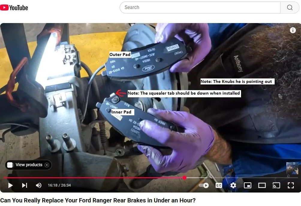

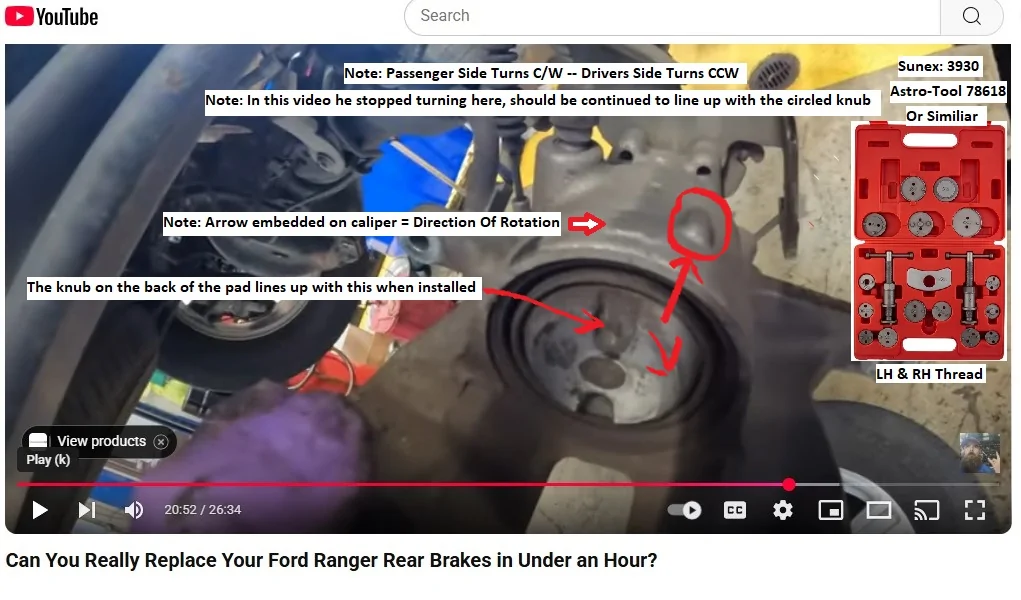

Possibles:
***Collapsed Brake Hose - not returning the fluid
Forced piston back in = Screwed in - and in proper position (resting)? There is an alignment mark on the caliper for this, and it provides proper positioning for the inner pad (nubs)
Brake pads in correct position (Inner & Outer)? - Squeal Tab on I/B Pad and on the bottom as they are LH & RH specific
Binding on the (sliders)
Park Brake (caliper) Lever sticking
When you release the parking brake - does the parking brake lever (caliper) release fully? compare it to the driver's side these are known to hang up

I cannot locate where I posted this - Quick Ref, so here it is again
The most important is that the (Inner Pad) knub sits in the recess of the piston and the squealer is (at the bottom) when installed.
Went out there and looked at it.
I swapped the pads inside/outside.
How I did not figure this on my own, I don't get.
Anyways
Thank you
Gonna swap em Saturday morning

Airline tech was correct.
I swapped the inner and outer pads.
Dammit. Wasted $150 I can't get back. So that sucks
Thank you to Airline Tech
