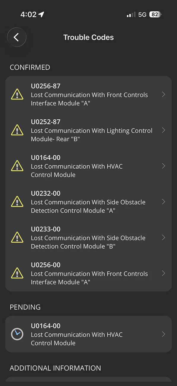

Sharing the error codes I found with my OBD scanner in the attached image.

Can you scan for any DTC codes and post them?

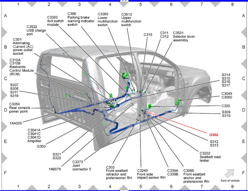

There is a ground located under the passenger seat (G302) that provides the ground for a couple of the center console switches. I would check that for being tight.

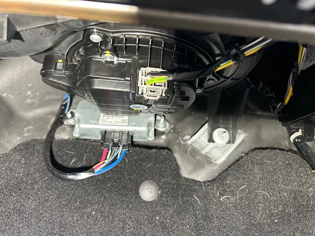

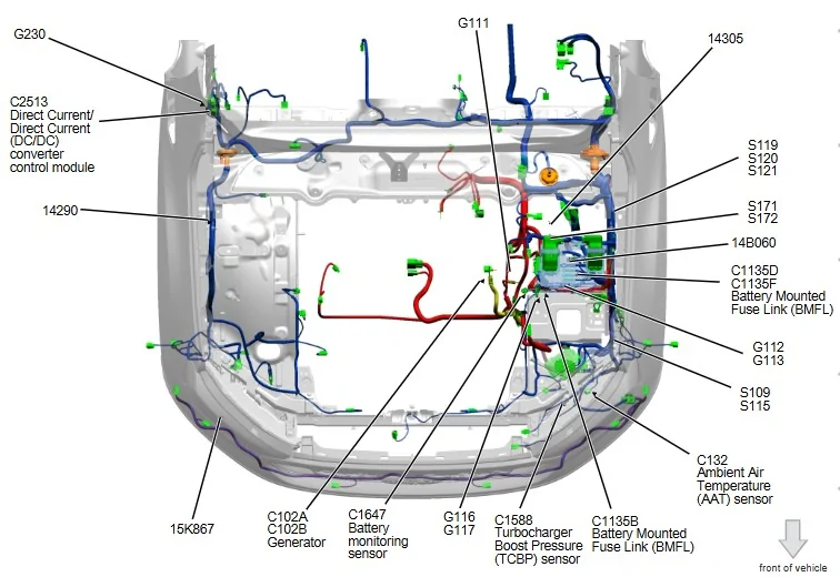

It's on the DCDC Convertor - Circuit - so bad connection on the Power or Ground side, Ground is the most likely - as the Ground Point - G230 is in the RF Fender area.
This is the tie in for all of your faults
If I were to T-Shoot this (I would Start here)
Reseat this connector - DCDC Convertor - under the blower motor
G230 - I do not have an actual pic - the diagrams are not clear; they never are for precise location - But it will be an (8-Gage) Wire - located around the fender
Check this connection for security and or damage

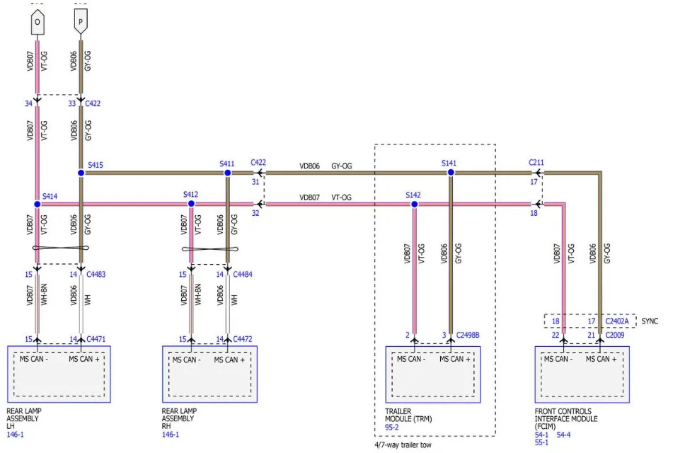

Ok for all those messages - its pointing to a MS-CAN bus issue, all of the fault codes are on that bus, FCIM - HVAC = FCIM, SODL & SODR (Blind Spot) - Lighting Module = Trailer Module (TRM)

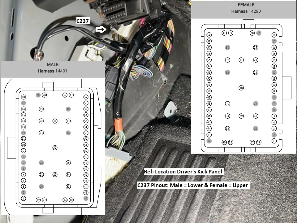

The Fault lies from C237 - going AFT (downstream of this connector)
C237 - Drivers Kick Panel

To understand the FCIM - it's always powered, however it takes can bus signal to turn it on (Ignition Switch Position (Run) or ISP-R, the can bus is dropping the signal
Also note the TRM and the Blind Spot Modules are also on the same circuit, so depending on where you tapped in with the canopy - it may be causing the issue (not secured connection) or pinched wire damage during remove and reinstall.

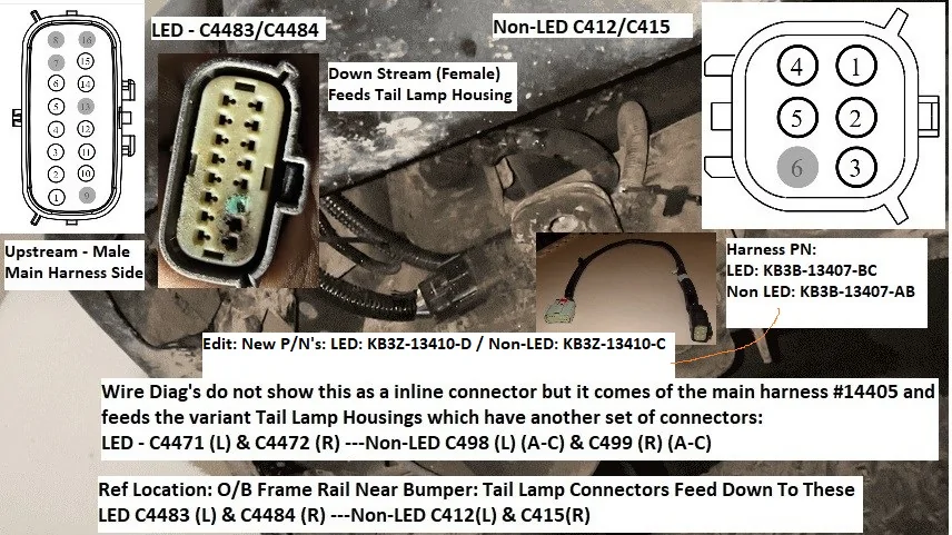

So, check the following connectors for security - Pull - Clean - Reseat (in-Order)
1. Your Canopy - Connections - possibly disconnect to isolate (if issue returns)
2. Both Taillight - Connectors - Check for moisture (under BLIS module and inside light assembly
3. C4483 / C4484 - This is the connection point that the taillamp harness connects to the main truck harness - both sides
4. C422 - LH Frame Rail
5. C237 - Drives side kick panel
My hunch, is that it's in your canopy wire circuit or one of the taillamp assemblies, plus check the wiring for the Trailer Connector as this feeds the TRM

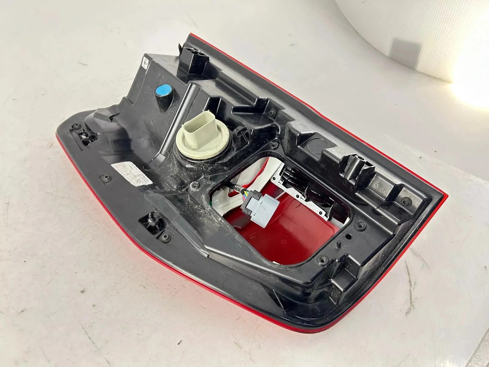

If you have moisture in the RR Taillight - That is the issue
Inside the light assembly is the internal wiring for the light assembly plus a connector for the Blind Spot Module (SODR) - Side Obstacle Detection (Right)
The connector is wet and creating a short across the circuits - affecting the MS-CAN bus, to isolate
Depending on if you can clear the codes and all the codes return - then disconnect the RR taillight and clear the codes and if only the RR taillight (BLIS) shows (as its disconnected) - confirms the RR light assembly is shorted out, more so the BLIS module
More Detail:
The internal connector for the SODR (BLIS) module has been exposed to moisture and is wet along with the module itself (this can short the circuit and or the module) as well as the internal wiring for the lights themselves.
I suspect - the tie in - (if they disconnected) the external connector and stored the assembly (as logically they would have stored it - back side down) all the water in the assembly would have drowned the module and connector in a pool of water.
This is why is showed up after the body work (Theory-Only)

The MS-CAN bus wiring runs into connector (C422) and feeds the BLIS modules on Pins 33 & 34
Then after the BLIS modules the MS-CAN bus runs back through connector (C422) on Pins 31 & 32 and then runs to the TRM and then the FCIM (via wiring splices S411 and S412) in the rear harness.
The Can Bus has - 2 Ends (The GWM and the FCIM) - The FCIM is the terminating end of the circuit.
So, everything on the (Circuit Path) from the BLIS modules back up through C422 is being affected and with moisture found in the RR Taillight assembly - points directly at that being the root cause but can still be a connection issue at C422 or C4483/C4484 or either taillight connector or BLIS connector or the wiring splice points where the 2 circuit paths join together.
For me the moisture is the smoking gun here
More Detail:
To give an understanding of what is happening
And for Reference - The Rear Body Harness (Harness # 144045) is the harness aft (downstream) of the C422 connector - this is where the splice points S411 & S412 are located to feed back up through the C422 connector to complete the circuit to the TRM and FCIM modules, specific locations of the splices unknown as the diagrams are not that clear - it's a matter of cut the harness wrap open and find them again this is just for reference, but still a circuit issue possibility
Reason - Moisture can wick up the wires into connectors or splices from another source
I am surprised this has been to various shops and no one understands the circuit and how it operates - you are not the first one to experience issues here for this circuit and once you understand the circuit run - it's clear to see the issue
The throw-off is understanding that the circuit - routes back to the BLIS modules and then back up - is the KEY factor.
Thank you for such a thorough write up. Just to confirm, the RR tail light is the one that has moisture, but it's NOT the one with the wire tap for the canopy.
To make sure I'm understanding what you're saying, your hunch is that when my right rear tail light was removed, it was probably set lens side up, which would have caused any moisture that was in it to pool around the BLIS module and its connector. Because the MS-CAN bus routes through the BLIS modules and then loops back forward through C422 to reach the TRM and FCIM, a short at that point would cascade upstream and take out everything on the circuit (which matches all six of my U-codes). Am I understanding that right?
airline tech
Aug 24, 2022
4,464
8,537
Midwest - KS
Aircraft Tech
yes
O & P are the feeds coming from C237 (from the GWM)
S414 & S415 provide the split to each taillight
S411 & S412 provide the split to reroute the circuit back through C422
So, everything aft of C422 is being affected the circuit runs down and then back up.
This points to anything on the BLIS feed is taking down the rest of the circuit, this means your canopy tie in or one of the light assemblies, if you have verified moisture in the light assembly that is prime suspect but however the canopy tie in at the LF light is also suspect as both BLIS modules are reporting the error.
So, to isolate remove the LR canopy tie in (first) - if issue remains then it's the RR light assembly
Easy test:
Disconnect the right taillight connectors, reset any DTCs and test to see if they come back with the light still disconnected. You will get DTCs concerning the right Bliss and taillight fault, but see if the other concerns go away.
