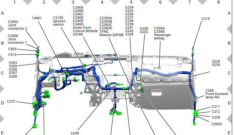

Check Ground, - G200 and G202 for security, there are some splice points upstream of this, but this is an easy spot to check.
Plus- Define dash settings would reset, are you talking about layout of the left display.
Sync - You are losing all radio presets, climate settings etc - Correct.
Thanks man! I’ll give it my best shot!
