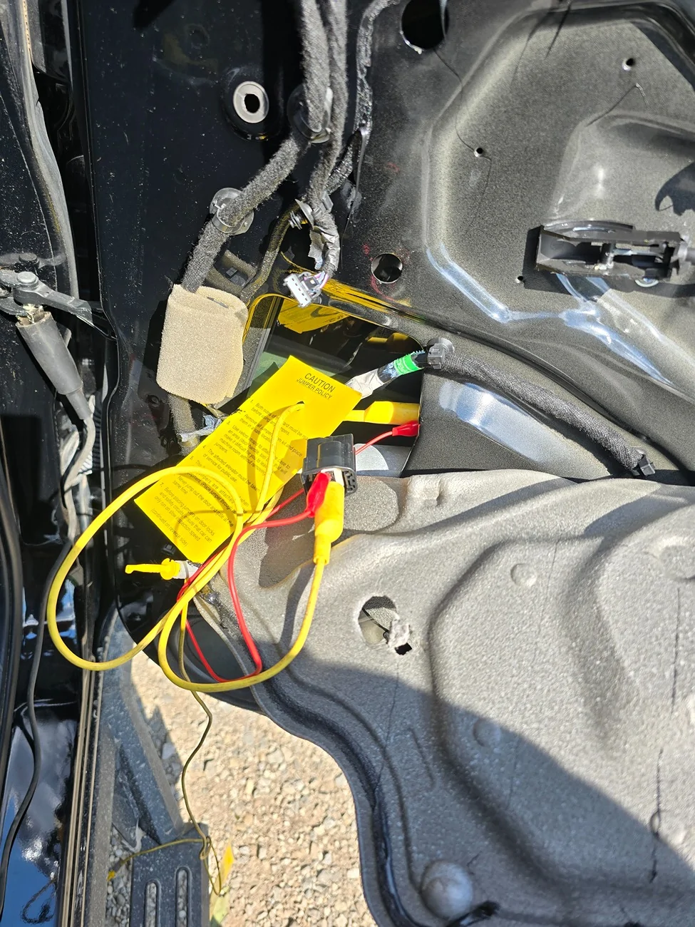

Unwired passenger window and checked voltages
12v to roll the window up.
0v across plug to roll it down but I do have positive power to the window. Just no ground with the polarity switch. (Checked with test light and multimeter)

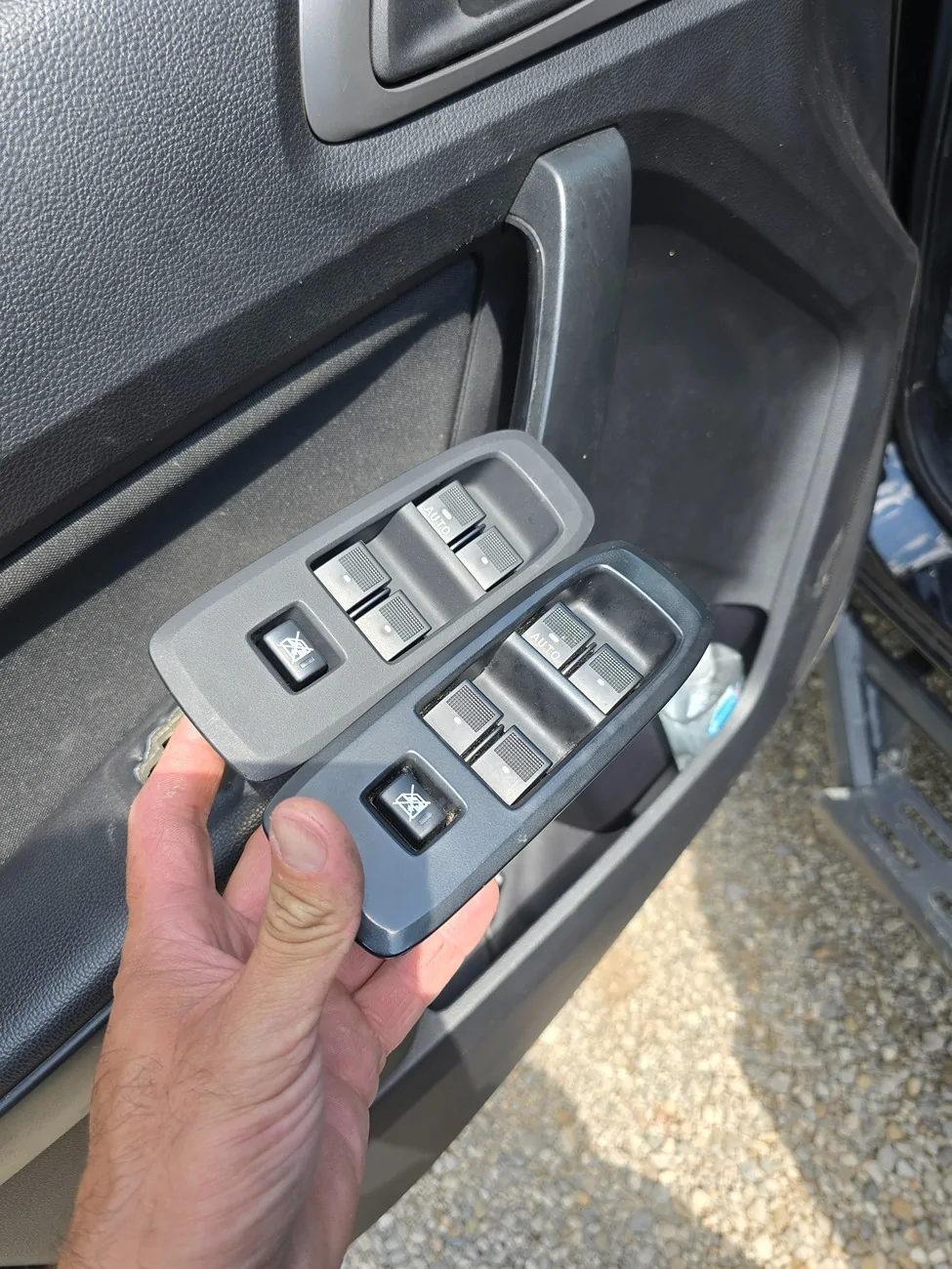

Swapped the passenger switch with the rear window switch (interchangable) and still no passenger window roll down but rear window worked with that switch
I have crossed the wires with jumpers to the window and I can roll the window down by pushing the up button
Upon posting my previous findings on 2019+ ranger page on Facebook I was instructed to throw a brand new OEM driver window switch in it which didn't solve anything. 120 dollars down the drain.

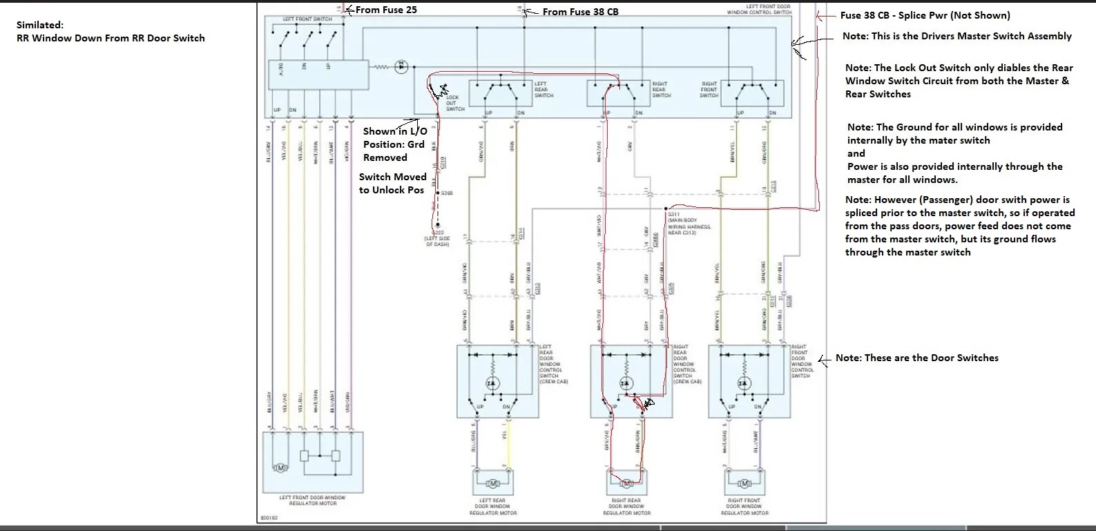

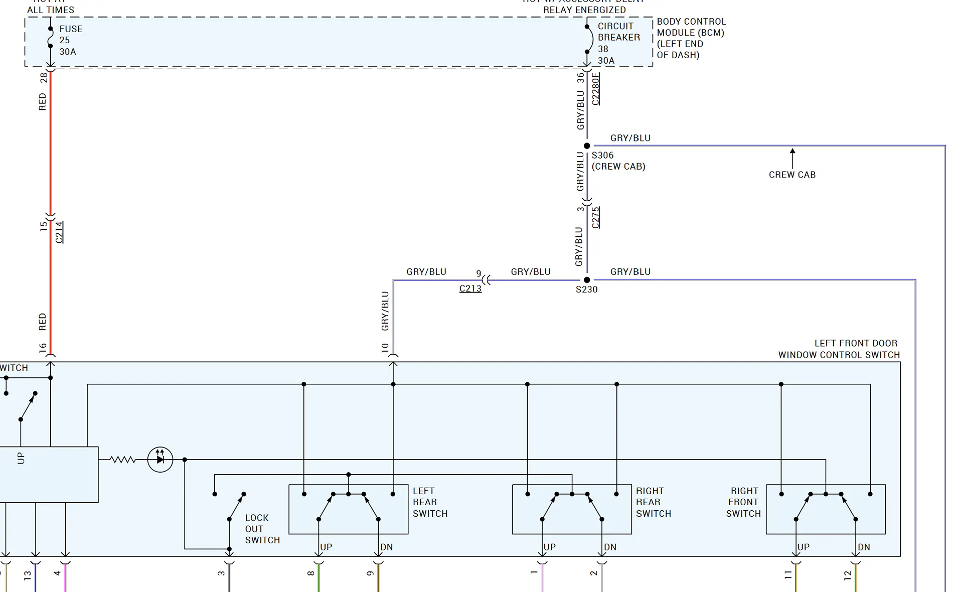

This may help[ you visualize the circuit - just use the RF in place of RR
airline tech
Aug 24, 2022
4,499
8,592
Midwest - KS
Aircraft Tech

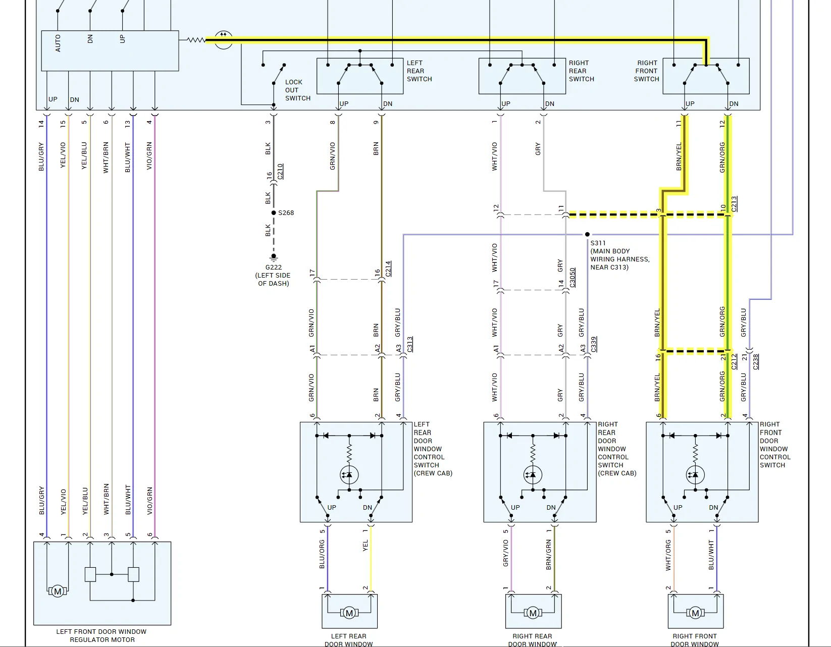

Lets think about this
If the Brown & Yellow wire was bad - The window would not move as with going up the (Brown/Yellow) is power from the master switch - The RF window switch has its own power - so 2 power sources can move the window.
Here is a better view
Note: Switches are depicted (At Rest - Position)
Example: From the master switch -For (UP) Power down Pin 11 and returns Pin 12
Through the (RF Switch and Motor)
Now if using the RF Switch (It bypasses the power from the master and uses its own power feed) but the motor is still using the (at rest) master switch ground circuit (either pin 11 or 12)

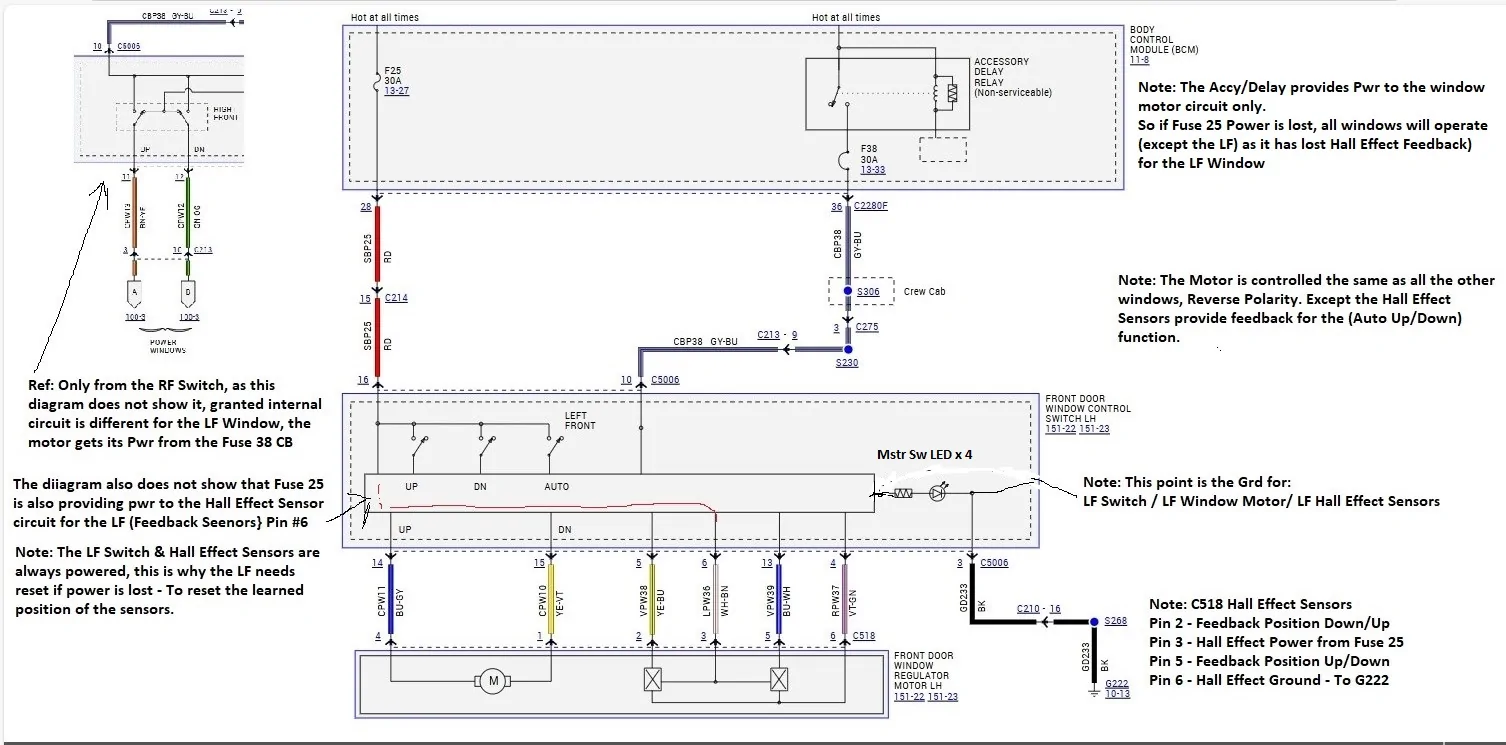

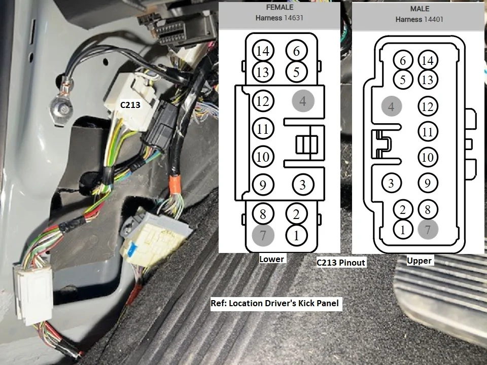

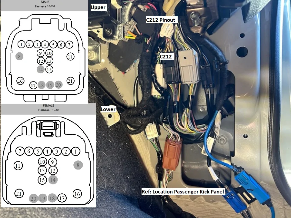

I am thinking (High Resistance) in the Green / Orange wire
