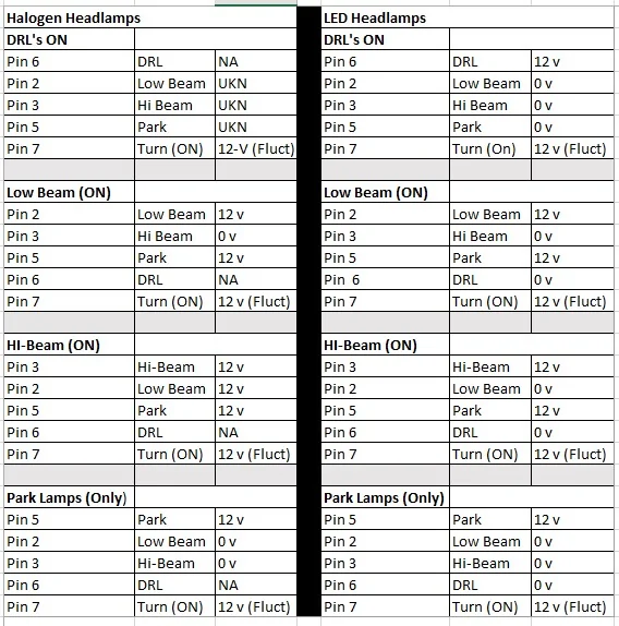

Not sure if your ROW Ranger has the same main connector or if different, if the same as the US Version - there is some valuable information on pinouts here.
Somewhere on this forum or Google Search - I have seen a ROW Ranger Plug that was pinned differently - most ROWs are for various connectors and it was posted on what wires they moved to match.
You can view the link below or use the table of pinouts for both US Version Assemblies as a guide
Aftermarket Headlights - Wiring & Issues (Group Help) | 2019+ Ford Ranger and Raptor Forum (5th Generation) - Ranger5G.com
Note: US Version Rangers all have the same main harness connector (All pinned the same) but at the headlight assemblies the (Internal Pinouts - Change) between Halo & LED Assemblies
Thanks. I guess I'll have to figure out the pins myself with a multimeter.

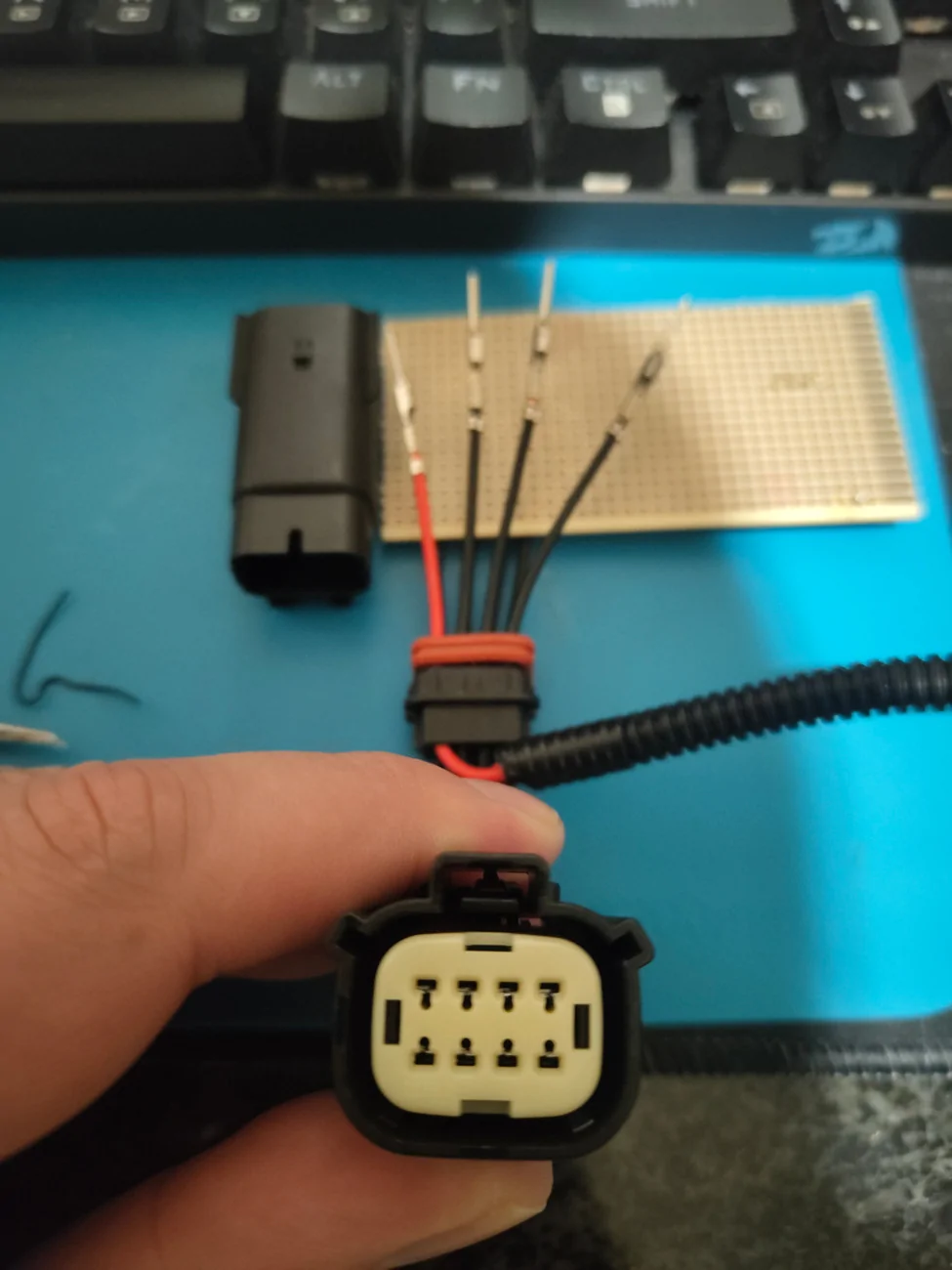

I can confirm that the harness connector pigtail that I purchased, is pinned on pin 1 for GND and pin 4 for the high-beam, which is not matching with the wiring diagram. If I'm reading the pinout correctly, it is the female connector, the one that connects to the "headlight" connector that goes with a short run into the headlight itself?
I definitely think that there's a difference between the US and ROW when it comes to the headlight connector.
Will have to do resistance tests by removing/reinstalling the bulbs and figure which pin goes to which.

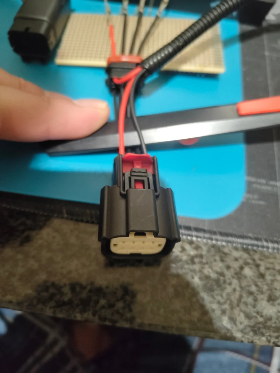

I partially depinned the pigtail, for some reference. One cannot blindly assume the pinout is the same.
Attached is two photos. The top black and red wire is pin 1 and 4, according to the wiring pinout.
