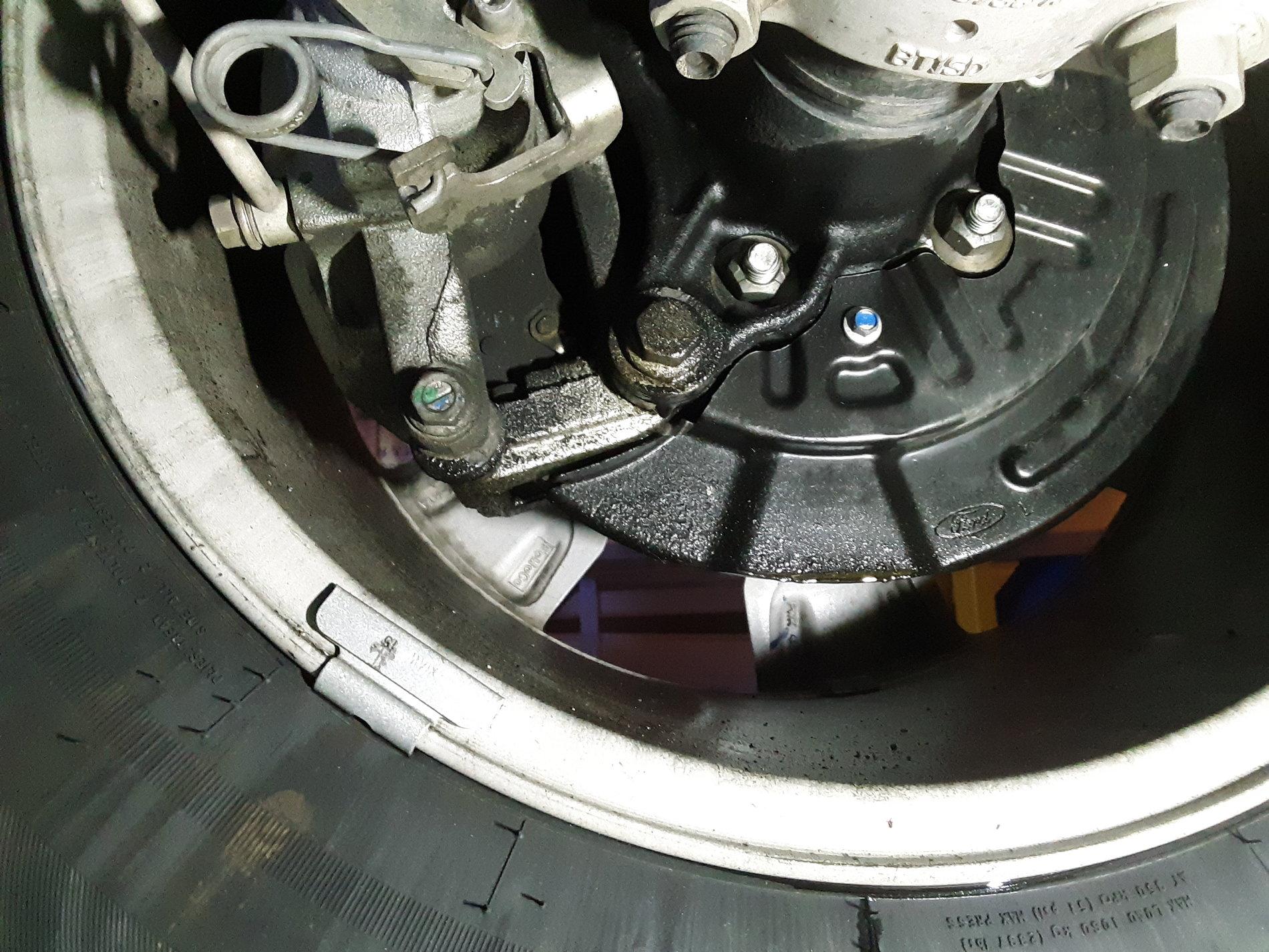

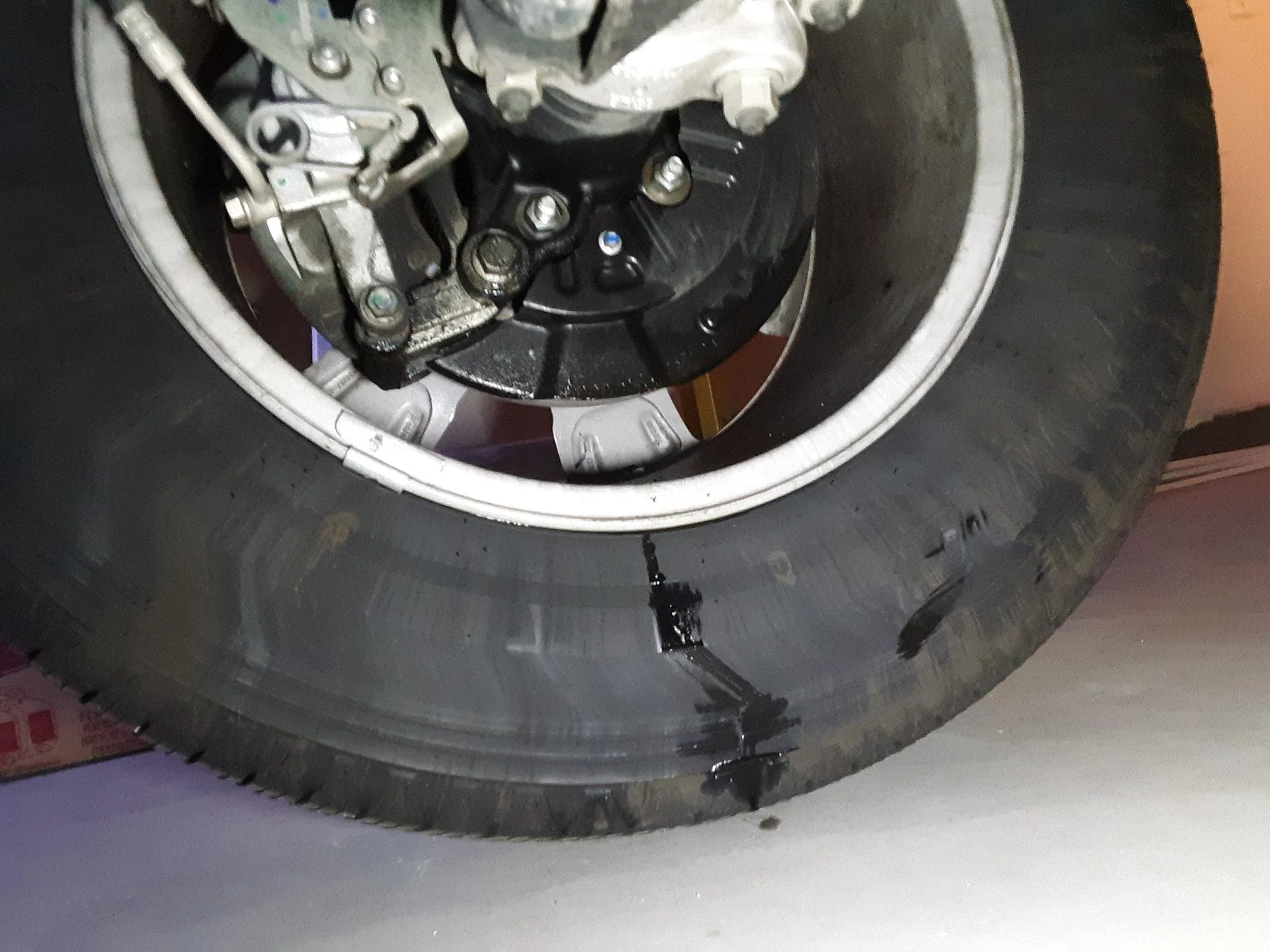

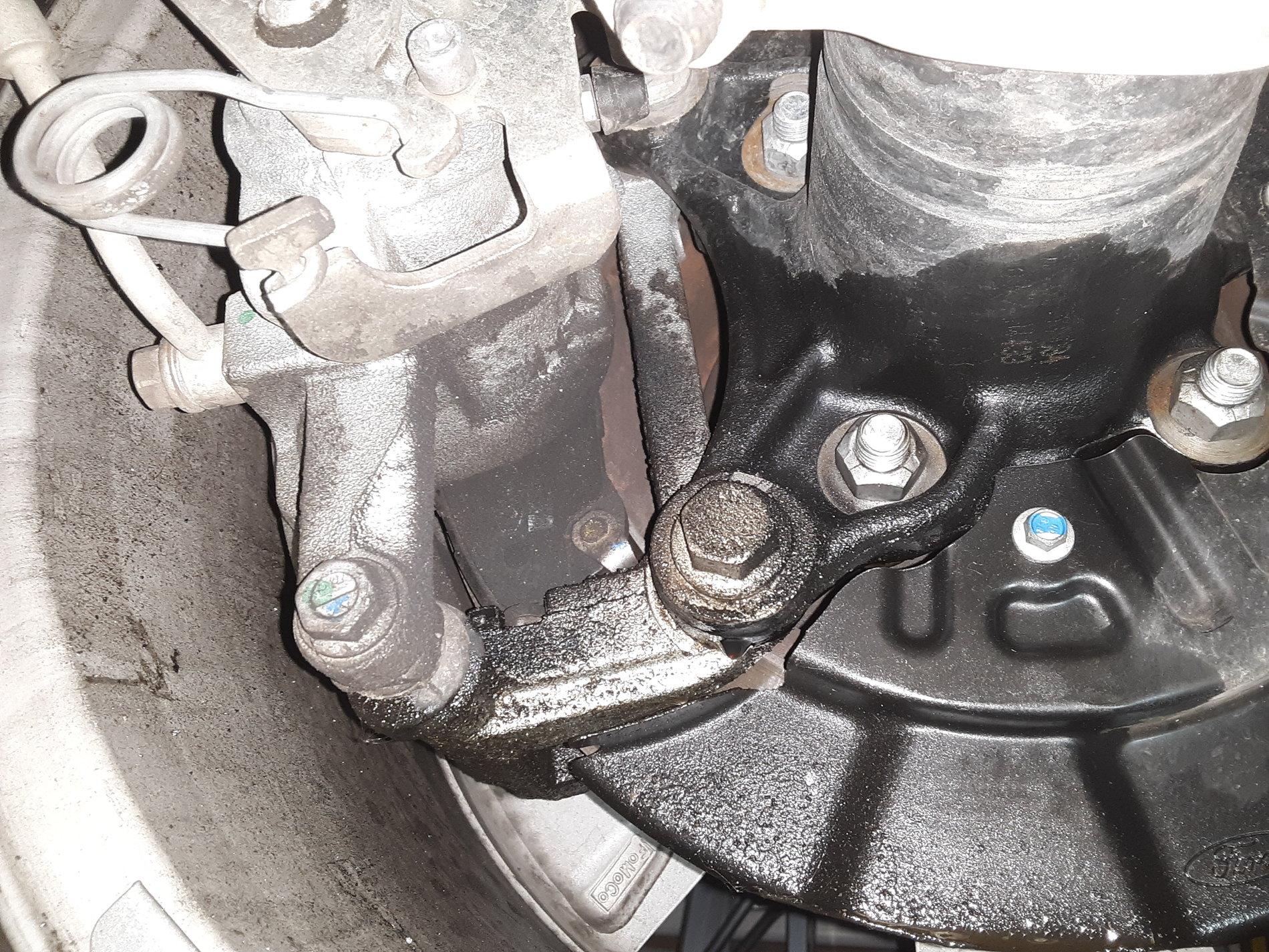

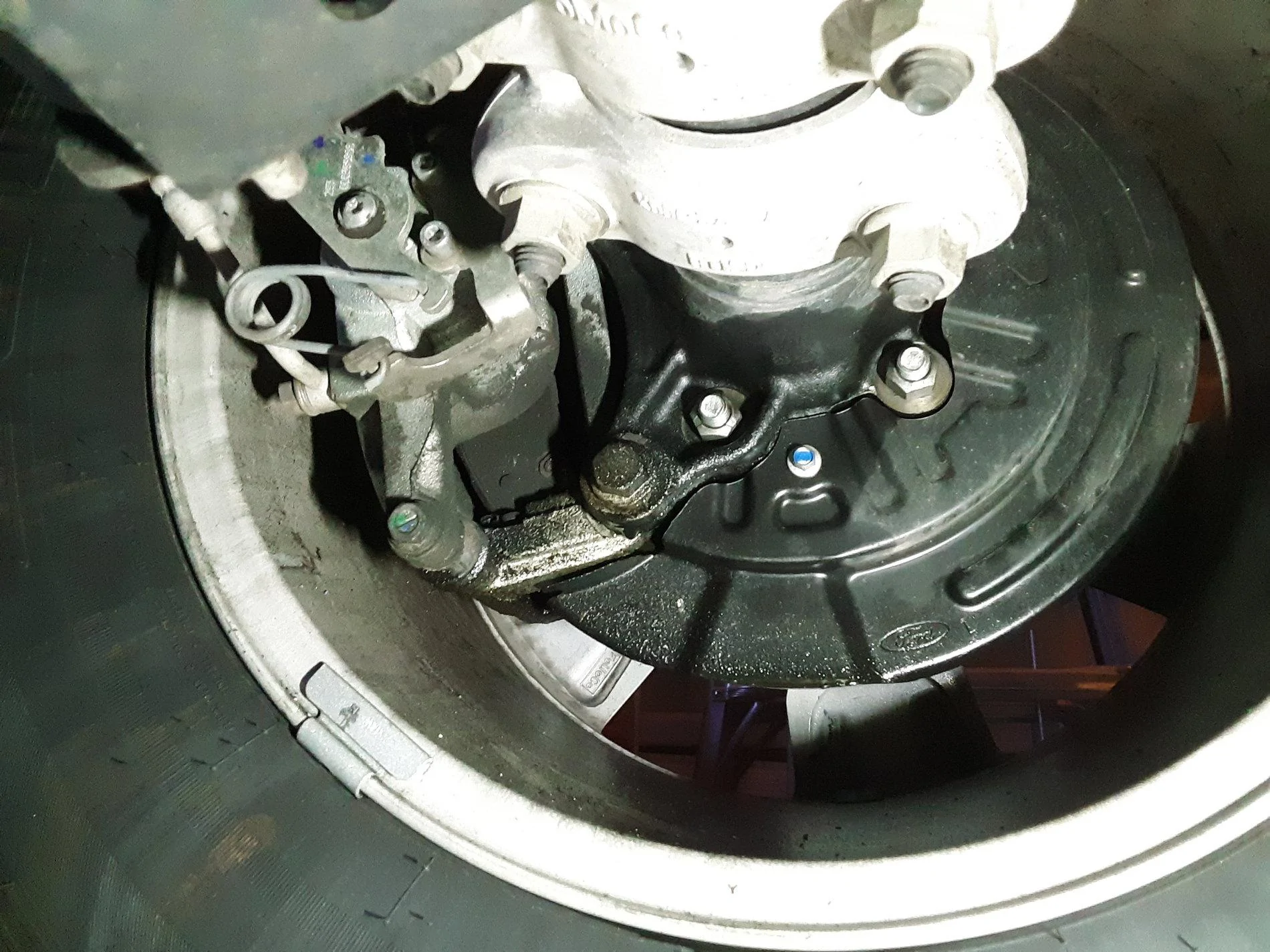

new to the group, first post. i have a drivers side rear axle leak, and it is considerable for only having 7k on the clock. live in so cal not going out right now to have the issue looked at, not worth it, retired and not going anywhere on mandatory lock down here.
towing 6x12 trailer at sustained freeway speed i noticed what i am going to call a howl in the rear end, backing off, it would settle down, like gear oil starving the ring gear splash system, finding this leak, it makes perfect sense. when truck was in for first service, explained it had a ring gear howl, obviously they ignored me or bothered to do the usual overall inspection check of the truck at that time as there are old dried into the tire rubber leaving staining oil sling marks from this going on for a long time. interested on any info on this issue. thnx

From the looks of it it looks like the axle seal itself went with that oil leak. What you might ask? Most likely the bearing for the axle shaft. Something you can do is call your local Ford dealer and see if they are participating in the option where they come out and pick the vehicle up from you and get it fixed and bring it back to you. It's more than obvious that this is under warranty. Thought you might like the information.

Gary, there is a member on here (4thfavor) I think. Im sure he could give you info on this as he has had a similar issue. I think the axles had excessive run out. Bret

thanks, will check out the advise was looking around under the truck out of interest and found the leak then became a member here to see if there were issues and it looks like there are, thanks for the input truck was ordered/delivered in casron city nevada was in so cal home so i will check on the dealers here and their policy also mentioned here pick up and drop off repairs. really surprised on this issue otherwise really love the truck.

Ring and pinion howl typically show up after 15-20 minutes of highway driving when they get good and hot. Many techs will do a quick drive around the block and kick it loose with a NPF (no problem found). Take it in and don't take no for an answer. Take the tech or service manager on a road test. If they won't do anything call Ford and open a case. I'd push for a complete new rear end assembly.

thanks on that you are spot on as to how it shows up when i was moving things out of pahrump nevada to the carson valley area i would go thought goldfield a lons slow climb then flat open past on a high desert plain opening it up there to 60-65 the how began which i know is oil starvation surface to surface contact letting off it lets off with the oil having time to re-pool in the pumpkin. i am going ot take that tack with the dealer as to me it should be replaced with the how and oil loss the ring gear at the least is surface burnt and most likely lost its proper temper and wont go the miles it should overall because of this issue, leaking seal lowered the oil level and towing /moving things i know damage has been done, shortening its life overall. thanks for the info on contacting ford opening a file if the dealer thumbs their nose at me. was not aware of that avenue. if there are real problems with the axles the sub is aware of and making the factory are of i think if thumbed down by the dealer i have a real case with them. thanks again on the input. i know the carson city dealer dropped the ball not seeing this when i told them of the howling issue. hopefully while i am here in kalifornia's riverside county for a few months finishing up things here i can find a dealer willing to step up and do the right thing.
