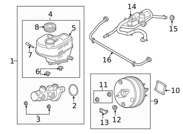

Item # 13 is the sensor that is triggering the code, for Open Circuit, check connector and wiring.
It measures vacuum in the booster.

Item 13 is a sensor and not a valve correct? The revised Demco kit has you hook up essentially a T in place of #13 that relocates #13 but the other side of the T goes to the Demco vacuum pump.
Prior to putting in the revised T at bottom of booster - Demco vacuum pump was T-d into booster by splicing into #14 and we got plenty of low vacuum related codes and faults - complete with brakes going hard while driving for long highway stretches without brake application. I replaced the entire #14 assembly with a new one and installed the new T at the bottom - effectively relocating #13. Truck was fine for probably 3k miles (at 12k presently) until this recent issue.

Yes, Item #13 is listed as a sensor and #14 is a Vacuum Tube Assy, If you can put the system back to original factory and see if problem goes away, that way you can eliminate the Demco add on vs actual issue on the truck side.
As it may be the Demco add on causing the sensor to read inaccurately and or bleeding off when it's not commanded to do so. I am unfamiliar with how that add on works, but since you relocated the sensor check and ensure the wiring is intact and not touching a point anywhere where it can vibrate and chafe against any part, this may be the issue being that's it is intermittent, plus check and ensure that the sensor is secure as if it is vibrating around the connector is also and may be causing the connector to move, thus lose connection.

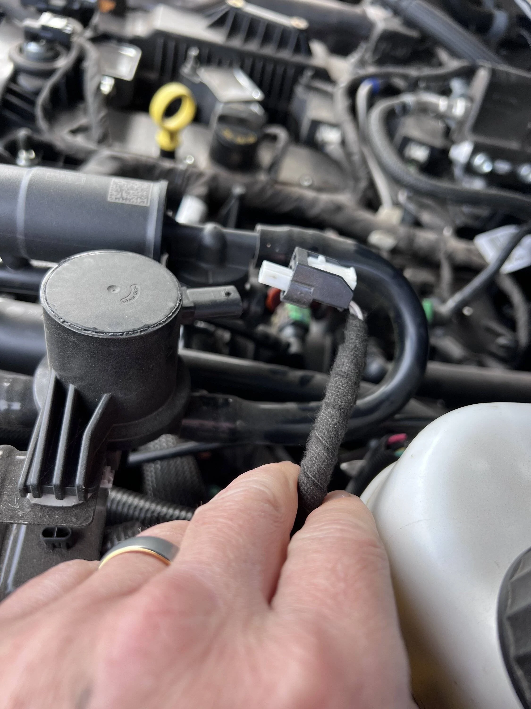

I had a moment where I thought I’d be okay enough to take a peak under the hood…mostly because I fortunately installed hood lift struts about 2 months ago. Without lift struts, doubt I’d be able to lift the hood and the prop rod right now.
Anyway, the relocated vacuum sensor was properly connected. No signs of wire damage and all joints in tubing appeared as they should. Then I began to wonder again just what the heck an Aspirator control valve is and where it would be located. And then I saw it…a connector dangling loose from one of the components in the #14 assembly pictured. Reconnected, cleared codes and checked codes again as the wife was driving.
So far code has not come back…but only a couple drive cycles since. as the stiff pedal in reverse thing was totally random and infrequent, not quite going to call victory on that just yet.
