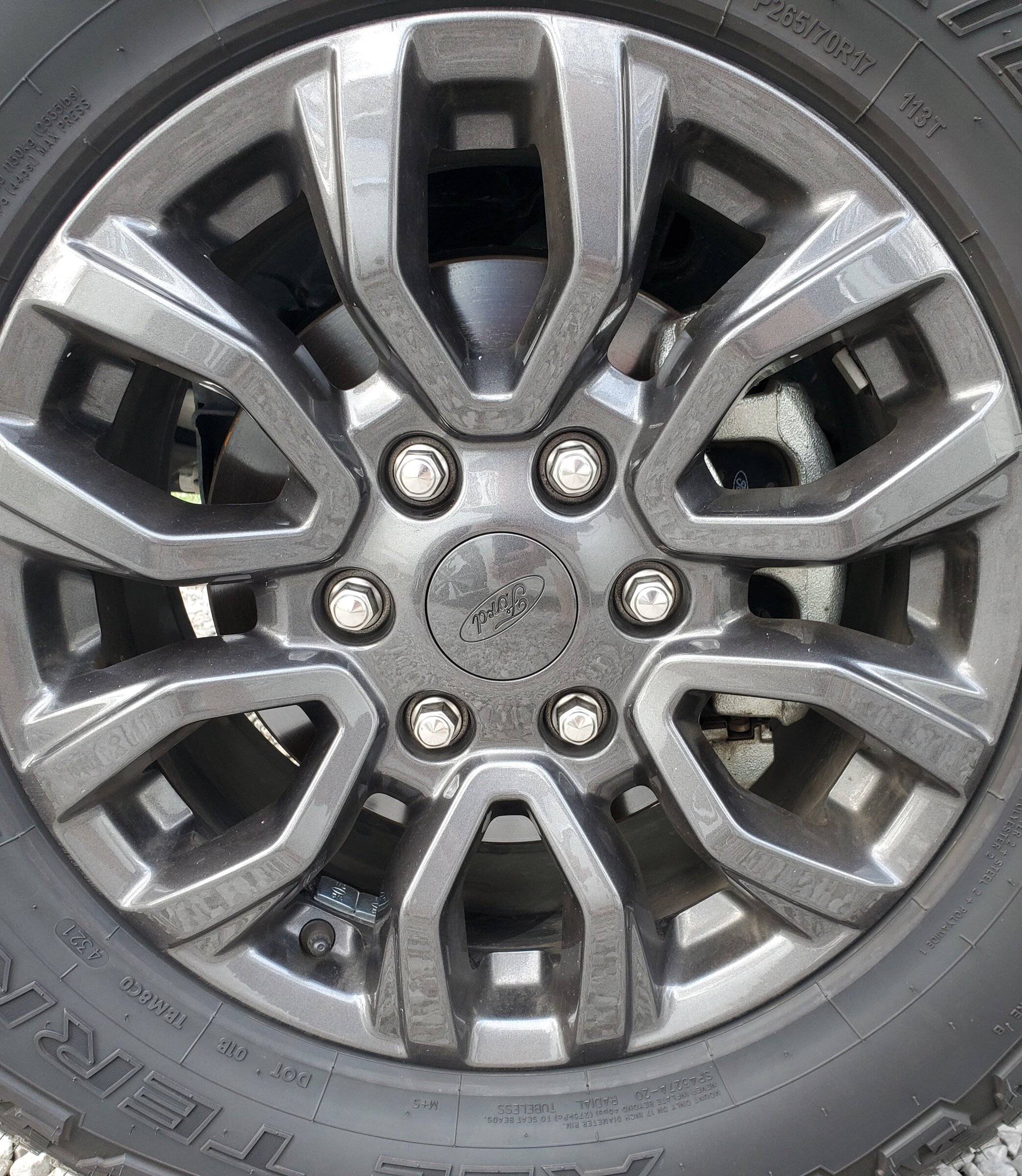

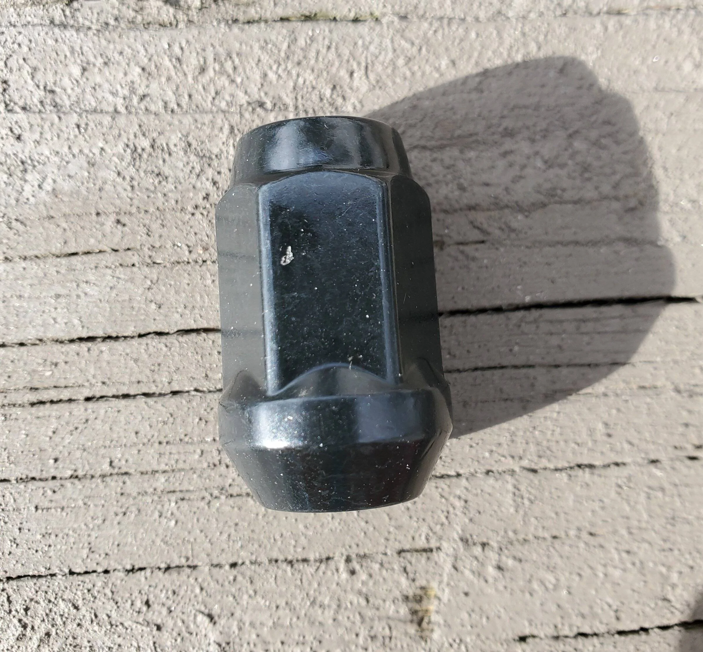

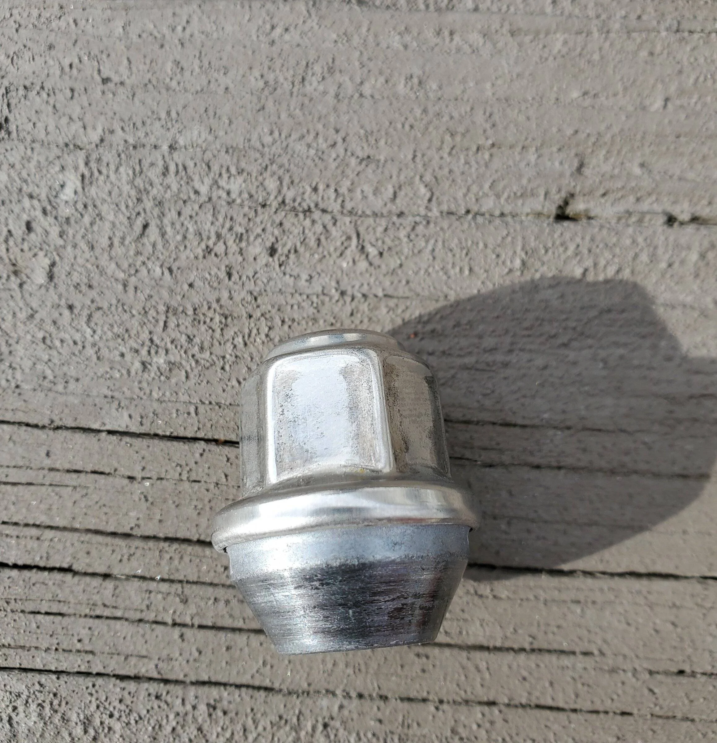

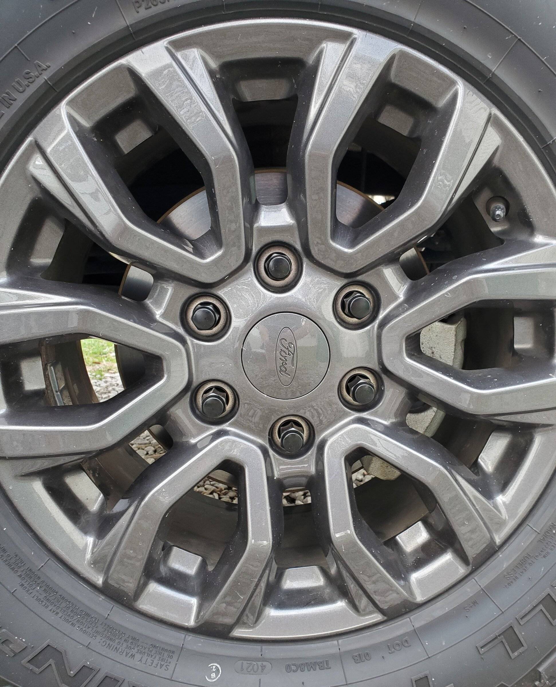

Finally got around to installing my new one piece lugnuts. The Ford 2 piece ones can be a real problem taking off when they swell. I work in the automotive repair area and deal with this all the time. Same thing happens with dodge products. Whoever thought 2 piece lugnuts was a good idea!
I bought my new ones from Amazon. Same cone degree and surface area. Everything torqued back up to zpec. Will drive about 50 miles and check the torque again. I think the black looks much better on the factory wheels.

do these fit a 2021 Ford Ranger Lariat with the TREMOR package?? here is the wheel Part No: M1007KRGR1785OR

Not sure if they will fit. Check the degrees of the cone. I believe it is a 60° angle.
Mine is a 2019 XLT and these fit with no problem.

thanks for the info.....comparing the info from Ford Performance that sells the black version of their 2 piece lug nuts for $150 for a 24 pack it seems the ones you listed on Amazon will fit with the 2021 Ranger Lariat Tremor wheel even though Amazon says it won't fit on their fitment guide......I just ordered it and with Amazon prime it'll arrive on Tuesday so I'll keep my fingers crossed....

@Sammy , @Jackpot Tremor and others that have bought these, how are they working out for you?
So far no problems with them. They torqued to spec without any issues and have no loosened with over a couple hundred miles. I live on a gravel road and with the constant motions, no problem.

Any aftermarket lugs for stock wheels make sure the seat is 60 degrees or they won't fit properly or safely.
