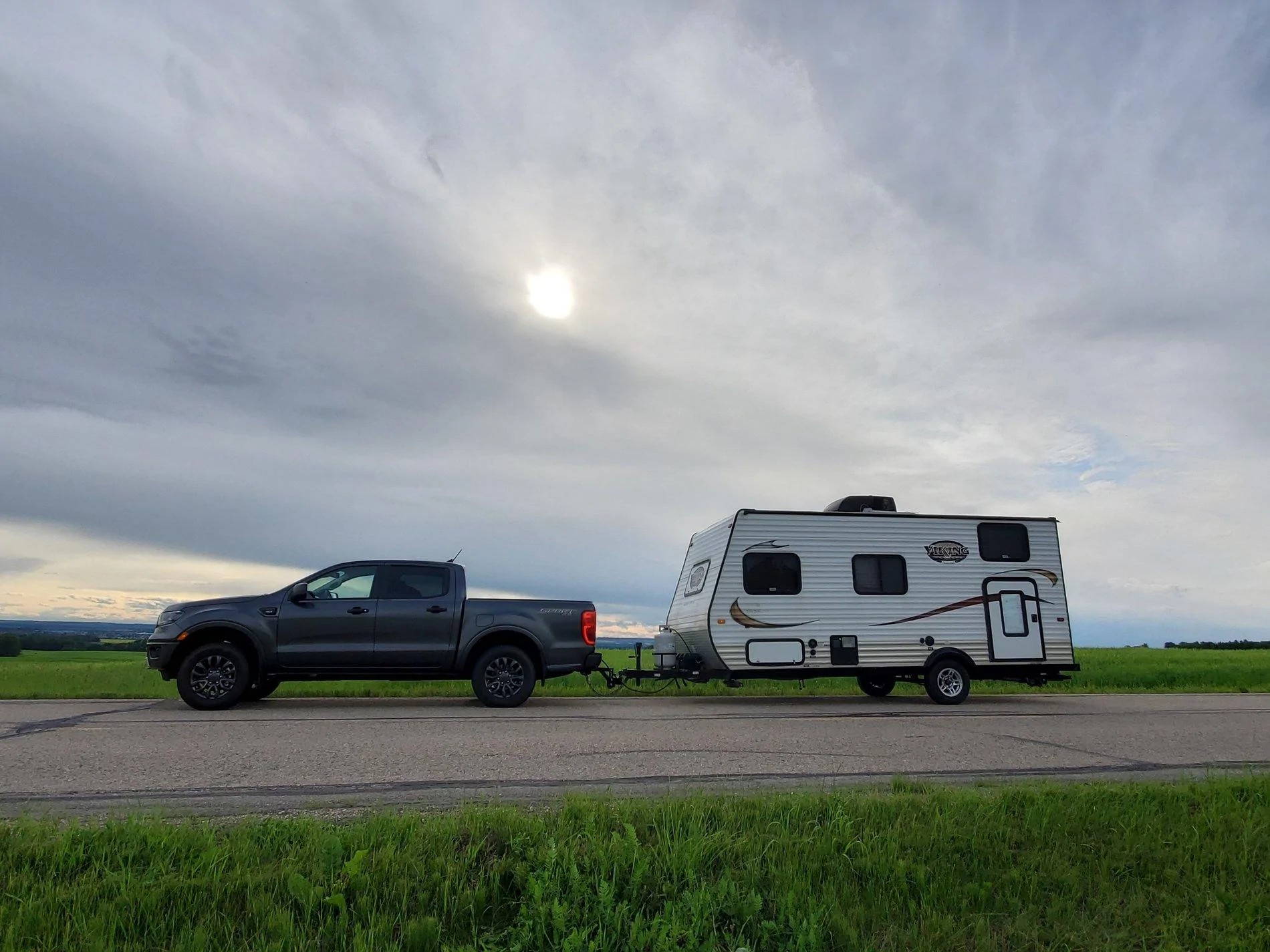

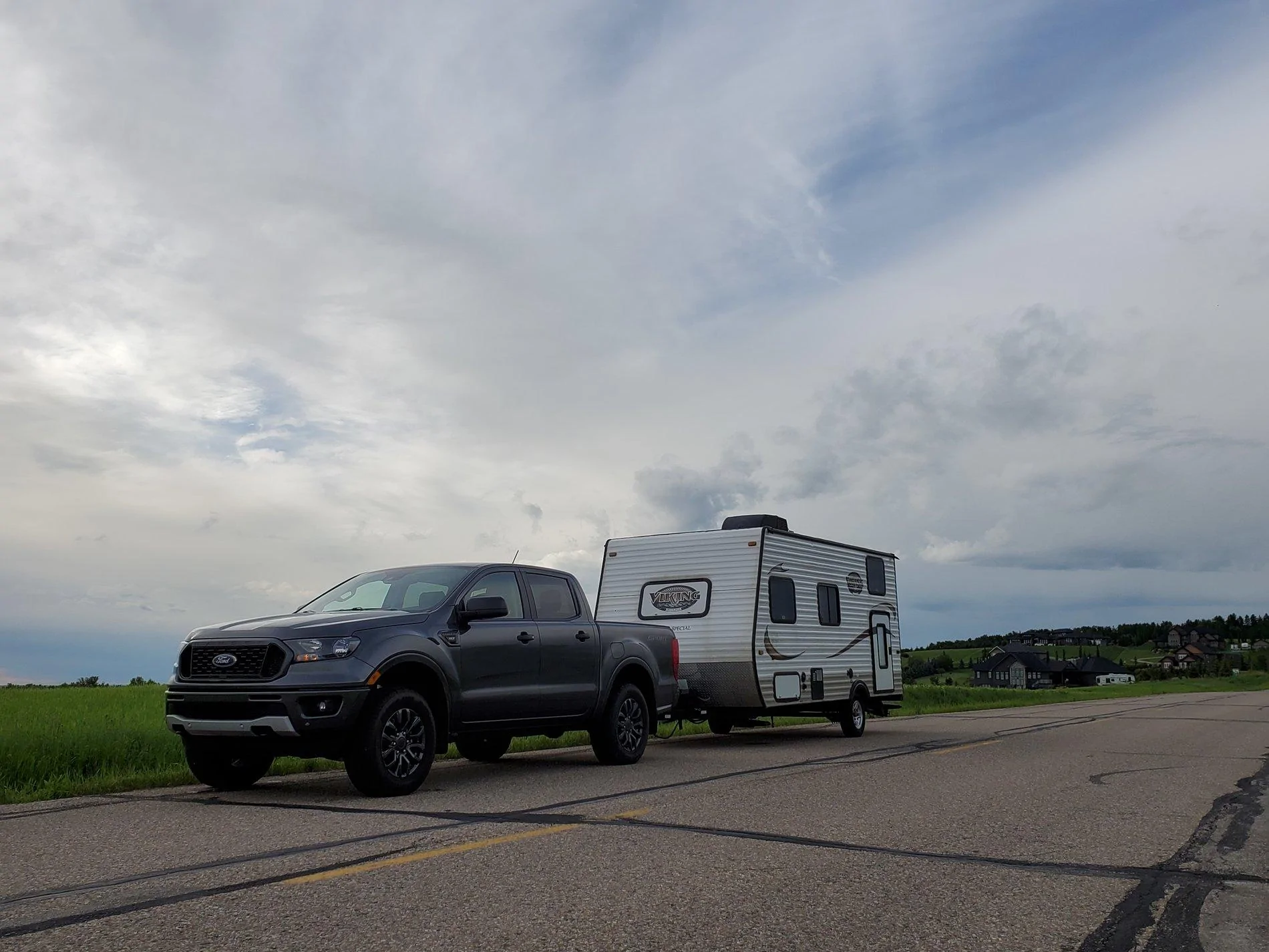

I finally got some time and did a test tow.
My problem absolutely came from the weight distribution bars. I did a real good test loop with no weight distribution and just the friction sway bar. Tows like a dream now! Trailer has no side to side interference on the truck and tows straight and true. Thanks for the tips and help guys! I'm very excited for 400km tow this weekend. Here's a pic from today.

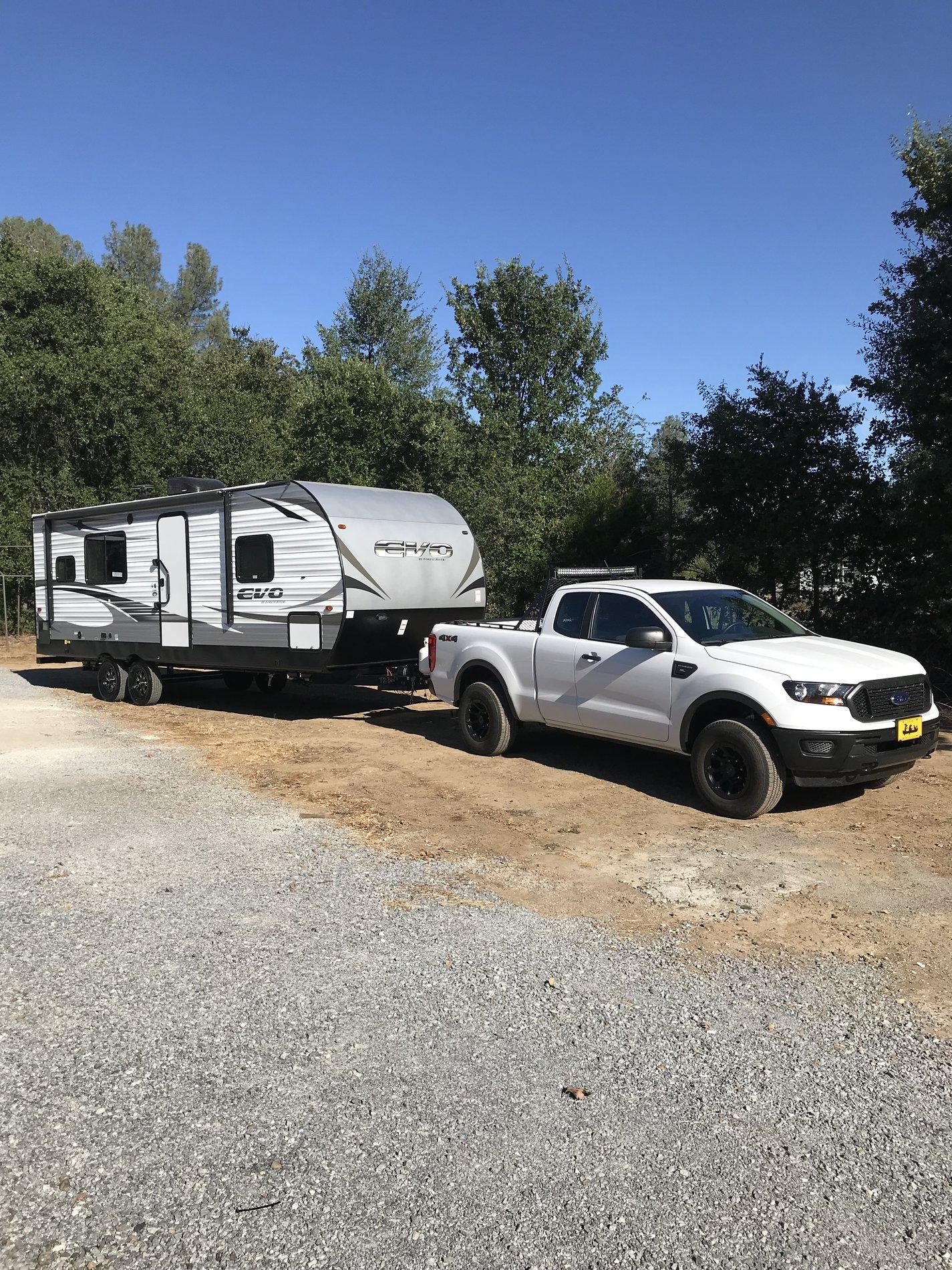

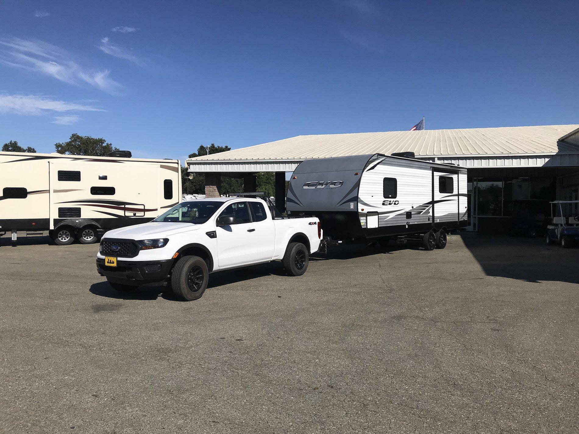

So I just picked up a 25’ travel trailer weighing about 6000 pounds and I think they set up the weight distribution hitch too tight as well. I have the same complaints

Not sure if your truck is on level ground, but your trailer looks like the nose is way too high. Either your ball is to high compared to the trailer coupler or you have way too much weight distribution. There are tons of videos on youtube explaining the set up for basically every weight distribution out there. They are mainly similar, but slightly different. I'd check your set up real good. I will say this, my 30 ft trailer gets disturbed by wind ( other traffic, trucks, cross wind etc. ) way more than my 24 ft did. If I'm in clean air it tracks straight and true up to 70mph, but If a semi, car, bus etc. passes me, the turbulence effects my travel trailer and causes some sway. Even as I approach large vehicles I can feel the wind start to affect me. Not sure there is a fix for that.....

It’s pretty much 100% level, this ground was very uneven. Ya I know what you mean
Also I loosened up my weight distribution hitch and tightened up my anti sway and it feels way better
