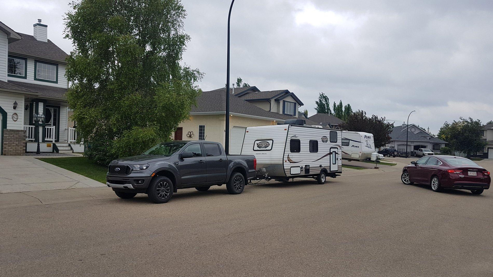

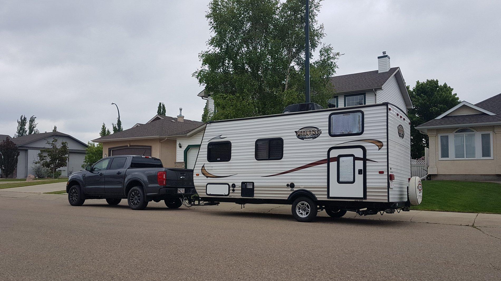

Thanks for the reply guys. I think my tongue weight is good. I have the trailer level with the hitch, two 6 volt batteries, 30lb propane and the majority of storage items at the front of the trailer. Only thing that could increase my tongue weight is too fill my fresh water tank(located front end of trailer) which would bring me close to over GVWR or lower my hitch which would make my trailer sit nose heavy.
The next step I need to do is test it without WD and Sway control. Take it to a weigh scale to find accurate tongue weight and to try hauling with water on the trailer.
Let ya know what I find out.
I attached some pics of my set up. Let me know what ya think.

Did you re-setup your bars from your prior vehicle? They look like they are bending quite a bit which means they are transferring weight to the front axle. Don't take me the wrong way, I'm just trying to help out.

I'll second that thought of the too tight WD bars.. Most people don't realize a weight distributing hitch can put a lot of the tow vehicle weight onto the trailer axles when distributing the wight on to the tow vehicle front tires.. That may be why the rear of the truck feels squirmy, too little weight on the rear. No need to have them tight for a 3200 lb trailer.

I added a new shank for increased drop on the hitch with the ranger. Very good point on them being too tight. Ill take some tension off. The pick is with 5 links of WD bars and that causes them to bend a bit. 4 links and it sits pretty much level with the trailer tongue. That should load up the rear of the truck more.
