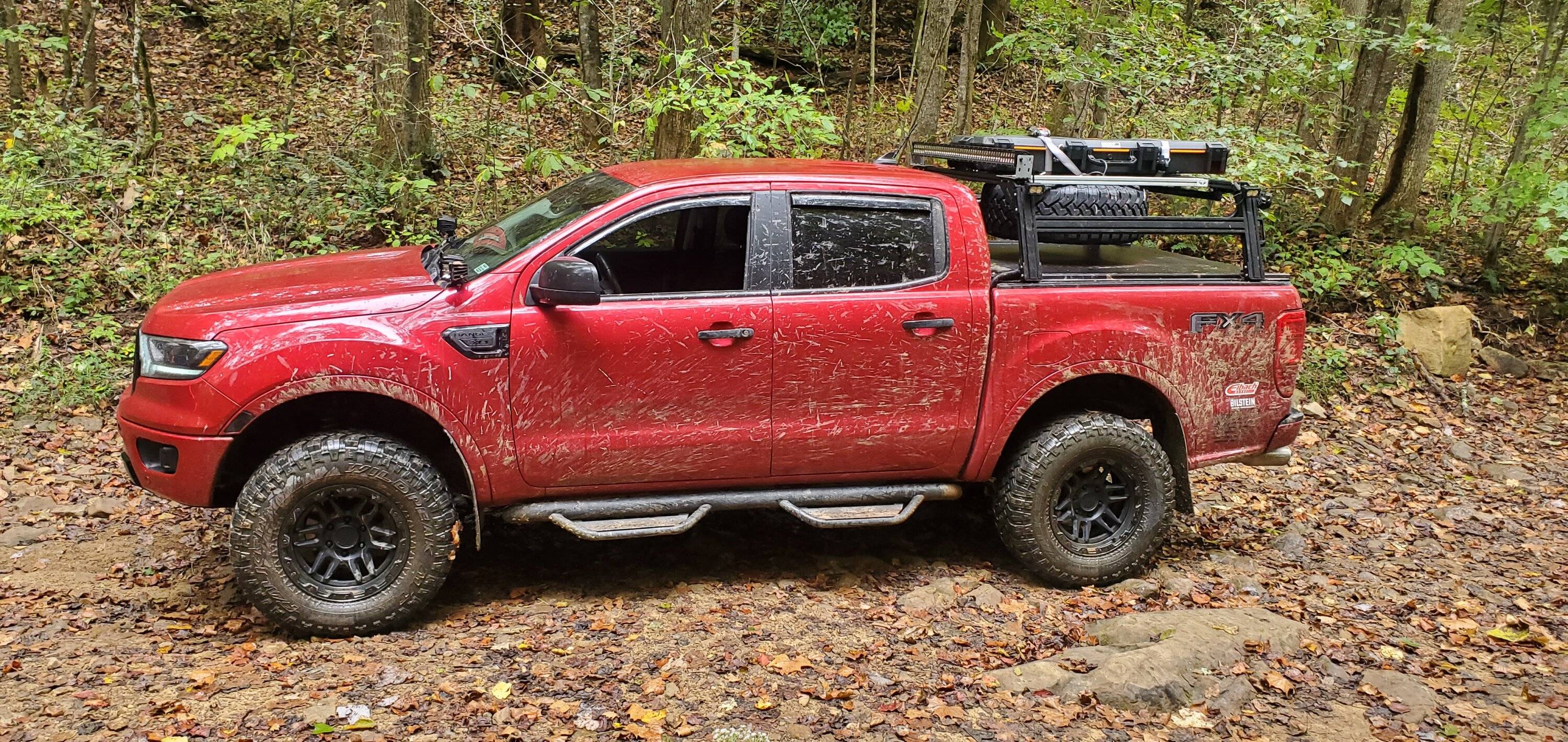

Two questions, I also have the Icon Leafs, and I started with option 3 thinking I had a lot of weight usually at least 600 to 800 pounds with everything included. The back was raised over 2 inches even after I let them settle, and a couple of off road trips. So I went to option 2, and the truck sits nice and level with the factory lift on the front shocks. It was just a little short of 2.5 inches of lift. I also tried mounting my spare like you have it on the bottom of the rack, but it bothered me too much every time I looked in the mirror. Is that something you get used to, I removed mine after one trip?

The eibachs give me 3" up front, that's why mine looks more level on option 3. I'm guessing you didn't have as much weight over the rear or I have more than I think lol. My rear is about 1.1 or 1.2" higher than stock. I have a retractable bed cover, the rack, lights, awning, spare tire, 2 tool boxes with tools and a spare alternator, and recovery straps/ratchet straps in the bed all the time. And factory spray in bedliner.

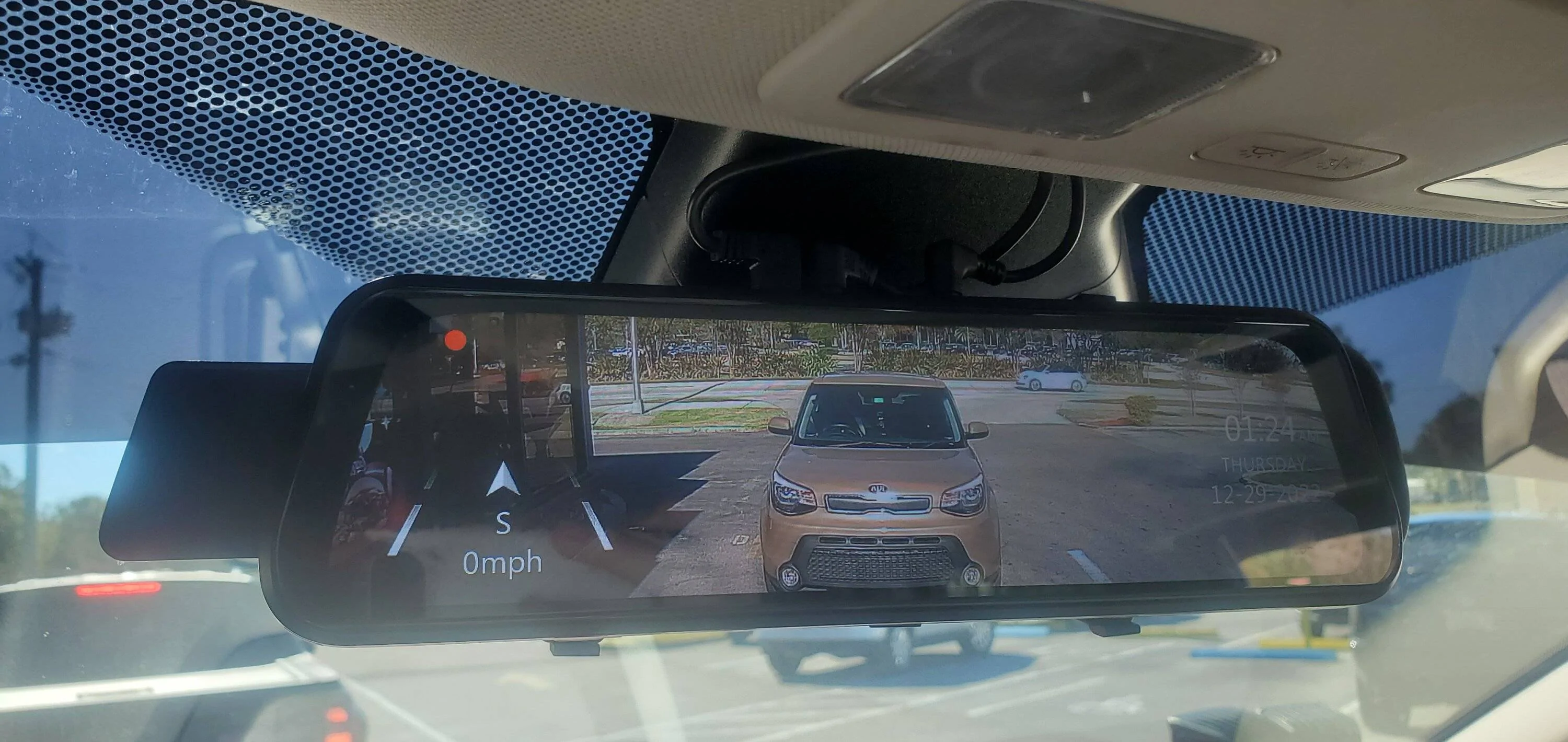

I knew the rear view would be useless, I got this on Amazon for about $150 a couple weeks before i mounted the spare there. The camera is mounted on the back of the rack and it's also a front and rear dash cam.

I think the difference is you have more lift in the front then I do. The weight seems to be about the same I have everything you mentioned minus the Alternator. Never thought about mounting a camera in the back good idea. Maybe I will do that I do not like the full size spare under the truck.
