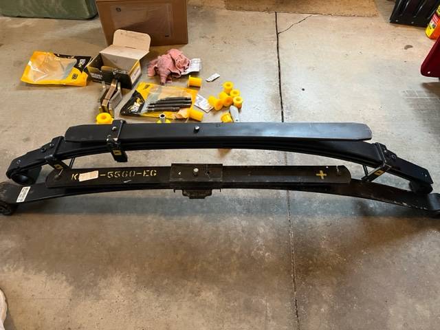

Got the springs together just to see the difference in size. Started working on the passenger side.

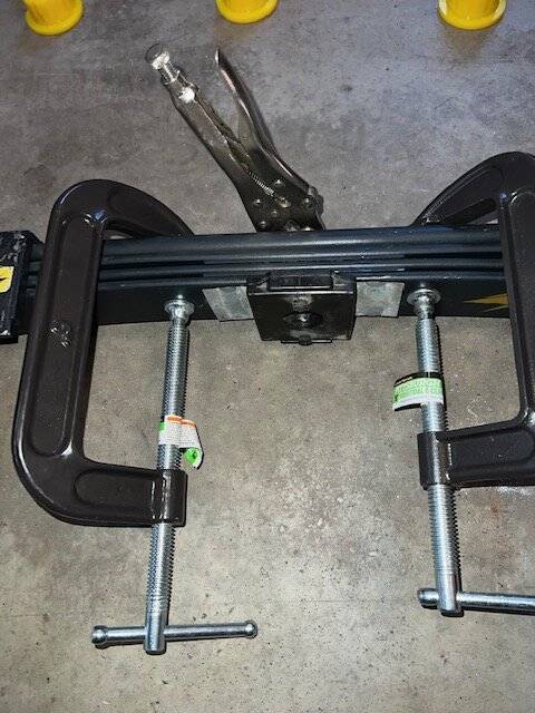

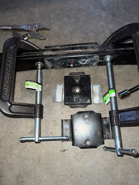

Removed the bump stop plate from the factory spring. As you can see you just need a couple clamps if you choose to do this step. I ended up torquing the bolt at 65 ft lbs.

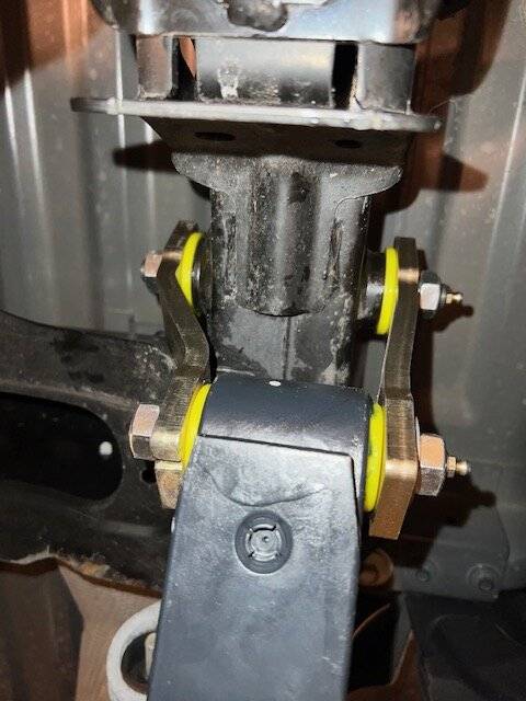

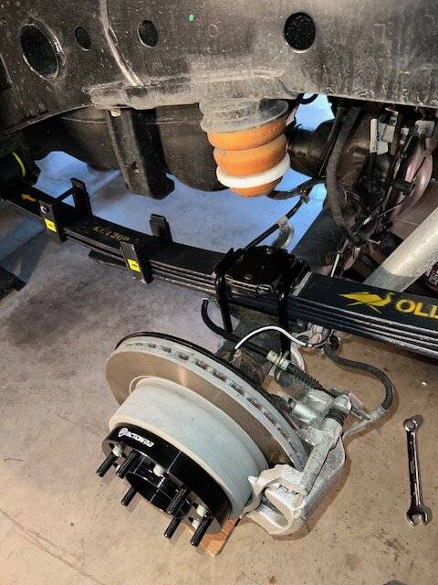

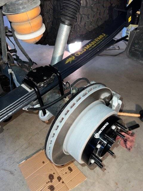

Started on the passenger side. Here is where the fun begins. The rear grease able shackles are a PITA. Took over an hour (PS only) to install them, which is crazy. The bushings would just not come together with the bolts in them. They would off the truck. The tolerances are very tight. Lying on your back the whole time makes it tough.
In the end it got done. I'd like to think the DS will go better.
The next step were the U bolts. They went on great. No problems. Torqued them down to 26 FT lbs.

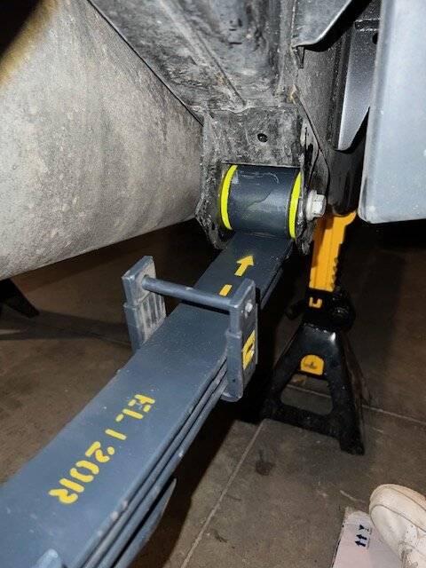

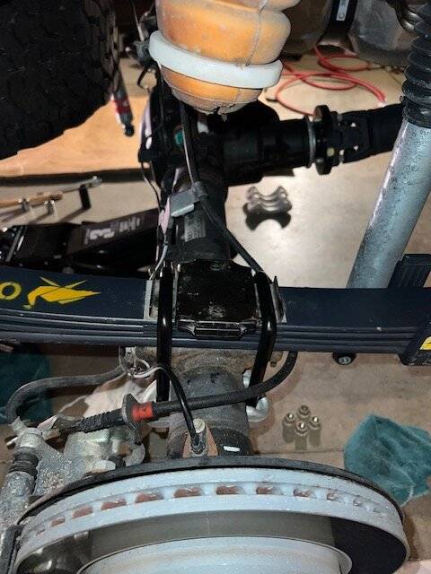

Here is where some directions would come in handy. The front spring mount will NOT just fall into place. It took a few minutes to figure out why. The DS spring HAS to come out, or you can let it hang only by the rear shackles. You'll need to use a jack under the pumpkin to get it just right. Spring installed!

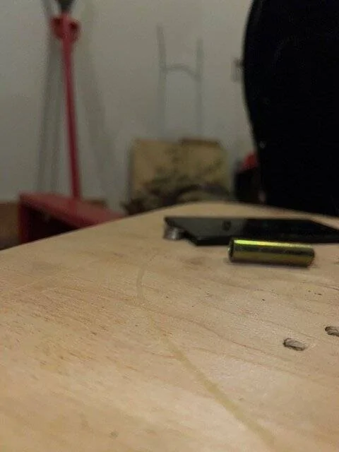

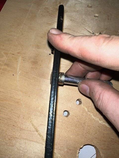

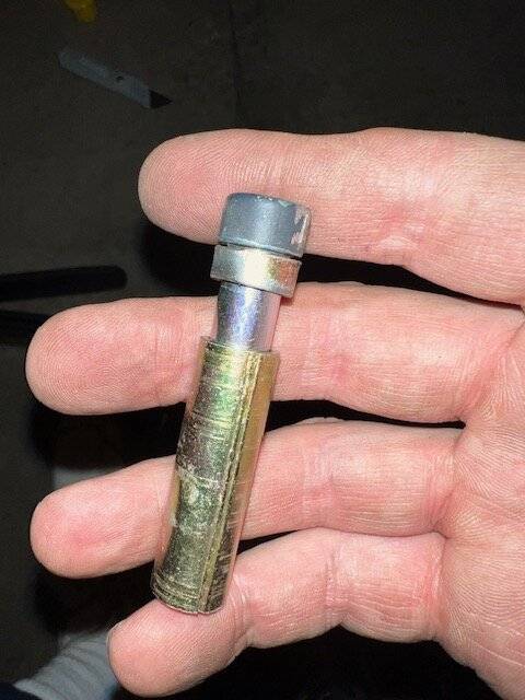

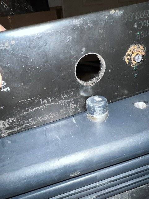

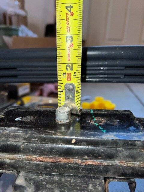

OME might have dropped the ball here. They do not account for it in this kit. Here's why.
The pin is too short and doesn't account for the factory shim.
You have a couple of choices. Go without the shim (I chose not to) or make a spacer for the thickness. I was lucky and had an old roll pin that fit perfect after I took a hacksaw to it.

I think this will work.

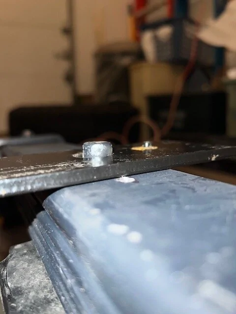

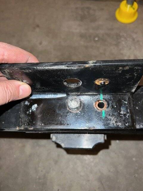

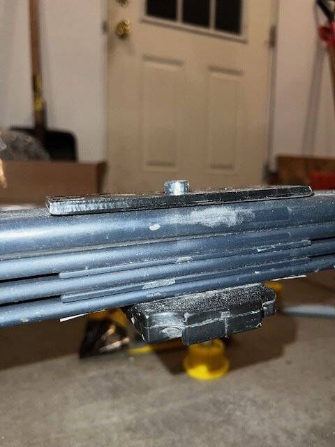

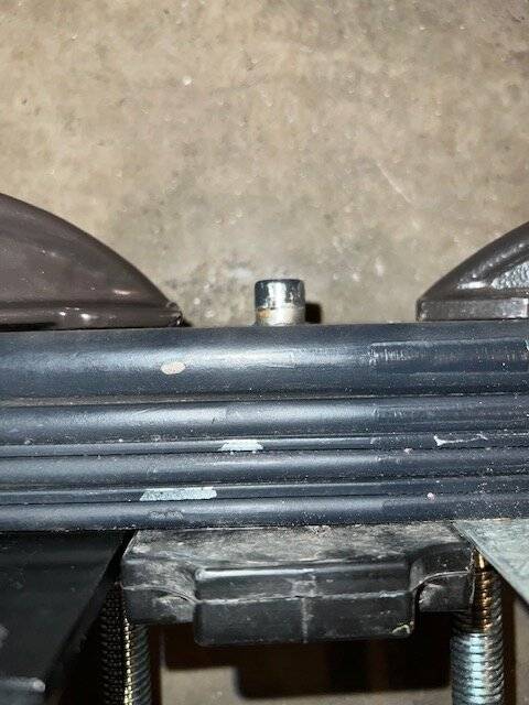

Lastly for today I decided not to grind off the little tit the centers the factory shim on the spring pack. I drilled a hole instead. Came out good enough. IMO.
The rest of the DS will have to wait until tomorrow. I'm beat.

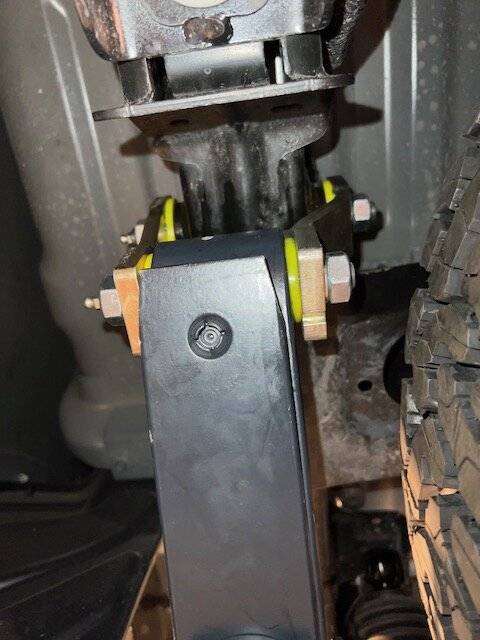

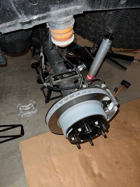

The DS went mush better after the short comings I addressed earlier. The shackles/bushings go together better If you do both sides equally and at the same time. Also leave the grease zerks off if only to let air escape while trying to squeeze (nut on each side ) everything together.
You'll have to jockey around the front frame mount bushing a little, but it will go. Extra set of hands will go along way here. Mainly on the jack and to stand on the spring itself. DS DONE!

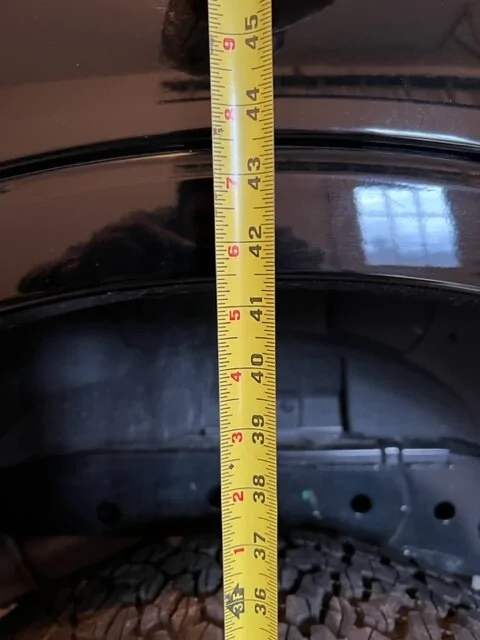

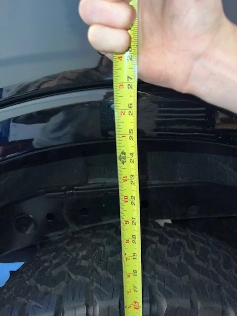

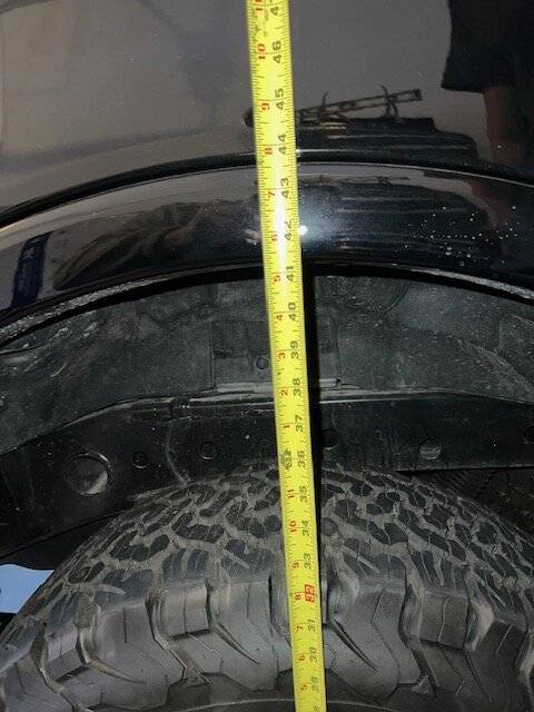

I did take some "after" measurements. They are EXACTLY the lift promised by, Old Man EMU. Floor to wheel well and top of center cap to wheel well. PS first.
I'll add, from the floor to the very top of the bed is 4' 9" or 57"!

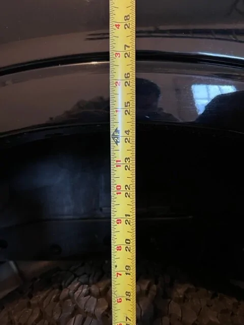

DS. Glad I kept the factory shim in!
