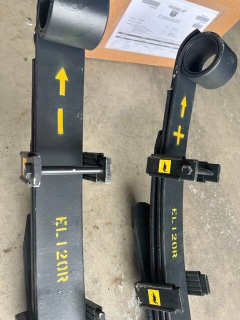

Side note. I came across this short blip on the ARB site. I thought I could rid the truck of the DS installed shim that came from the factory. Don't think so. The pack would need another 3MM as the shim is 6MM. Damn-it! Oh well, can't win them all.
"Certain Old Man Emu coil and leaf springs are labeled “A” or “B”. In most cases, the “A” springs have a higher free height than the “B” spring. This is designed to compensate for existing lean, driver weight, aftermarket accessories, fuel tank, and weight distribution. Pre-installation measurements will allow for a more accurate A/B spring fitment. All leaf springs will be labeled with either a “+”, “0”, or “-“ which signifies a tolerance of up to 3mm. “0” is exact, “+” is slightly above up to 3mm, “-“ is slightly below up to 3mm. Each spring goes through the proper tests to ensure that they meet the tolerances specified by the Old Man Emu Engineers. All leaf springs will have an arrow marked on the top of the spring. The arrow is meant to point towards the fixed end on the frame opposite of the shackle."
Just for further clarification on this. Here’s the same explanation, worded slightly different. I received two “+” leaf springs and I wanted to make sure I didn’t need a “+” for the DS and a ”-“ for the PS.
I reached out to Frank at Stage3, he got this info from ARB:
Here is the response from ARB, essentially those markings are just put on the springs to identify their measurements in quality control and not meant to be sold or paired together any specific way as the tolerance is “tight”
“Hi Frank,
Thanks for reaching out about this!
All Leaf Springs are marked either "0", "+" or "-"
There is a very tight tolerance for our leaf springs. Each leaf spring is 100% vehicle weight tested. After that, we test the height to ensure it is still correct taking the vehicle's weight into account.
The tolerance is up to 3mm (.07 inches).
The + means it will be a little taller, but still within the tolerance.
The - means it will be a little shorter, but still within the tolerance.
The 0 means it tested perfectly.
Any leaf spring that is outside of this tolerance does not go into the market.
This is actually a major advantage of OME Leaf Springs.
If you ever had a + and a -, you would ideally put the + on the side with more weight, even if it's just the steering column.”

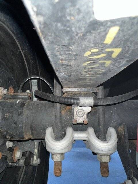

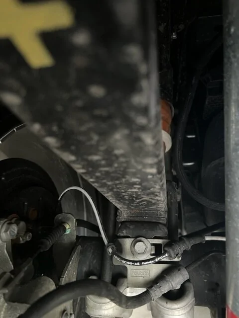

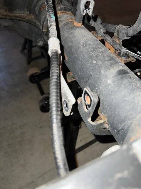

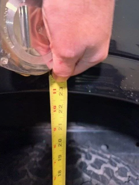

More impressions to come, as you can see from the pic, I didn’t reuse the factory bump stops. This is because the gap between my Timbren rubber helper springs and the leaf spring pack is exactly what I wanted at unloaded ride height. And the rubber springs should mate up nicely with the leaf springs under a heavy load. I also ran into the same issue with the locator pin and reusing the factory shim. I opted to leave the shim out and the left side sits 3/16” lower than right; which isn’t visible to the naked eye. I have a Diamondback cover and internal toolbox that rides in the back of my truck and adds about 250lbs full-time weight to the bed, and the leaf springs put the rear end about 1.4” higher than the front end (w/ 2” lift from Ford Perf Fox 2.0s). I now have a set of perfectly good low-mile FOX 2.0 rear shocks which kinda irks me but I wasn’t willing to experiment given another member’s experience popping those shocks through their 1.5” lift limit with the same 1.7” lift leaf spring setup. The Bilstein’s should do well both for off-roading and controlling any kind of porpoising from the trailer.
