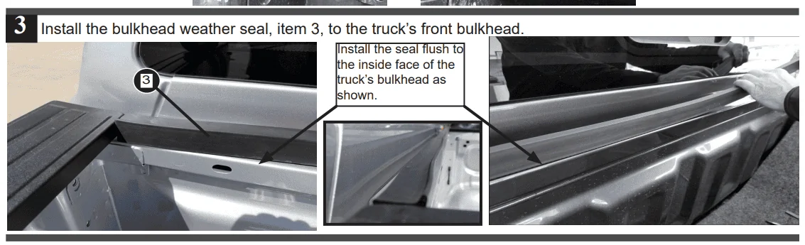

I have the Truxedo TruxSport roll up and never had leaking issue. One thing I read is that people who did have leaking issues, usually put the bulkhead seal on backwards. The high rib on the top of the seal needs to be towards the inside of the bed, with the flat vertical side flush with the bulkhead.
