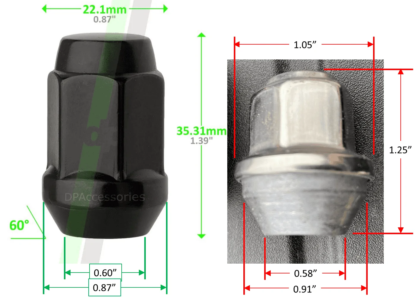

An update to my earlier post. My DP nuts arrived
Measurements are below
My measurements of the DP are at the bottom, other dims are from DP.
So it is smaller - looks like we are splitting hairs based on the diameters.
BUT
I wont bore you with the math, but this results in a stock contact area (the tapered surface) of 0.773 sq inches vs the aftermarket DP contact area of 0.624 sq inches. That's a 19.3% reduction in contact area. As an Engineer that is significant.
So why did they do this and still recommend them for our truck? Hell I don't know!
I have my take off still in my garage (anybody want some machined wheels!?) placing each lug nut into the wheel it obvious the stock really settles into the taper and with moderate downward force you cant push the lug sideways out of the taper. With the DP lug its easily pushed out of the taper. So what does this mean. Again Hell I don't know! Its just an observation.
BUT

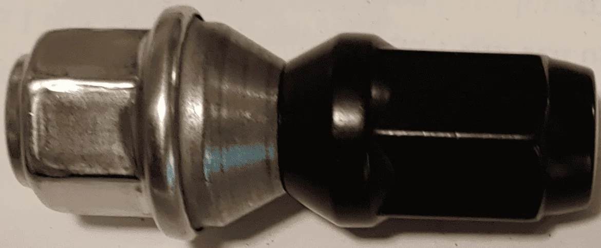

My last pic on this topic - Had a metric bolt in my Hdw pile and threaded the 2 together. You can really see the difference! Sending these back....
Probably will go Dorman and stay with chrome, just in case the black coating has an impact on retention.
