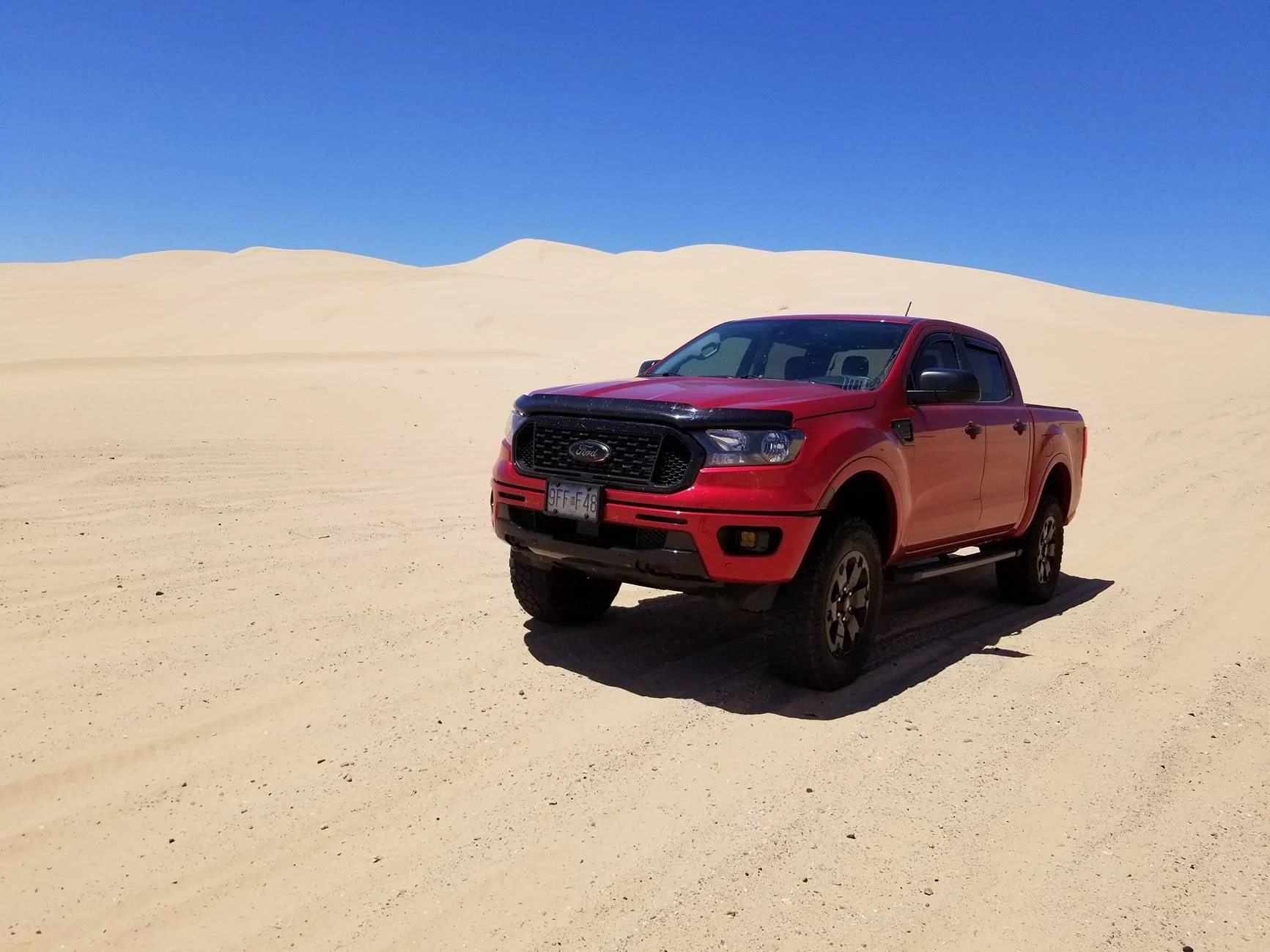

There's going to be a lot of scraping and banging going on especially if you're on rocky trails. The key is your approach angle and your speed. You always want to go slow (like barely crawling) over rocks and make sure you air down, I usually go down to 18 lbs.
The second picture above was from Schnebly Hill Rd in Sedona. It's 6-7 miles of rocks and drop offs and really designed for Jeeps/Broncos. I had to try it in my Ranger but I wouldn't again as it was a back breaking 90 minutes ride. I was wondering why there were no other trucks out there and only Jeeps that day. lol This was done with the stock Fx4 pogo stick suspension and 32's so it just shows you it can be done without any crazy lifts. The only damage was a big scrape under my stock side steps. :whew:

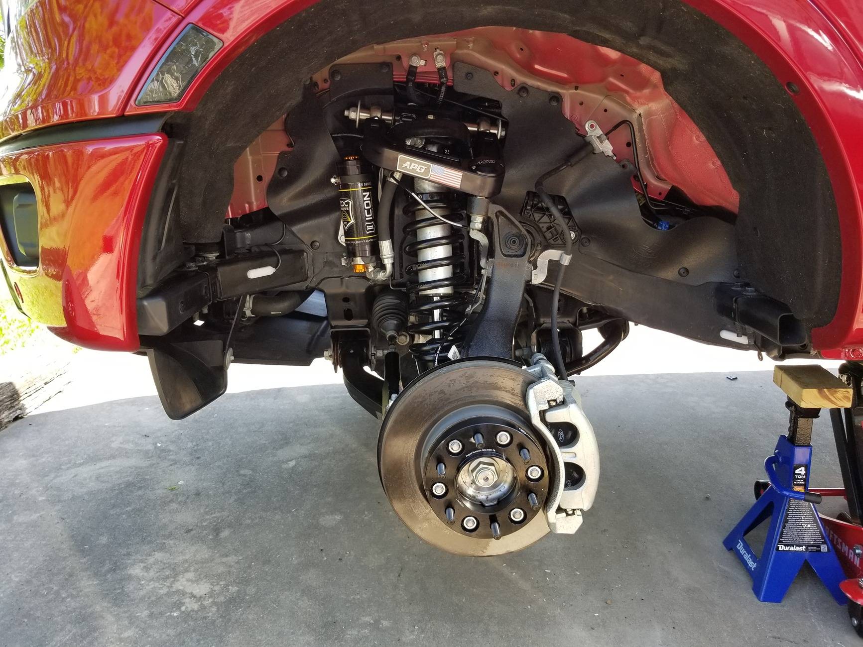

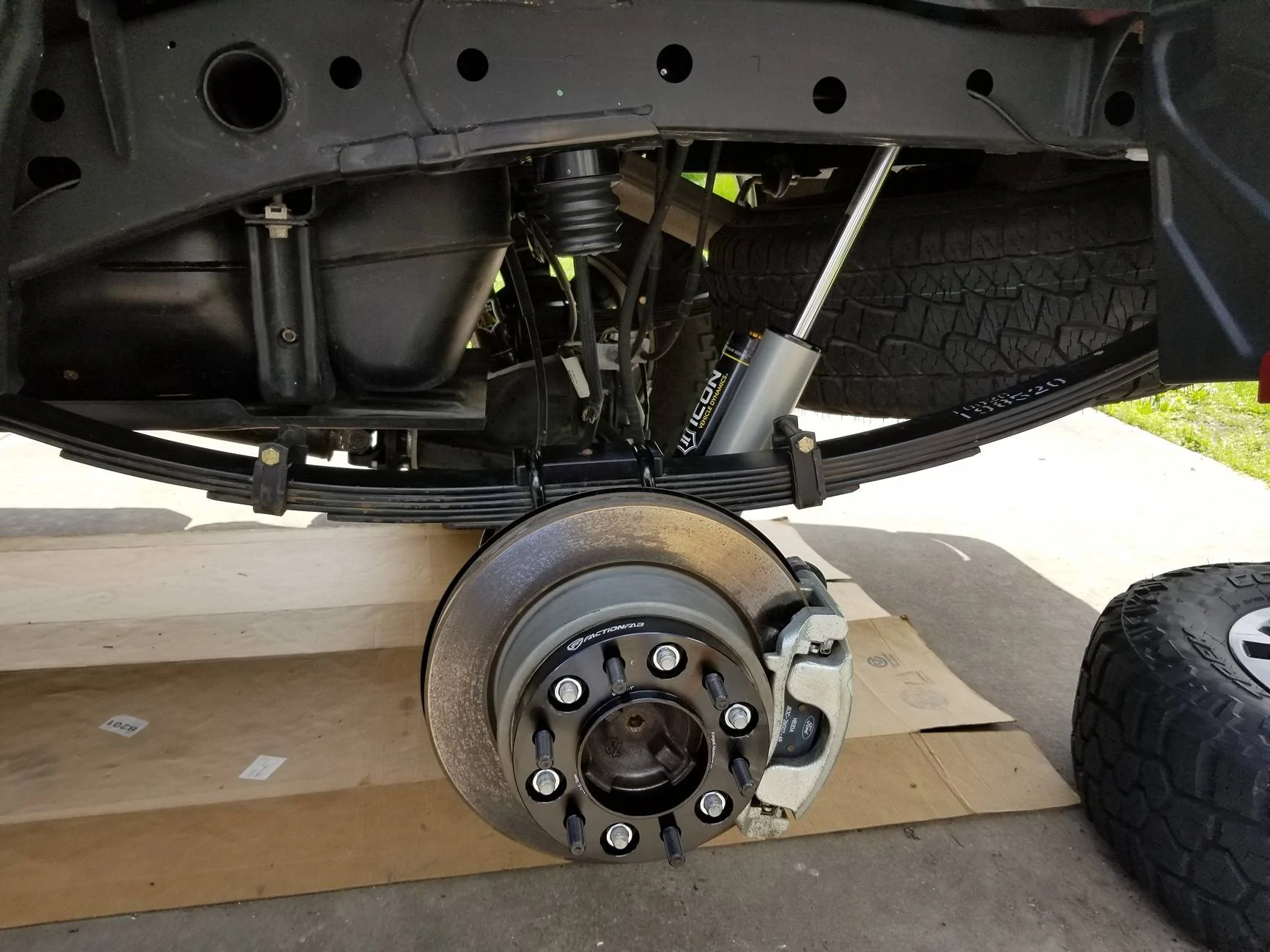

I "leveled" my truck with an Icon Stage 3 kit. This allowed me to run 33's with no problems. Got rid of the factory 18" rimes and went for aftermarket 17" for better tire selection. Couldn't be happier with its performance and looks.

Beautiful truck! mind sharing the cost of doing all of that? Might follow your footsteps

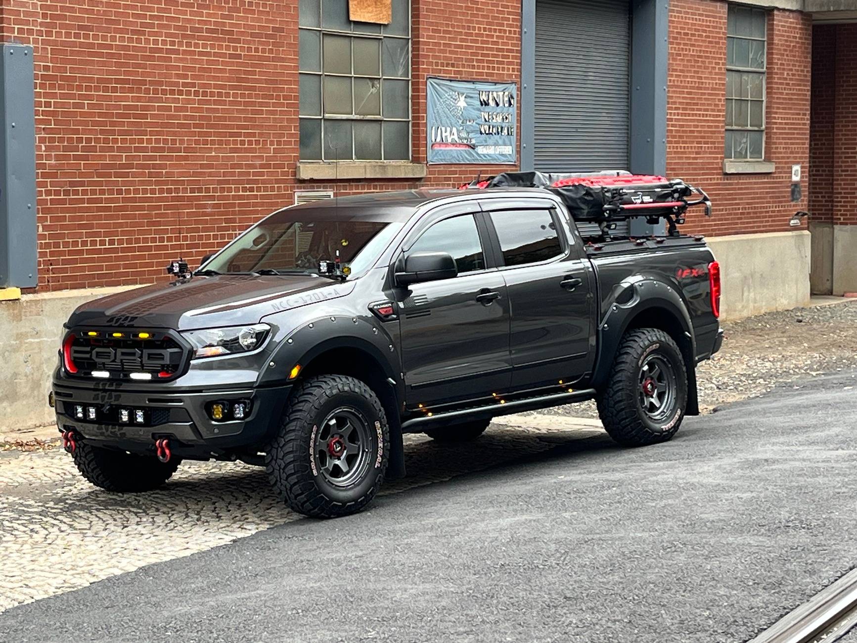

For the record…AzScorpion takes immaculate care of his truck and has wheeled the pants off it in many places that are on people’s bucket lists.
As you can tell, we kid around a bit on this forum. Actually, this is one of the trucks I reference often to show people they don’t need to have huge tires or a big lift and fancy aftermarket wheels to get a great look and equally great off-road performance.
You don’t need 3-6” to be off-road worthy. Some folks go that high because they take their trucks places the rest of us wouldn’t dare, so it’s necessary. Others go that high because they take their trucks………TO THE MALL - and that’s fine - wait, no it’s not.
These trucks are great “out of the box”. In fact, you’ll see rigs on here with crazy off-road and overlanding modifications that are still running OEM wheels and tires.
I spent right at $6K for the suspension parts, wheels and tires plus labor. The Icon Sage 3 kits is currently going for around $3K itself. Wheels and tires can vary depending on your preferences. but you can easily spend $600-$700 per corner. I went with wheels from KMC and Nitto Trail Grappler tires. Don't forget to factor in the small stuff like TP sensors and lug nuts. I paid to have the suspension kit installed, but if you DIY you well still need to get a front-end alignment. Hope this helps. Good luck.

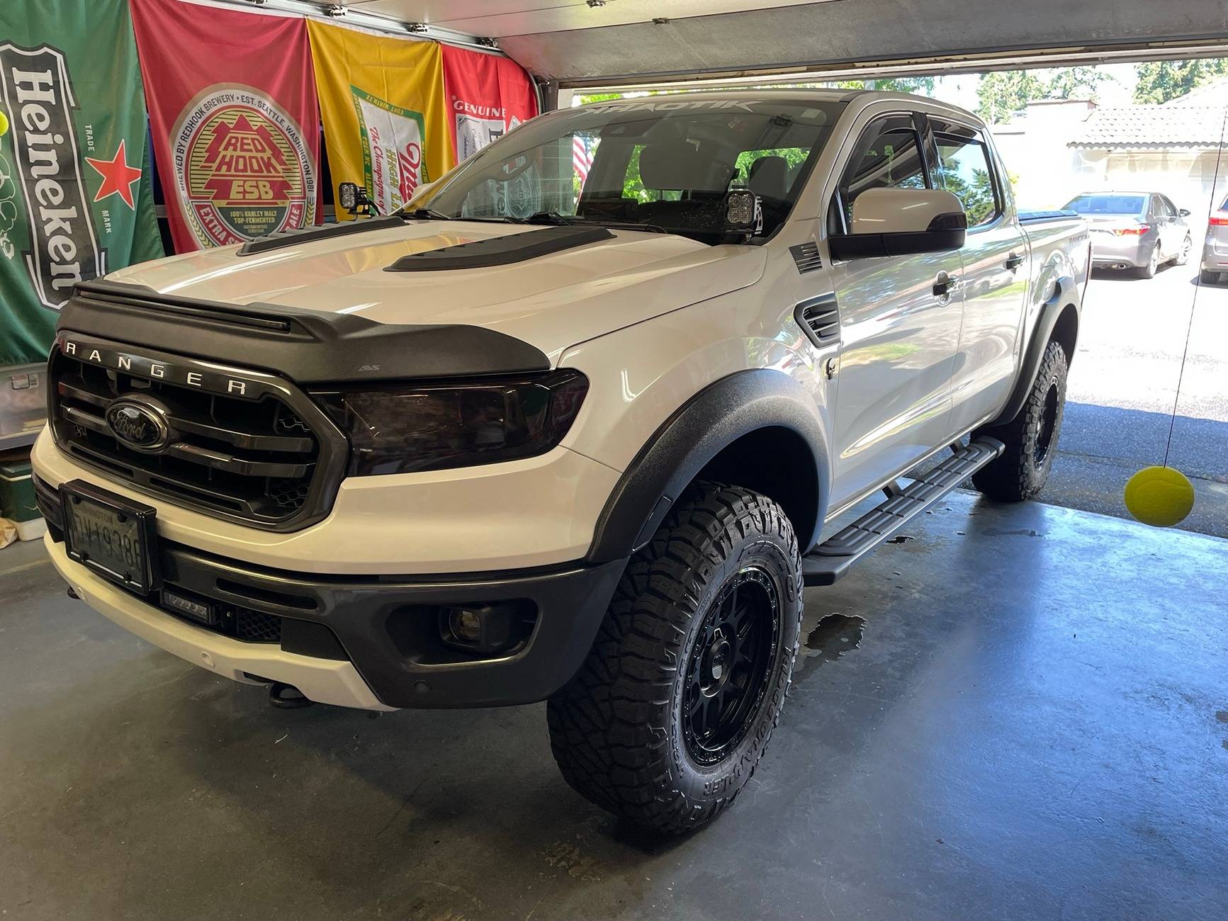

Not fur nothing but... don't overlook Bilstein. Alotta of people think they need something super sexy. I did the Fox 2.0 thing and they ended up destroyed. (My fault. They were inappropriate for where I ended up.) I figured I'd go with the very moderate and decidedly unsexy 6112/5160 stuff til I figure out what I wanna do for real. I'm done figuring. This is the stuff for me. ...with icon leaf packs.
My first go round with my suspension when the truck was new, I did'nt go far enough....After 6 months completely redid it with the sexy stuff....3.0" front lift, 1.0" rear....stock Ford BAP 18x8 wheels, 1.0" spacers, Skinny 255 / 70 R18 Cooper Rugged Treks, 45lb reinforced sidewall XL rated , 32.0" tires...all crash bars still untouched...get about 19 mpg, with spirited, mostly sport driving style...
This looks like what I might want to do, mind sharing what it cost you?
