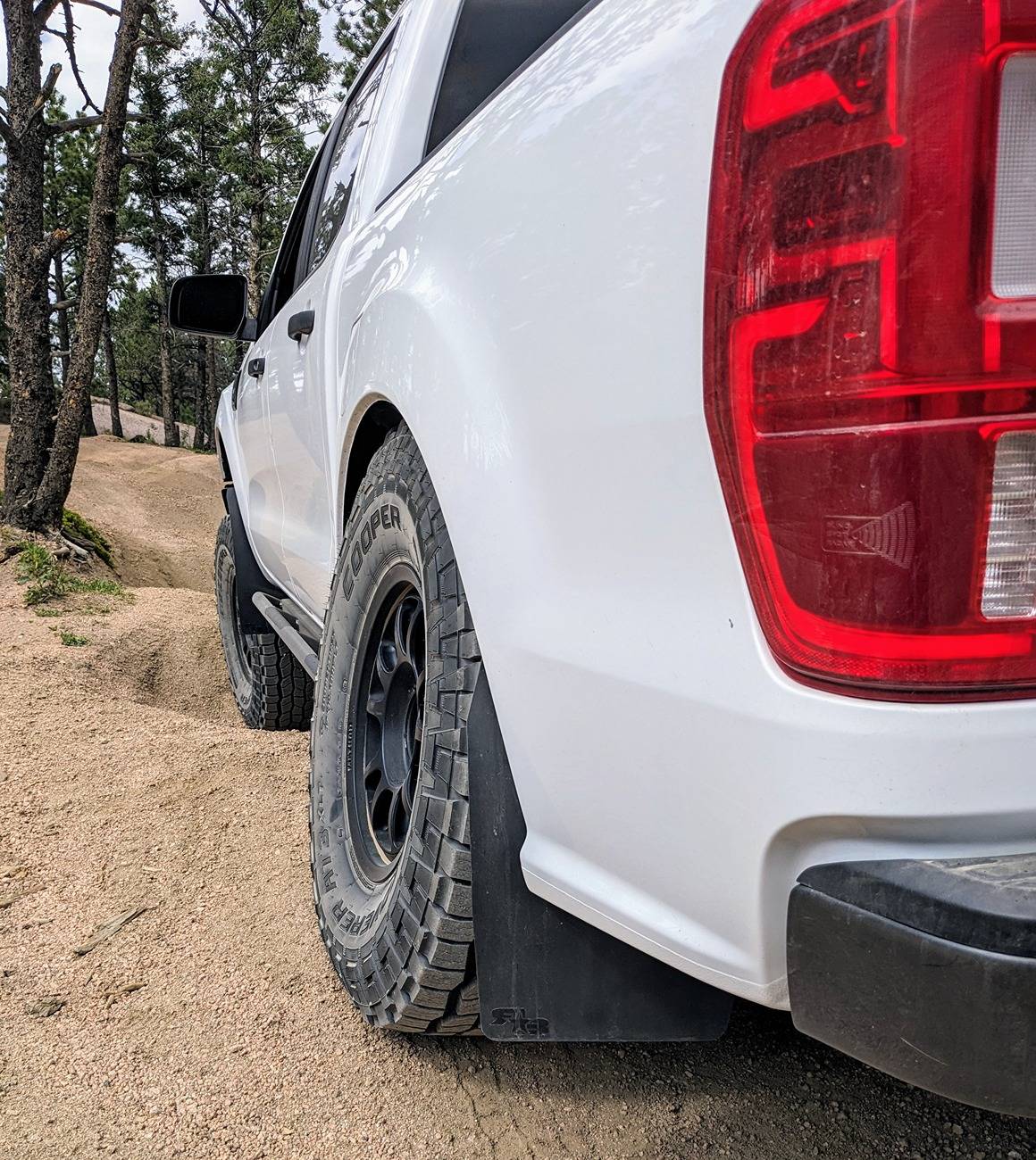

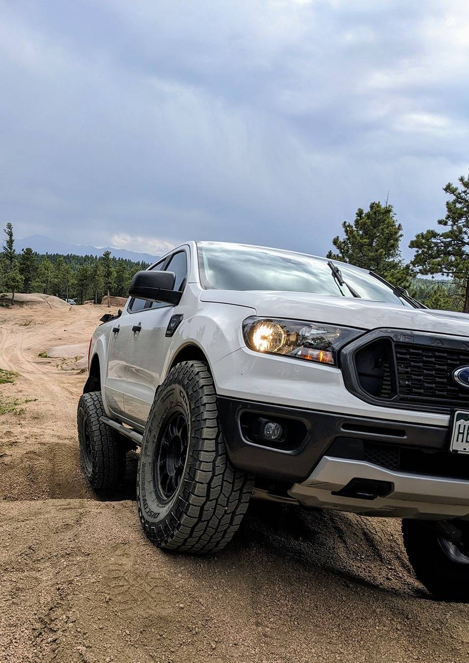

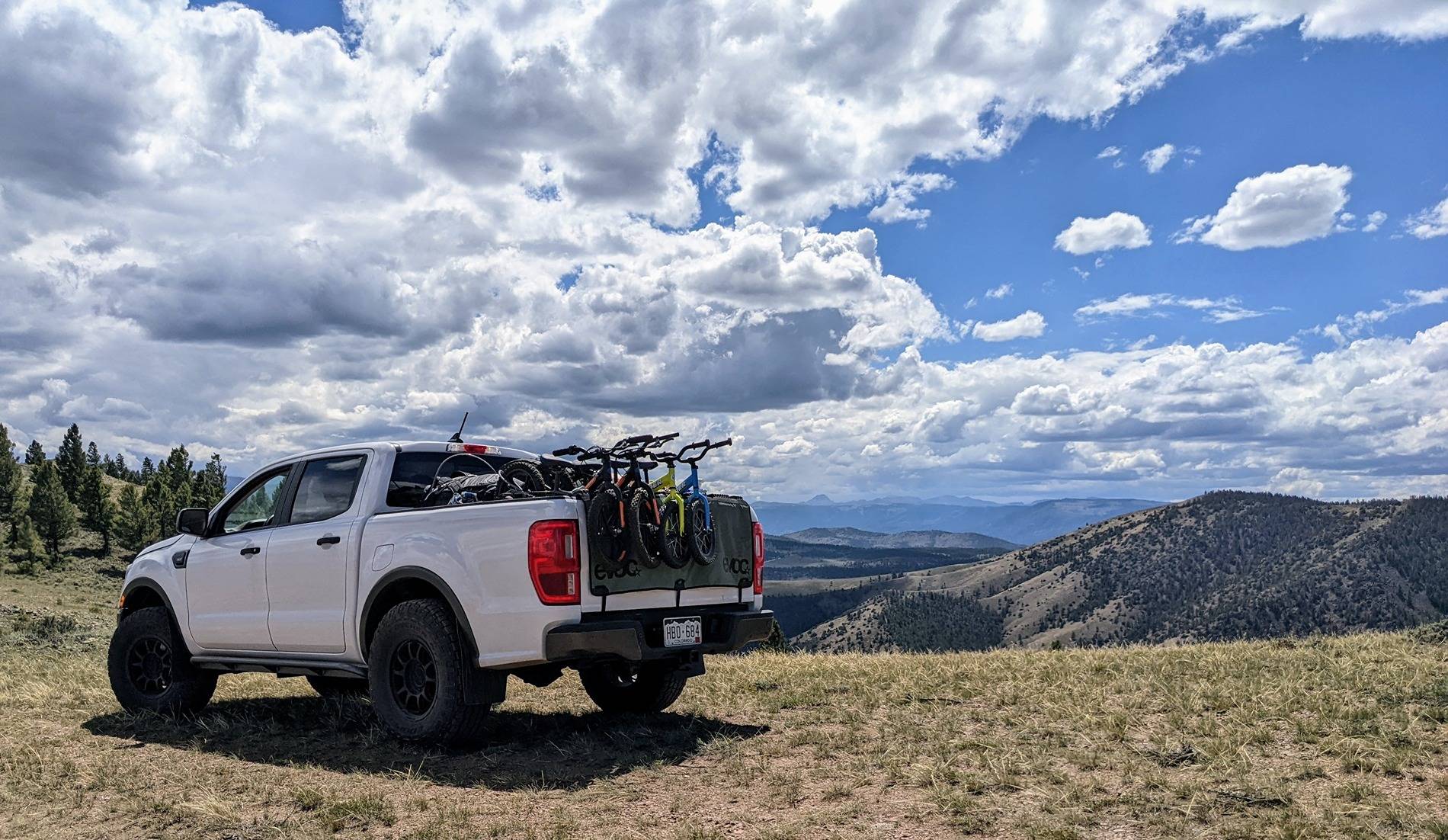

These trucks look awesome. Strider is still basically stock, but I didn't buy it to adventure. I actually bought it so that I'd have something that could make it up my driveway in the Winter. It does that beautifully.

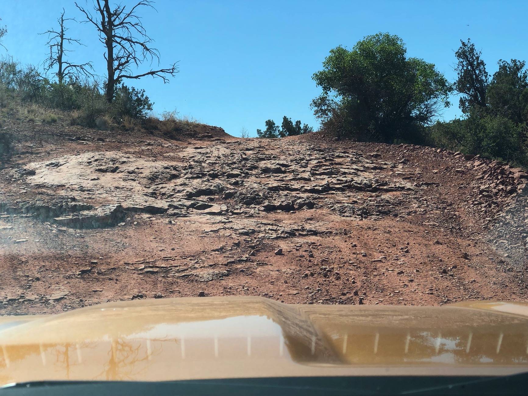

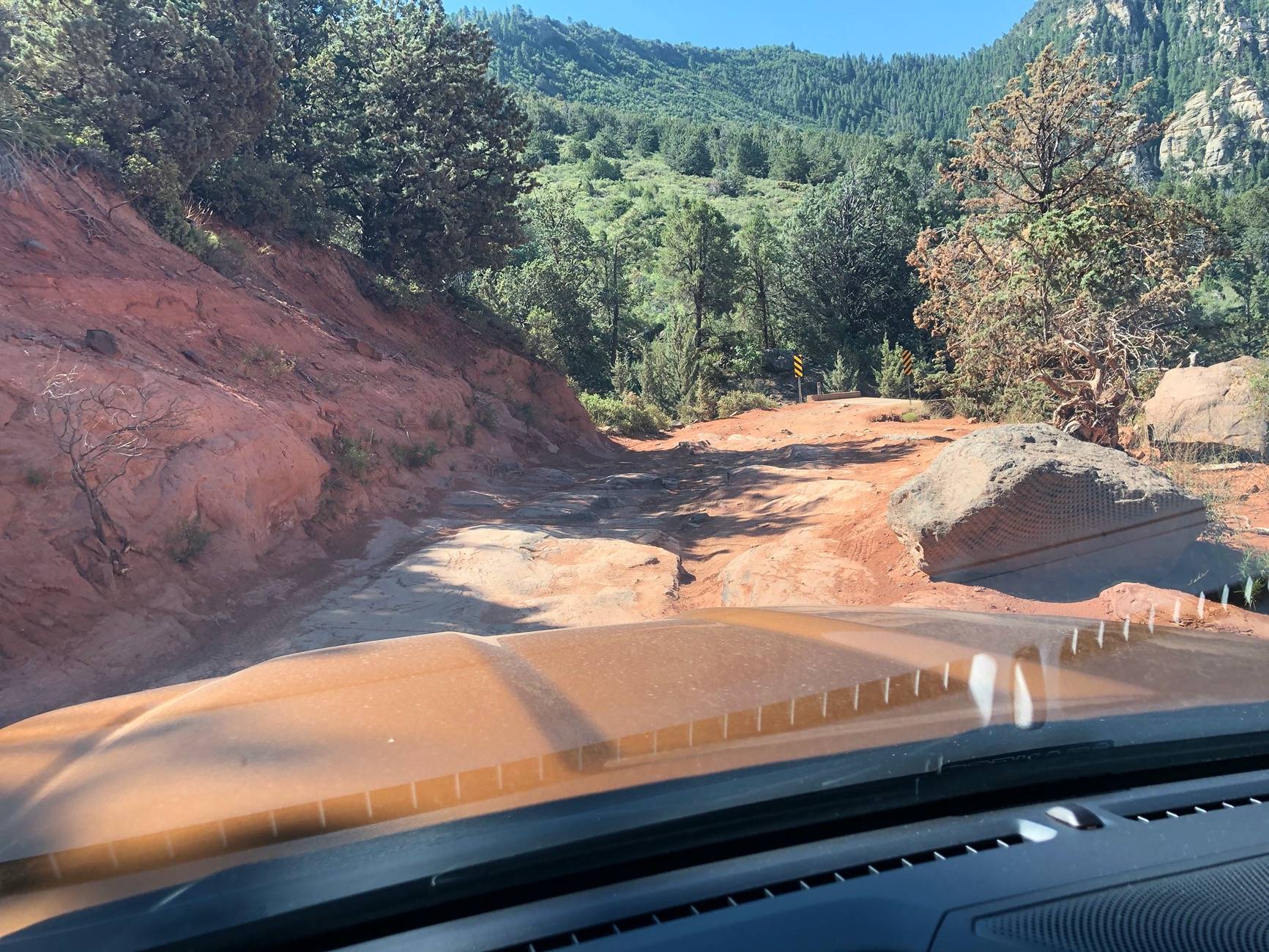

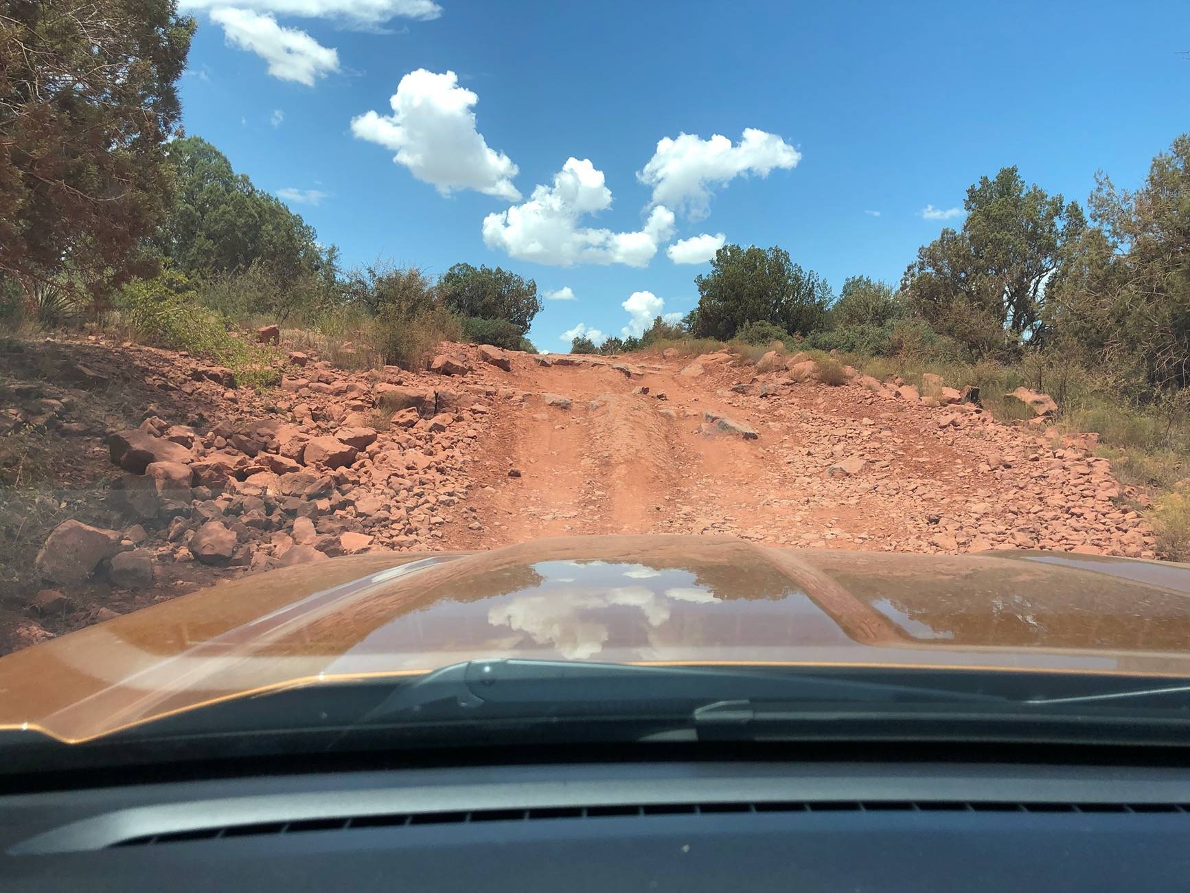

There's going to be a lot of scraping and banging going on especially if you're on rocky trails. The key is your approach angle and your speed. You always want to go slow (like barely crawling) over rocks and make sure you air down, I usually go down to 18 lbs.

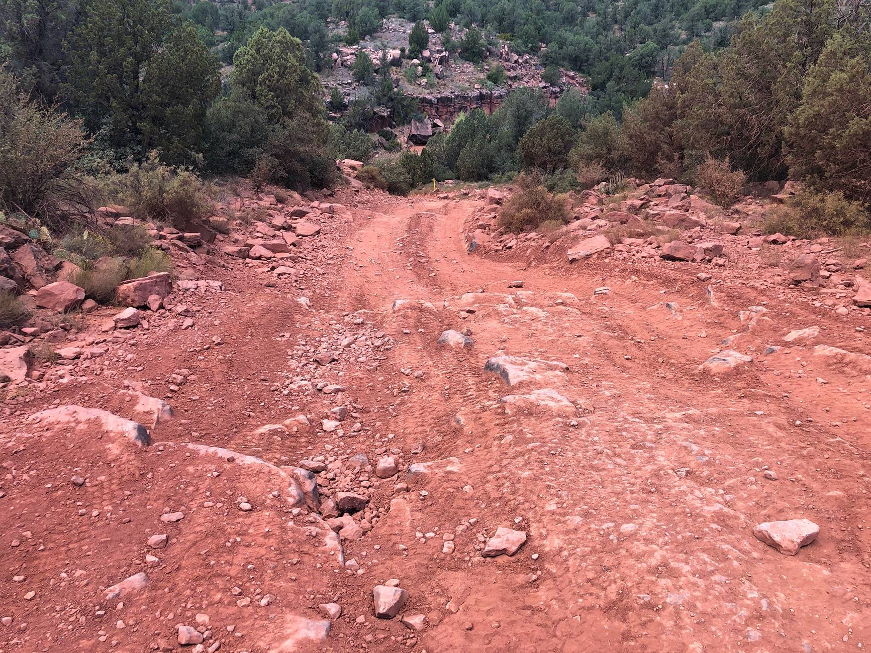

The second picture above was from Schnebly Hill Rd in Sedona. It's 6-7 miles of rocks and drop offs and really designed for Jeeps/Broncos. I had to try it in my Ranger but I wouldn't again as it was a back breaking 90 minutes ride. I was wondering why there were no other trucks out there and only Jeeps that day. lol This was done with the stock Fx4 pogo stick suspension and 32's so it just shows you it can be done without any crazy lifts. The only damage was a big scrape under my stock side steps. :whew:

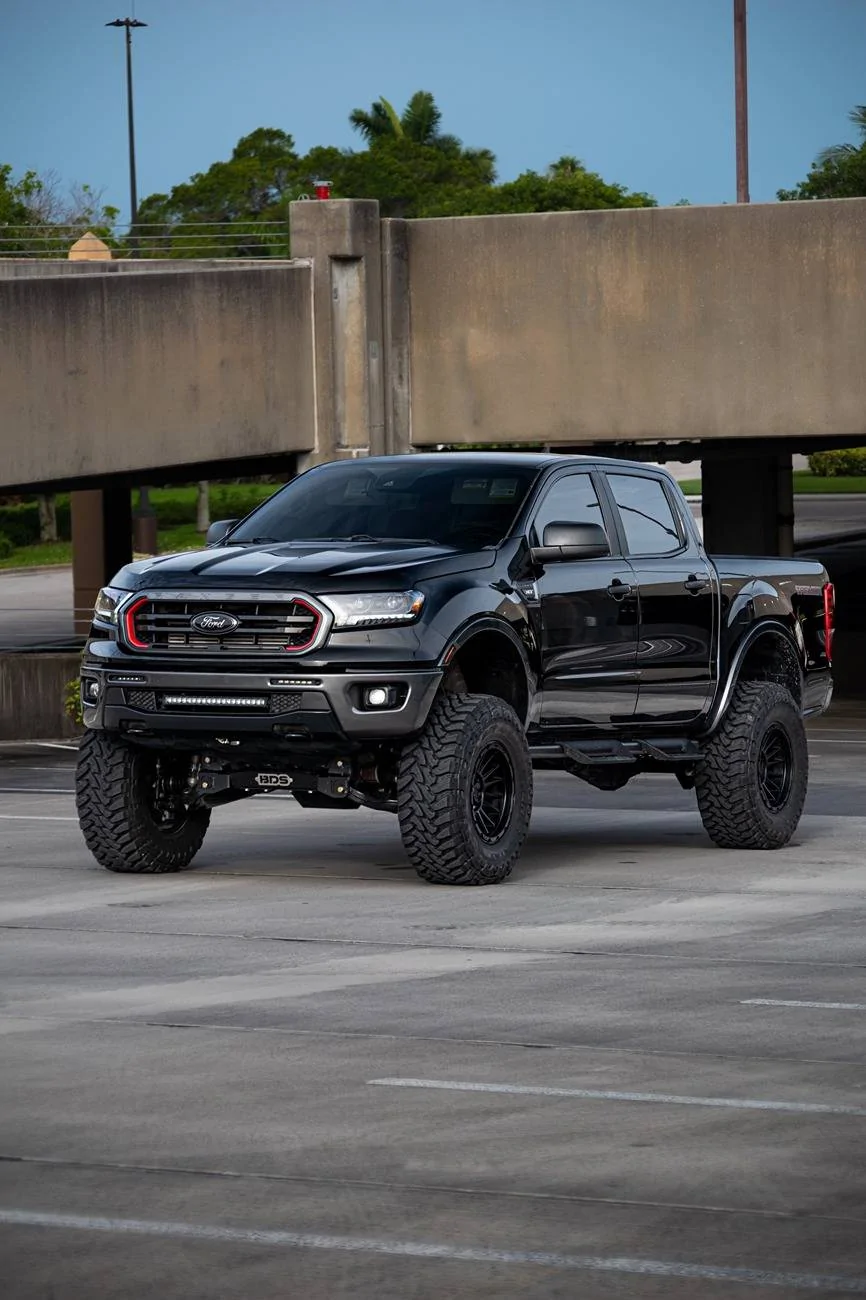

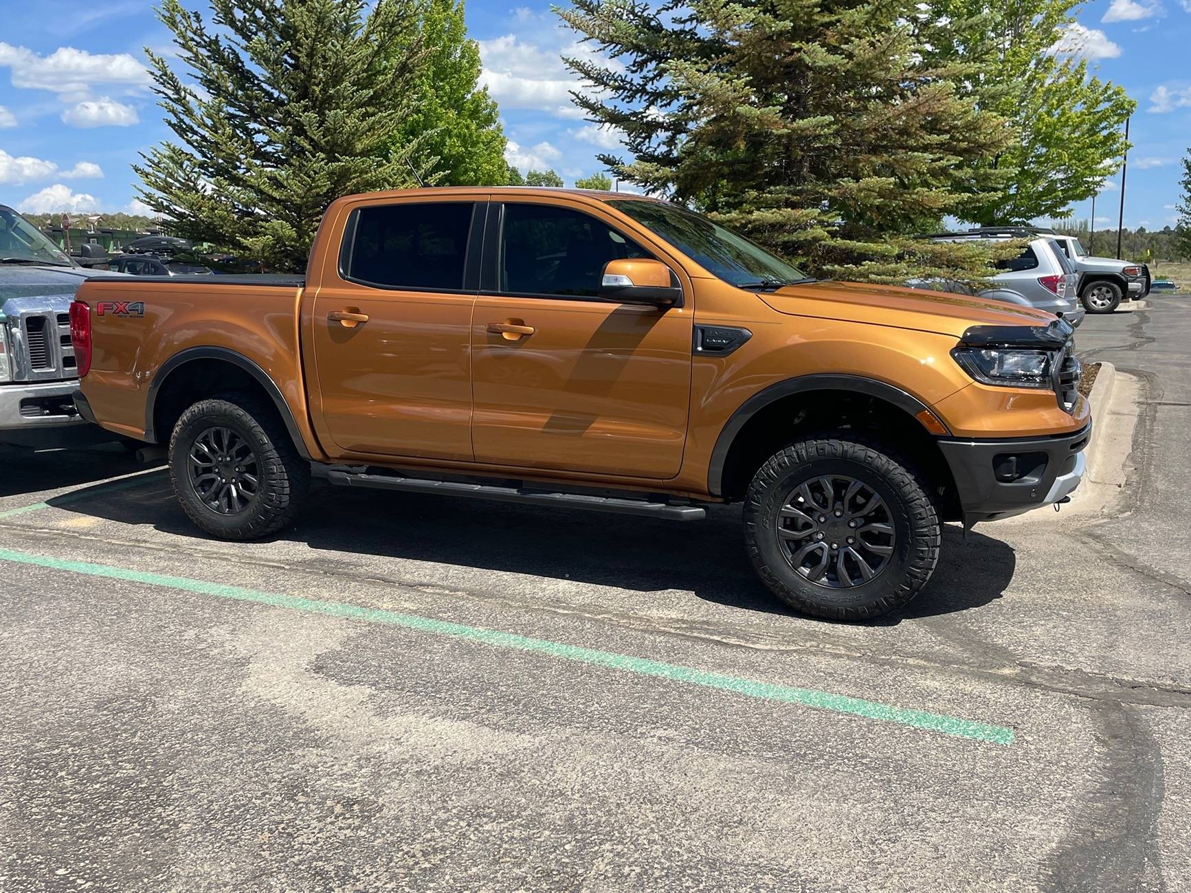

I "leveled" my truck with an Icon Stage 3 kit. This allowed me to run 33's with no problems. Got rid of the factory 18" rimes and went for aftermarket 17" for better tire selection. Couldn't be happier with its performance and looks.

Beautiful truck! mind sharing the cost of doing all of that? Might follow your footsteps

I spent right at $6K for the suspension parts, wheels and tires plus labor. The Icon Sage 3 kits is currently going for around $3K itself. Wheels and tires can vary depending on your preferences. but you can easily spend $600-$700 per corner. I went with wheels from KMC and Nitto Trail Grappler tires. Don't forget to factor in the small stuff like TP sensors and lug nuts. I paid to have the suspension kit installed, but if you DIY you well still need to get a front-end alignment. Hope this helps. Good luck.
