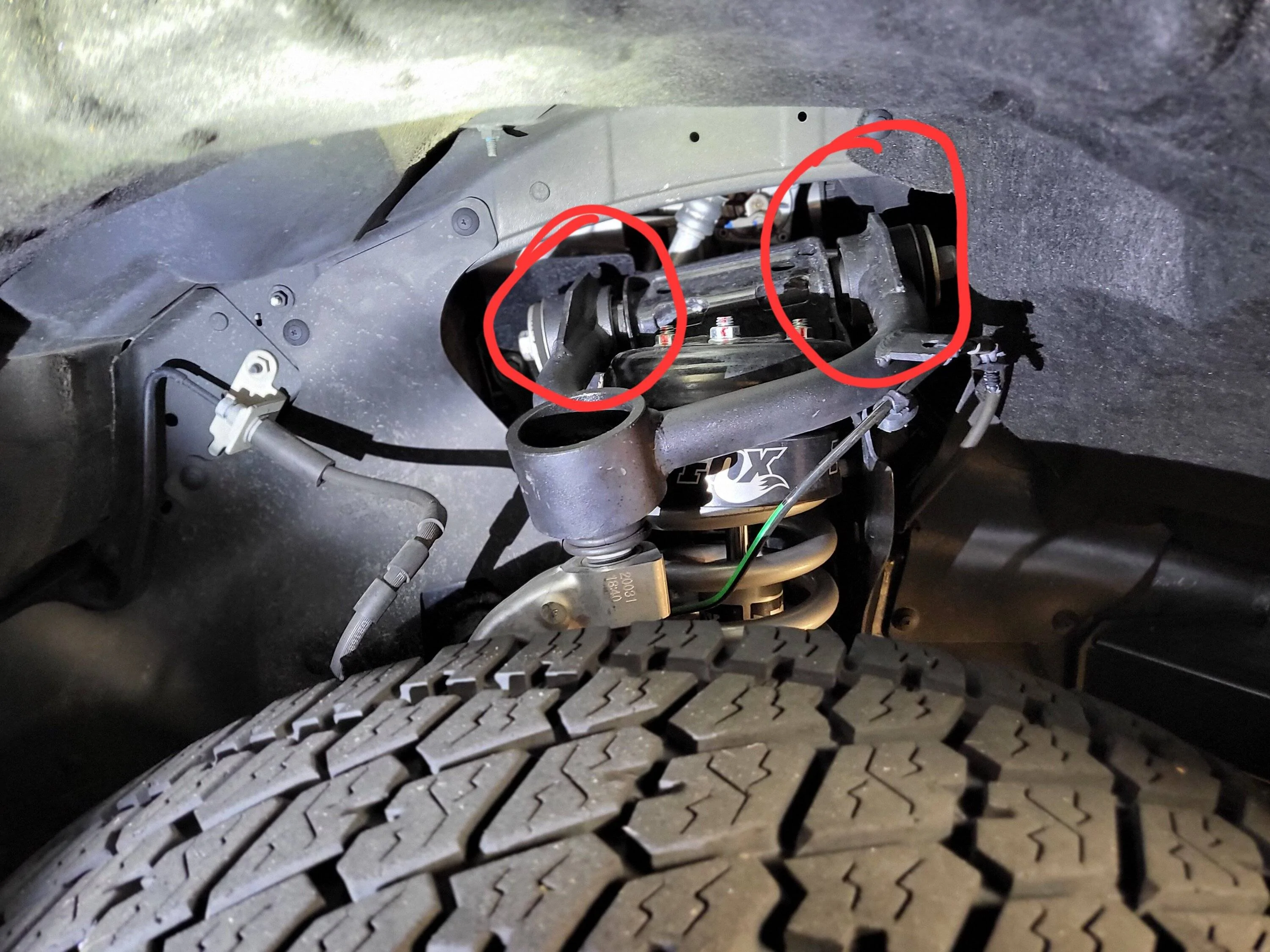

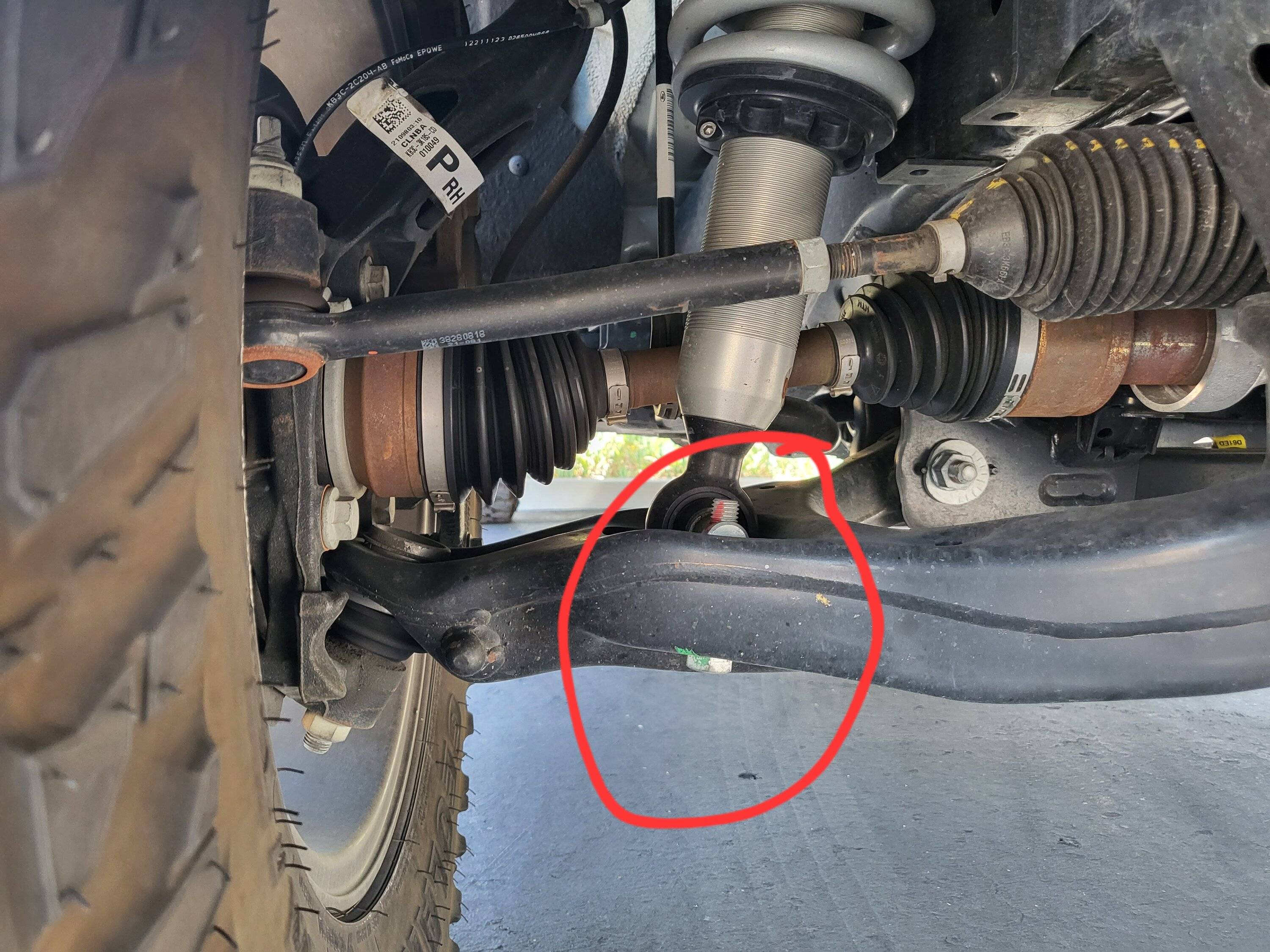

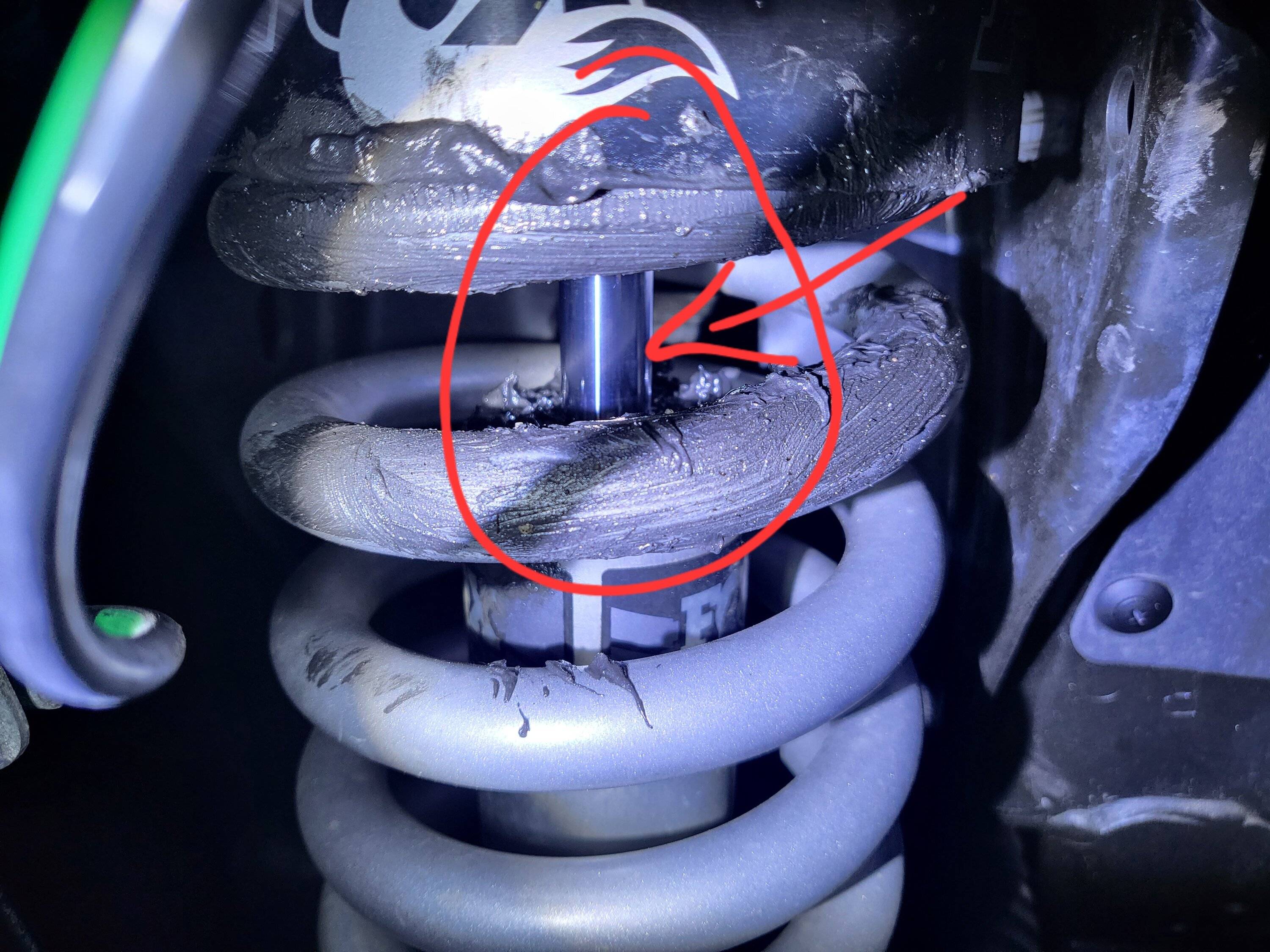

I had couple of squeaking noise and its all amplified by the tubular arm. (1) the long bolt that holds the UCA was loose, the (2) lower bolts that mount the coils over on the bottom attached to the lower arm was loose, I just re-torqued them. (3) the piston rod of the Fox shocks was squeaking as well, I used a anti seized grease and the squeaking went away.
And yeah, my tubular UCA is touching the metal flange housing of the shocks at droop, susperlift suspension said its due to the spacer, their UCA and lift is not design for the Fox 2.0. I'll be changing the coilover is months for Eibach since they can handle 3.5 inch of lift.

This is were all the squeaking is coming from and all resonated thru the tubular UCA.

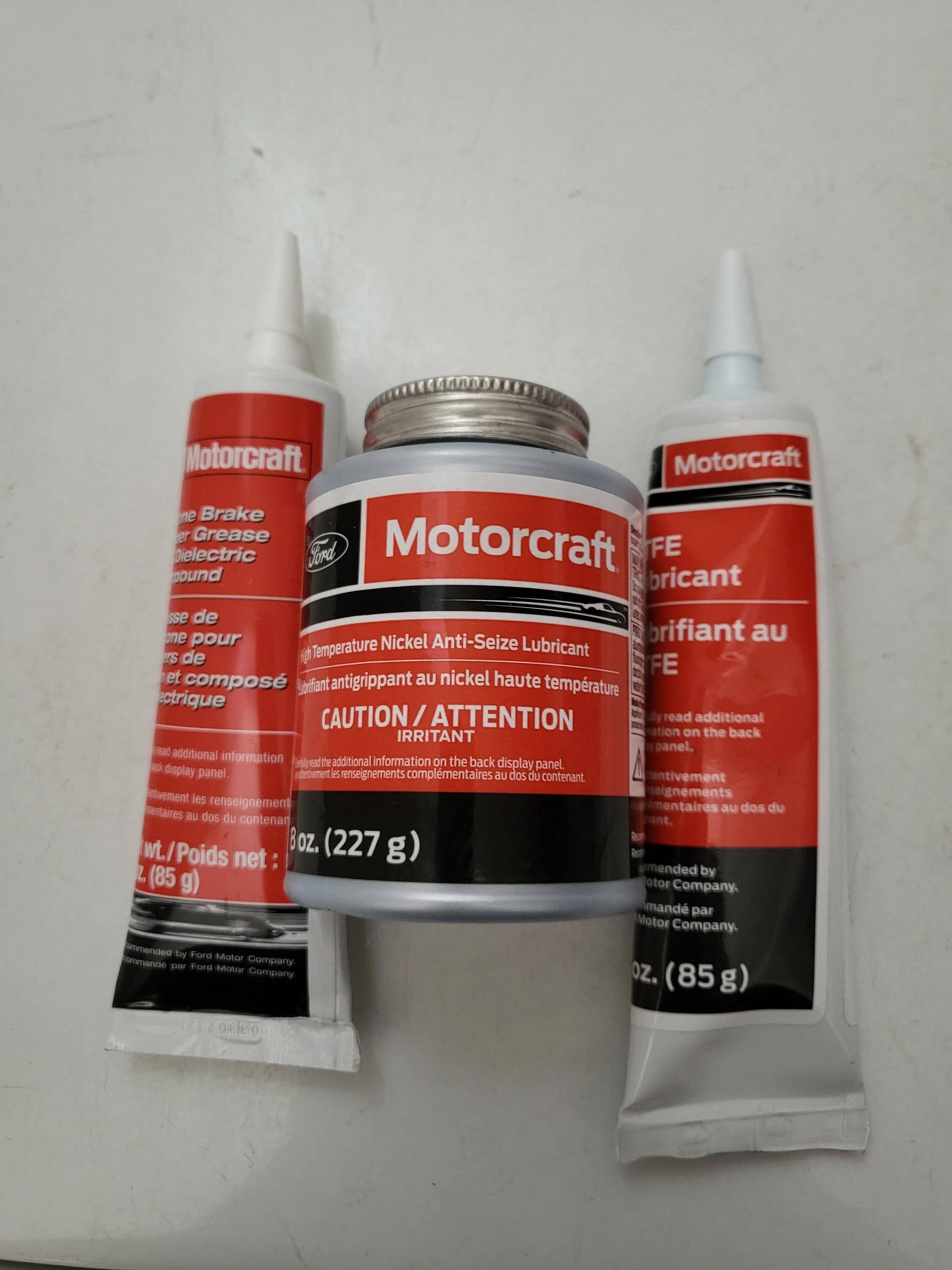

I applied anti seize grease from Ford as you can see on the piston rod of the shocks on the 3rd pics.
