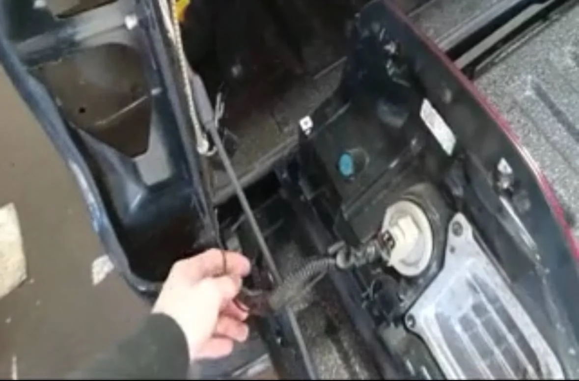

It depends on what wire they tapped, and I think that a bad connection (splice) here was disturbed and possibly corrected (for now) - it depends on if tech Inspected that splice for integrity.
The connection between the FCIM and the BLIS modules is the (MS-CAN network) shorting out and it takes out the FCIM (It what I think is actually happening)
Since I do not know how in depth the tech went into it, as moisture inside the BLIS module (taillamp) or wire splice shorting can create issues on the MS-CAN network.
If the issue returns - take a deeper look at the L-Rear taillamp and BLIS and really attempt to locate what that extra wire runs to, as if that wire is just laying somewhere disconnected you now have a (+) power source that is possibly grounding out and shorting the circuit.

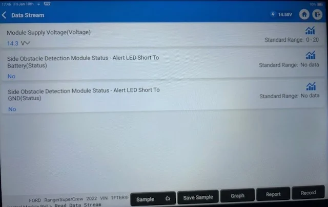

I confirmed today that yes, the module will read input voltage with key off, now the only variable here is I am hooked up with the Scan Tool and Communicating on the network.
So, with the FCIM being on a (Always Hot) circuit the module can read the input voltage at the connector. - (Module Supply - Voltage)
So, if you have a power reading here (providing) its good voltage and not below (approx 10.6) or so when load shedding comes into play.
The power feed is - GOOD
The (Ignition-Switch) status is the - Input that powers the FCIM up via the MS-CAN bus.
So, if the FCIM cannot see that message (Data) then it will not power up.
Engine Off - Door Closed, nothing powered - FCIM - Dead
FOB is nowhere near the truck - so the (KEY-IN) might be due to - I am hooked in with scan tool and communicating with the FCIM.
Not really that important - just note the (OFF)
Engine Running:
Note: When you turn the key to on (PB-ON) you see the (Run) indication, when you switch to (Start) you see that Run Indication also momentarily indicate (Start) until you release the (PB) or (Ignition Switch) then it indicates (RUN)
To point of this is - This communication is from the (MS-CAN) bus as far as the FCIM
if you are viewing this PID and not seeing the (Data) switching input then the (MS-CAN) network is the cause of the FCIM not powering up.
I decided to just use the SODR as a Ref PID:
Note: The SODL / SODR is switched power - so you will only see power with key-on, these are not power controlled by a Can-Bus.
I am unclear here - what specific circuit due to the wording of the PID as actually what circuit this is monitoring for (Short) - The Power or the Alert (Message) circuit.
I am thinking it's the (Power) side.
Anyway, for the Tie-In (PIDs) these are what you want to view for both SODL / SODR
So, I believe if you are having an issue with this circuit, it would show here and this short can / could cause the (MS-CAN) bus to pick up the bleed over within the (SOD) module.
Thus, taking the (MS-CAN) bus down and taking away the ability for it to see (Ignition) status.
So, the (Ignition Switch) status is the Key Important PID to monitor and then determine (WHY) the FCIM is not receiving it.

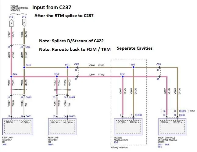

So, the issue lies within this diagram
Not shown (off diagram) is the MS-CAN bus wiring from the GWM to the RTM.
From the RTM the wiring is spliced (Via C913) and runs to C237, Wiring is (Good) as the RTM is working and communicating unless the splice at C913 is bad for the feed to C237
So, thinking that is there was an issue with anything on the network (short) it would take out the whole bus, that's not the case as the RTM is still communicating.
So, with the posted faults - I see from the PAM & BCM - Lost communication with the:
Lighting Control Module Rear - (This is the TRM) so the TRM is also down (Bus)
So, this means that the - FCIM - TRM - SODL-SODR are bus dead.

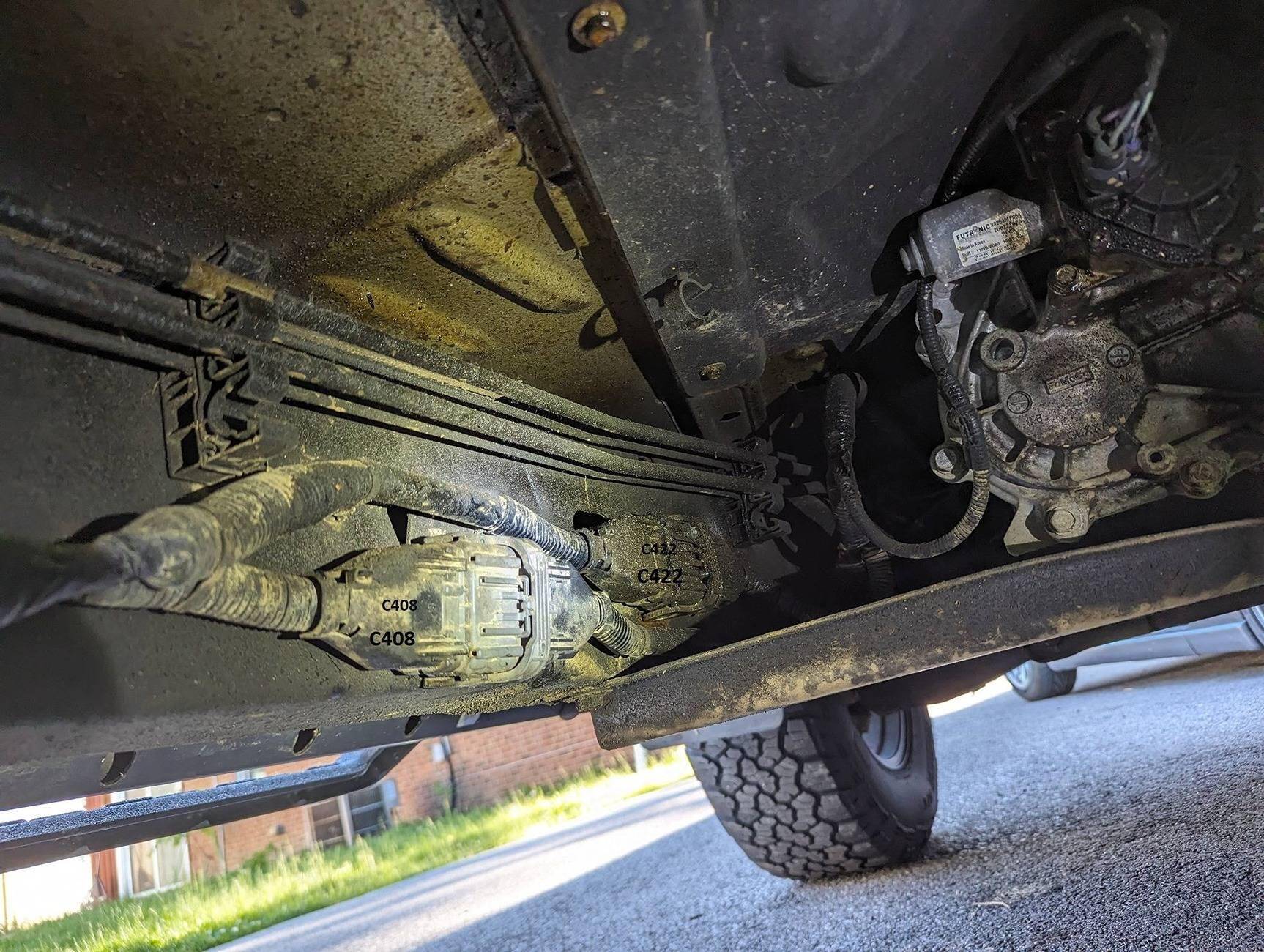

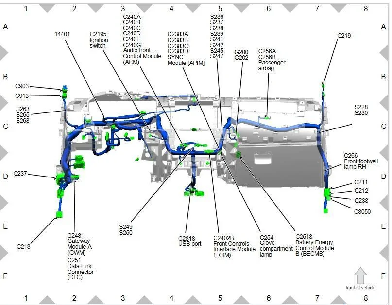

I really (Suspect) the issue is at C237 or C422. (Moreso C422)
C237 is feeding C422 and Downstream of C422, the circuit is spliced for the FCIM / TRM and fed back into C422 over to a splice feeding the TRM and then over to C211 (Feeding the FCIM)
Note: C422 contains 4 (MS-CAN) wires In for the BLIS and back out for the TRM / FCIM
Pins: 33 & 34 ----Pins 31 & 32
So, with this knowledge -The issue lies between C237 and C422, so try reseating both connectors
The issue is with the (input) wires coming from C237 to C422 (Pins 33 & 34)
Due to the fact that the SODL / SODR are also dead.
If the connector reseats do not fix the issue, then wiring checks are needed, and also look at possible bad splices at S414 & S415
C237 is located in the Drivers Footwell:
59 Cavity Connector - so its big
And again C422
You are actually spot on. It didnt happen right away but on the drive home the tpms lost communication and gave a warning on the dash. Also before i dropped it off at the dealer i lost all fob function. Had to manual lock and unlock my car with the key.
