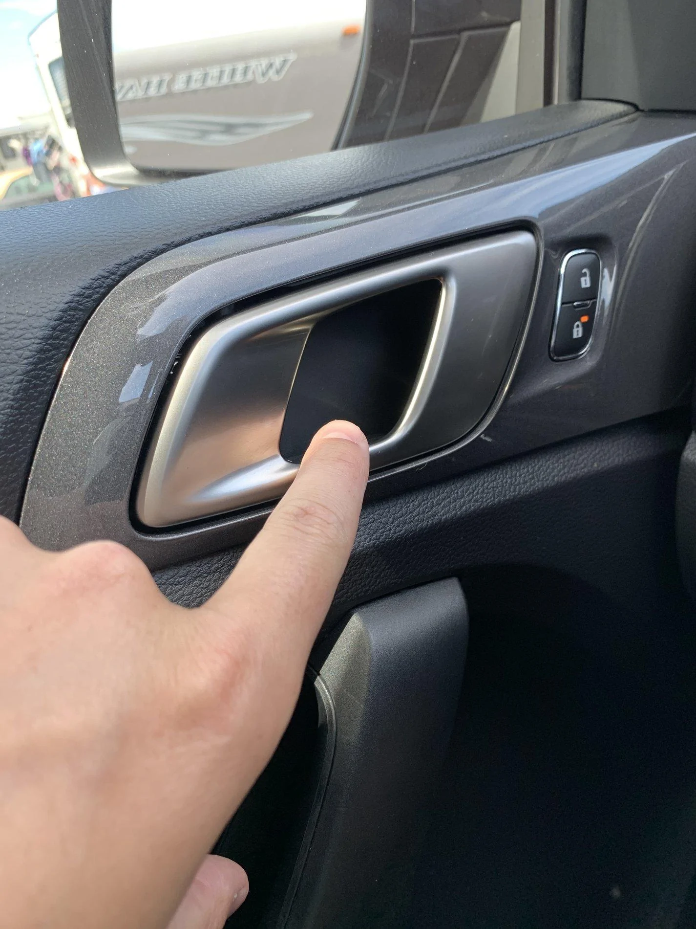

I had this insert piece come lose behind the door handle.

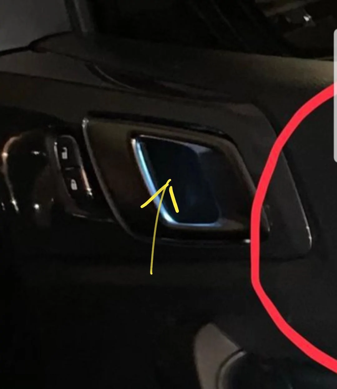

I see 2 screws at the bottom of the panel... is that it? then everything is clipped in?

4 total screws. 2 at bottom, one at door handle (to open door) behind the little piece of plastic and one under the big plastic piece under the big handle part in the middle of the door.

Are there any diagrams or pics showing the 2 screws I cant see? Would prefer to not break something trying to force it out, thanks in advance!

Both behind the plastic piece. Have to be really careful. The big door handle part I start where the curve is in the middle by the hole underneath.

Sorry to be dense but I dont see how to do it. I don't have anything that can pop off what I think you're referring to without destroying it...are there any parts diagrams somewhere?
