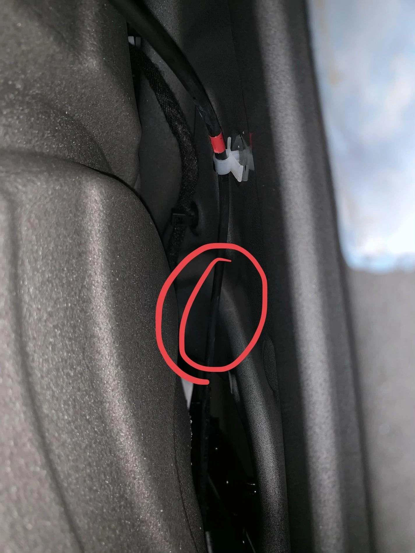

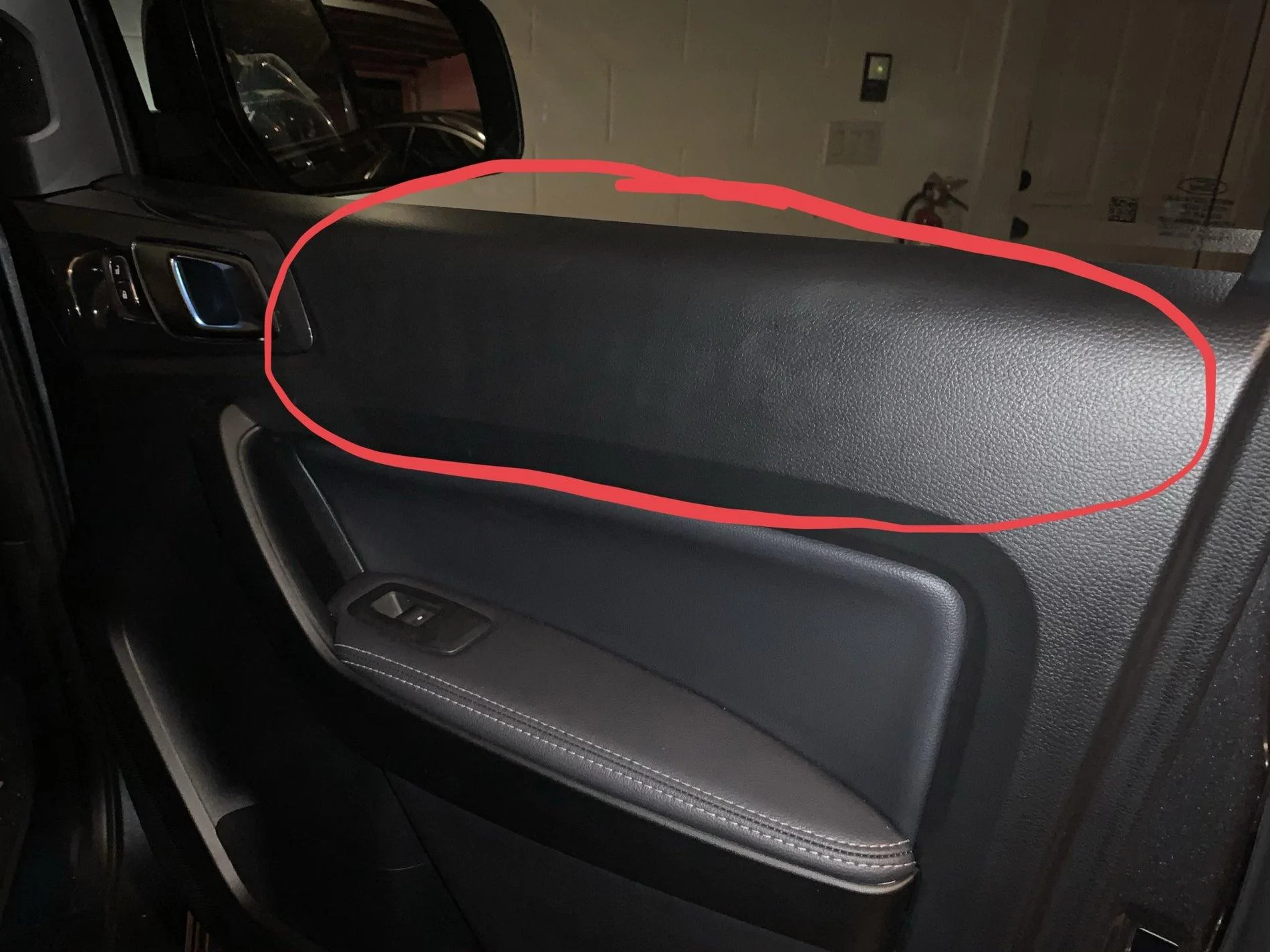

I have an annoying door panel rattle that happens when the volume is up a little or I hit rough road. It’s very annoying. I located it to be behind the top part of the door panel on the passenger side. Does anyone know if there are instructions to removing the panel so I can get behind it? I figure it’s loose adhesive or something. Not sure but definitely want to take care of it. When I press on the part circles in red, the noise goes away but when I release it the noise occurs again.

Lol. That’s where it was hitting so wanted to cover all the areas. Haha. That rattle was sooooo annoying
How hard is it to pop the cover off? I have a similar rattle and would bet money it's coming from the same thing. When certain bass tones hit, even on lower volumes, I get a light rattle coming from somewhere in the door. The last think I want to do is screw up my paneling thought. It's a Lariat model if that matters. Any advice on how to do this is appreciated. Thanks!

Hey there. Wasn’t too hard. Undo the 4 screws and then popped it off. You have to pop off the top speaker housing too. Also hold the window trip piece where that meets the plastic door trim. I had a little noise from that too. What I did was found a low base sound on YouTube and plugged in my phone and played it and pressed on certain spots to find where I needed to focus my efforts then went in after it. Lol
