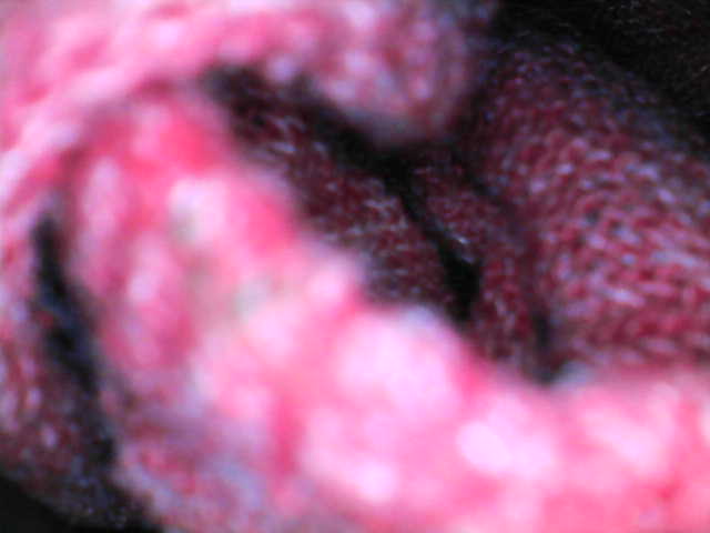

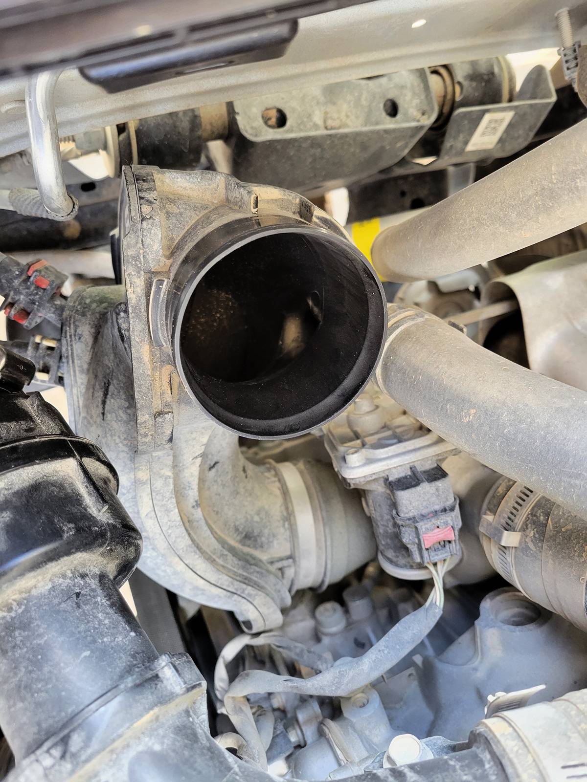

Count yourself lucky it didn't make it all the way into the turbo! Orp you would be looking for one of those.
The rag was at the turbo inlet but even if it was resting against the veins, it's highly unlikely there would be damage. The rag would probably just keep the shaft from spinning, which in part may have been the case. Since it's the exhaust that spins the shaft, it would just sit stationary. Turbos are pretty tough
Next step is to get the MAP sensor on the intercooler wired then get a proper calibration on the new throttle body.
My thought would be that if the turbo was stopped from spinning it would have caused enough exhaust backpressure that the engine would not have run at all unless the wastegate was pushed open. Still hard to believe with that much intake vacuum it ran.
I suspect the rag was at the inlet but not against the veins, allowing only a minute amount of air through. Didn't investigate further after pulling the stupid rag out.
