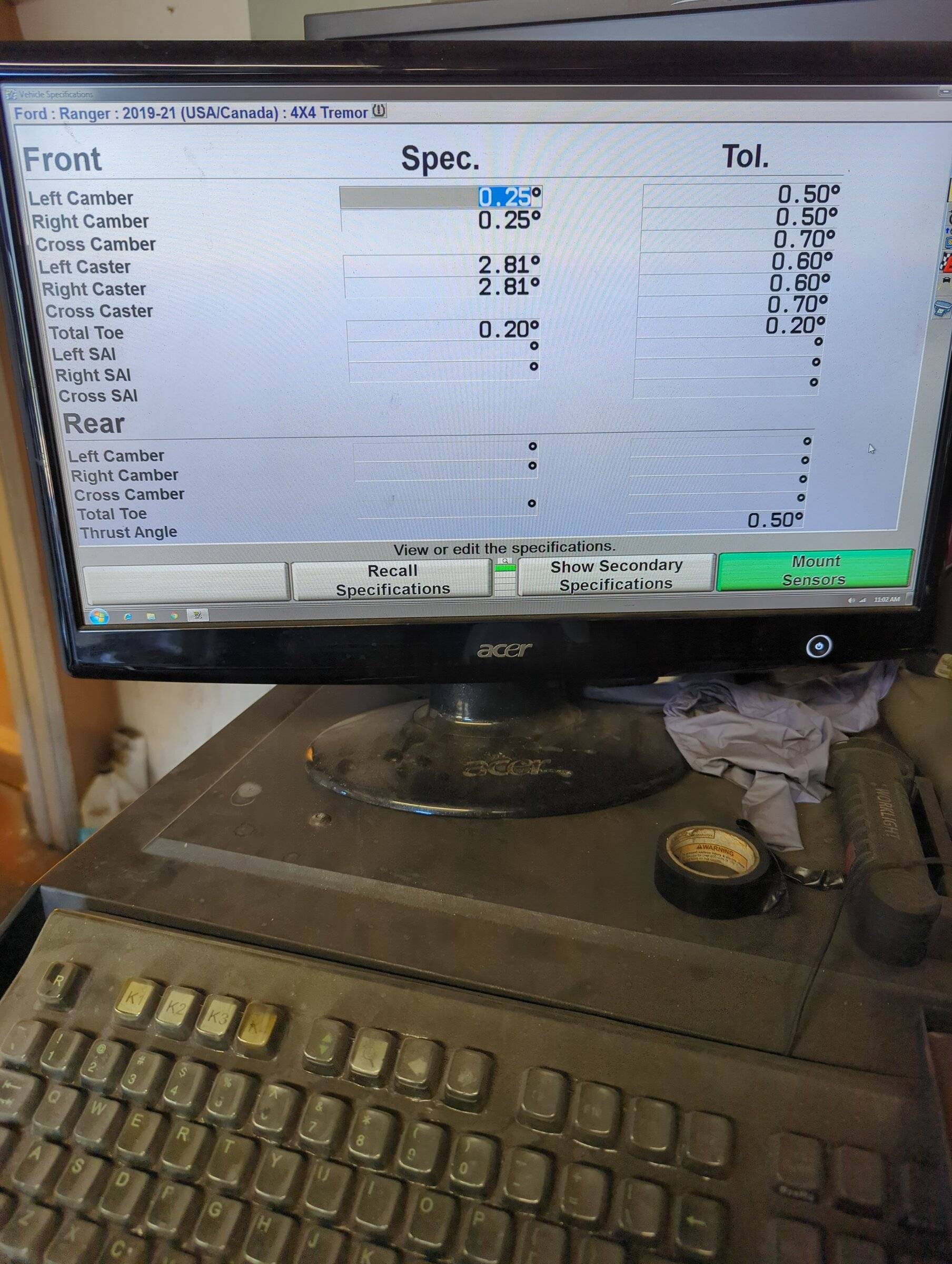

Hello,
Since it seems so hard to find shops with their alignment software updated, my buddy sent me the specs off his Hunter alignment machine (Central Tire Service #5 In Inglewood, CA). Seems like Caster and Toe are a little different than the normal 4x4 specs.
