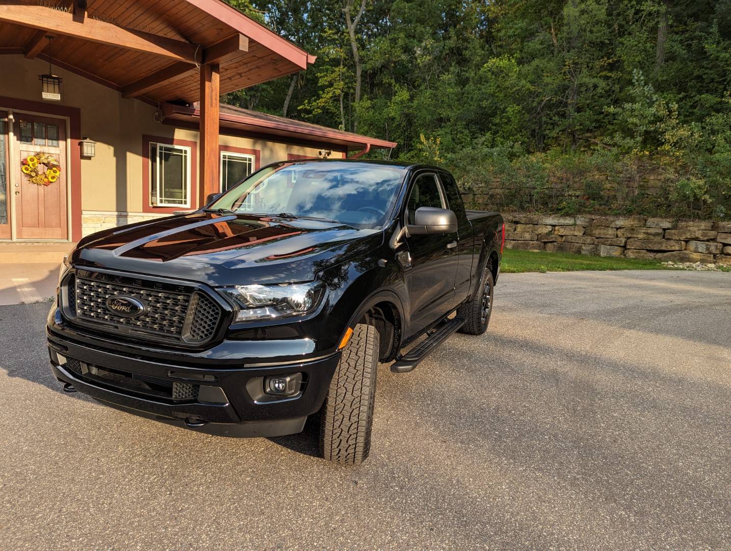

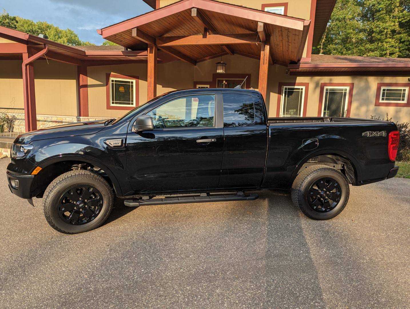

My plan was to order a new Ranger maybe next spring. I'll admit I have not been following the Ranger development that closely and was unaware that a new gen was coming out in '24. I wanted an Extended cab as I find a 5' bed too short to be useful and don't really need 4 full doors. 6' is at least a better length. I am coming from an 8' bed F250 but looking to downsize while still maintaining a decent level of utility. And then I found out Ford went and discontinued the Extended cab for 2024.
Jerks. So I scrambled around to find one of the few remaining 2023's that I could and ended up getting one out of state as I really wanted heated seats (very hard to find in this model on the SC) and the tow package.... Well I got one out of 2. Couldn't find one with both so I ended up with only heated seats.
So I was referred to this site from someone on another forum and have been reading a lot to catch up. My plan is to add the Ford OEM hitch and the Ford version of the Redarc TBC system. I have some "Ford bux" in my FordPass account from the Ranger purchase to help offset part of this.

A couple pics...
