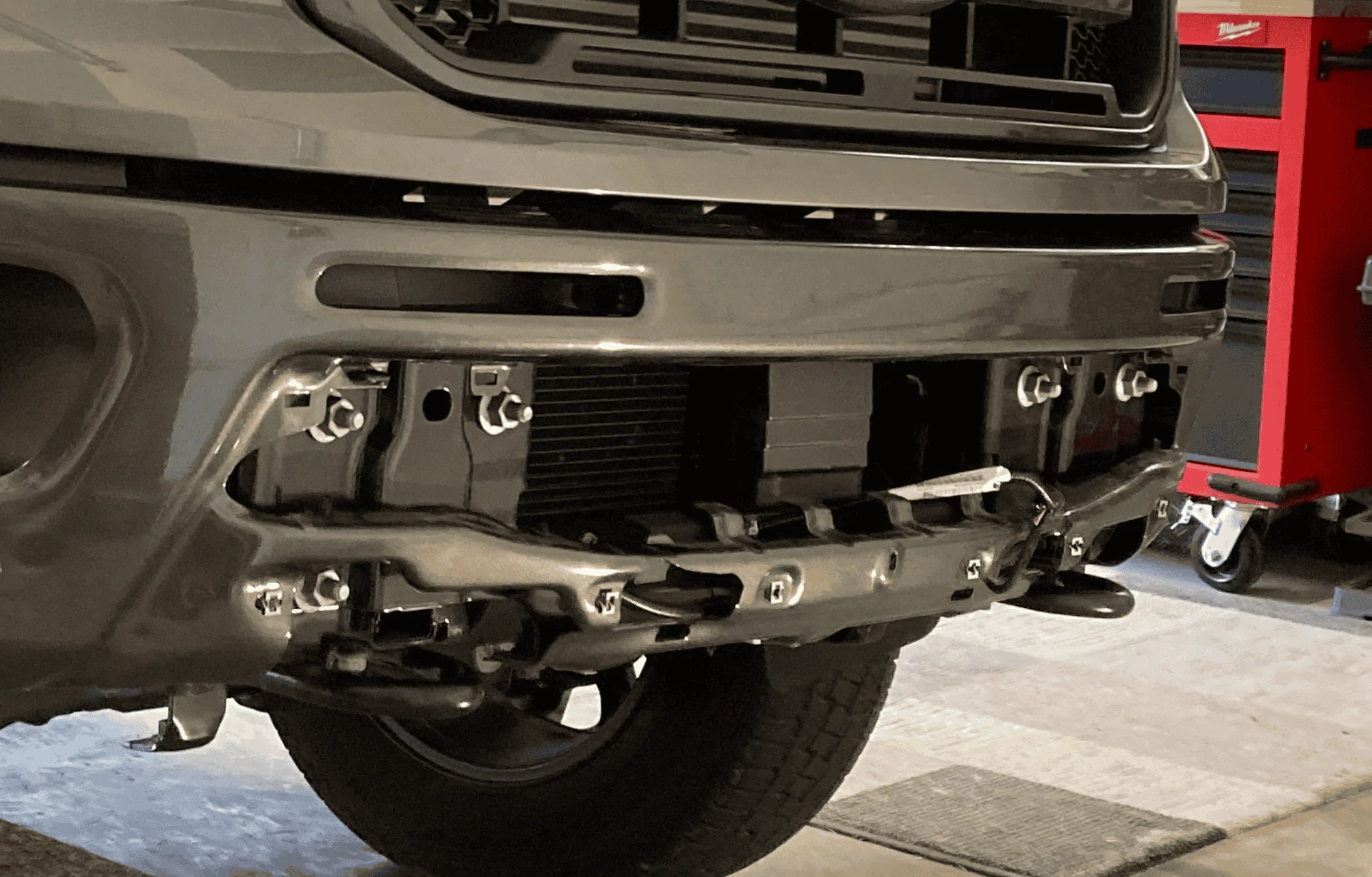

This was a good catch, and your eyes weren't tricking you. The rubber strip that separates the bumper above the fog lights are positioned slightly differently on each side. Not sure I'll bother getting it fixed, I barely notice it in person.
If you are handy its a fairly easy fix. IT does require popping off the front lower plastic valance. Thats just held in by friction clips, a good trim removal tool and its off in a couple minutes.
then there are three nuts on each side that hold the bumper to the frame. loosen them a little and there is quite a bit of up/down play in the bumper.

Sweet, thank you. Didn't realize it's an easy fix. I'll definitely do it.

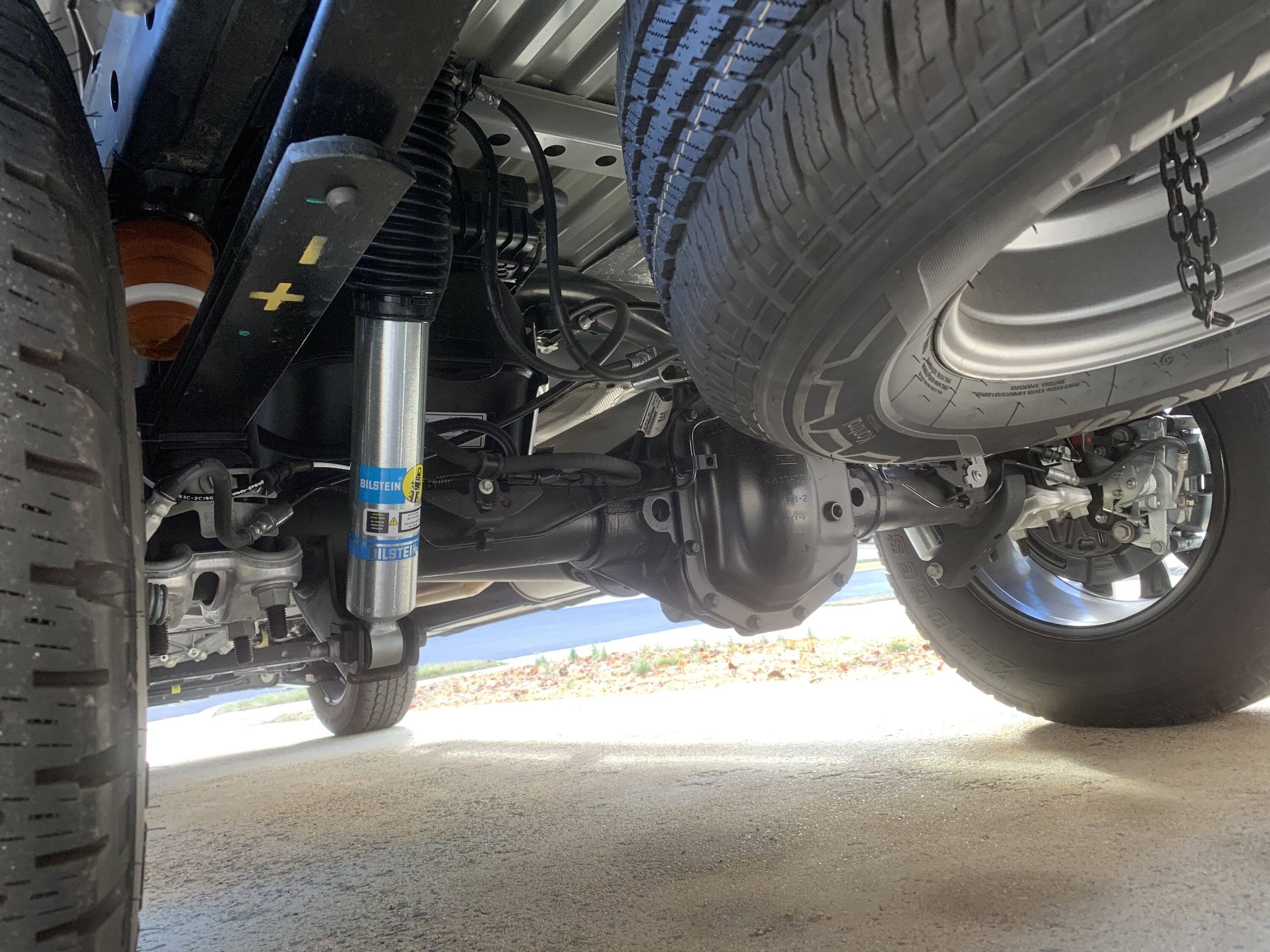

Have you taken it for a ride? Did you notice a difference?
Yeah, made a noticeable difference. The rear end isn't nearly as squishy/wallowy. Good $200 spent.
Good to here. I have been thinking about doing that myself. The rear I can handle easily, but I'm nit sure about me doing the front.
It's definitely worth it. The rear end feels way more planted. You don't even have to jack the truck up to do it. I'm happy with the way it rides now and probably won't bother with doing the fronts.
