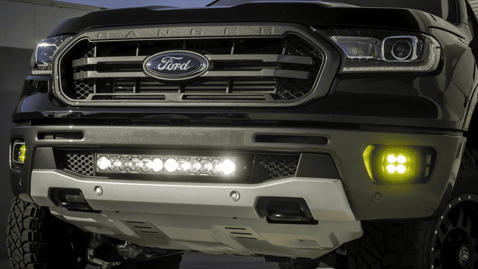

Because it makes a cool photo.
This seems pretty practical. And again, total cost here is less than most of the BD fog light setups you see on teh socialz.
Can I run these on the highway with oncoming traffic, or in fog or snow?
The point is - the answer to “which lights should I get?” Doesn’t have just one answer. It has a lot of follow up questions.

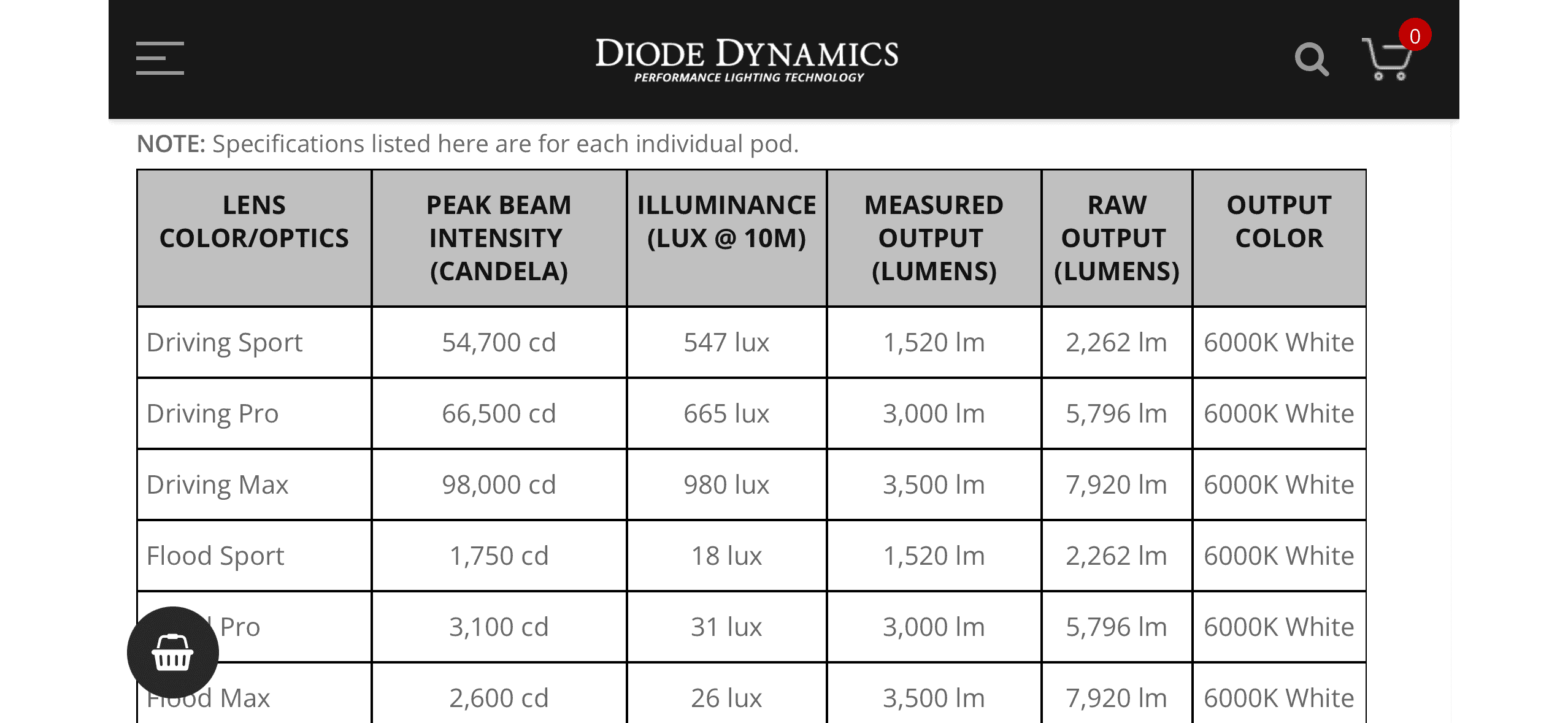

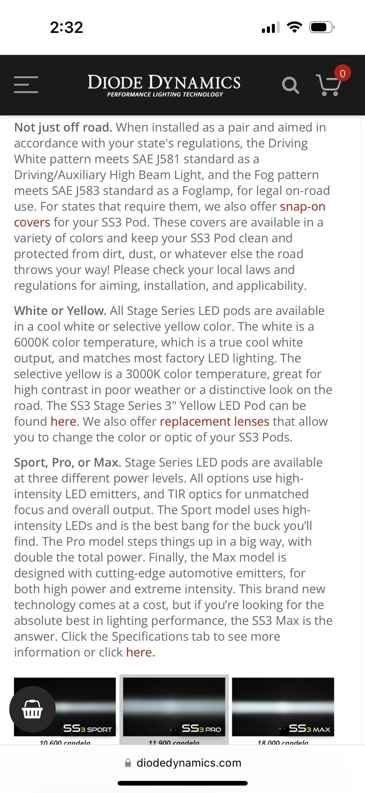

When I was researching lights, I did find this:

So DD doesn't provide a lux distance, which is always a warning sign. Lying through omission, and all that.
BUT, BD has tested them as part of their new effort to lie a little less. Well, they haven't tested the SAE versions as far as I can see, but they have tested the SS3 Pro Spot. It does 450yds. The SAE is likely half that or less.
450yds, in amber, would be a decent fog light for driving very slow in very difficult conditions, provided they have a good vertical cut off. But in that whole time/distance/speed thing, you're getting 14 secs of vision at 65 mph. $250/pair at current internet prices. Not the worst I've seen, but probably not enough performance to really make them life changing.
And let's compare that to the Rigid D Series Pro Spot, which only provide a pathetic 270yds at 1 lux for about the same price.
And the BD Squadron Pro which does 340yds, again in same $ ballpark.
And the Lightforce Rok40 spots which do about 200 yds for $185.
Winner of the silly little pod light shootout: Diode Dynamics.
