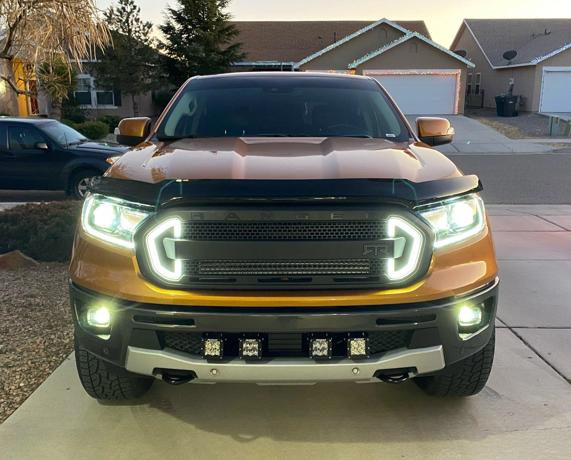

Gecko... where did you find an opening in the fire wall? Is there a gromit there to push the wires into the cab?
Thank you
Made my own
Went through on the passenger side, the ranger has too much crap on the drivers side under the hood. Couldn’t find a place on the drivers side under the hood that I liked under that mess.

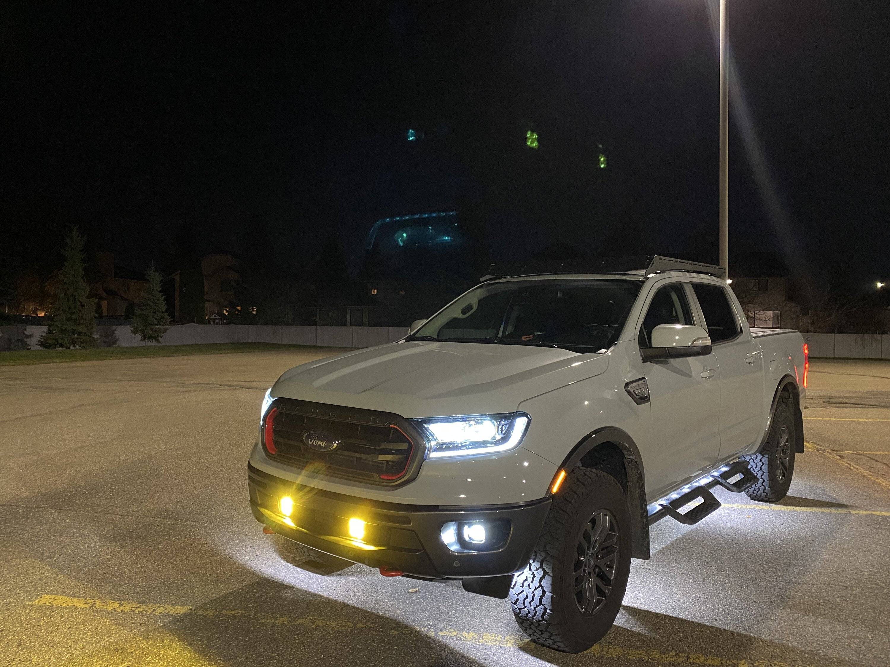

Had some people notice and ask about my install.
This was the first mod I did. 4 pods installed below the bumper.
been running 6 months. No blockage or issues with the adaptive cruise or pre collision assist.
I used the universal mounts that came with the lights. I installed them where the push pins are for the bumper trim. Remove the pins and used the nut and bolts from the rigid kit. Very easy mod. I would recommend taking the grill out or if you have long arms the top cover and middle insert for the grill out.
Ran the wiring harness through the firewall on the passenger side, spliced the harness to lengthen it a few feet. Couldn’t find a good spot on the drivers side. The drivers side is incredibly cramped under the hood. Upped the fuse to a 30amp.
The 2 outter lights are floods and the inner set are spots. Bright AF. No issues 6 months later. Don’t be a dick and drive with these on around traffic.

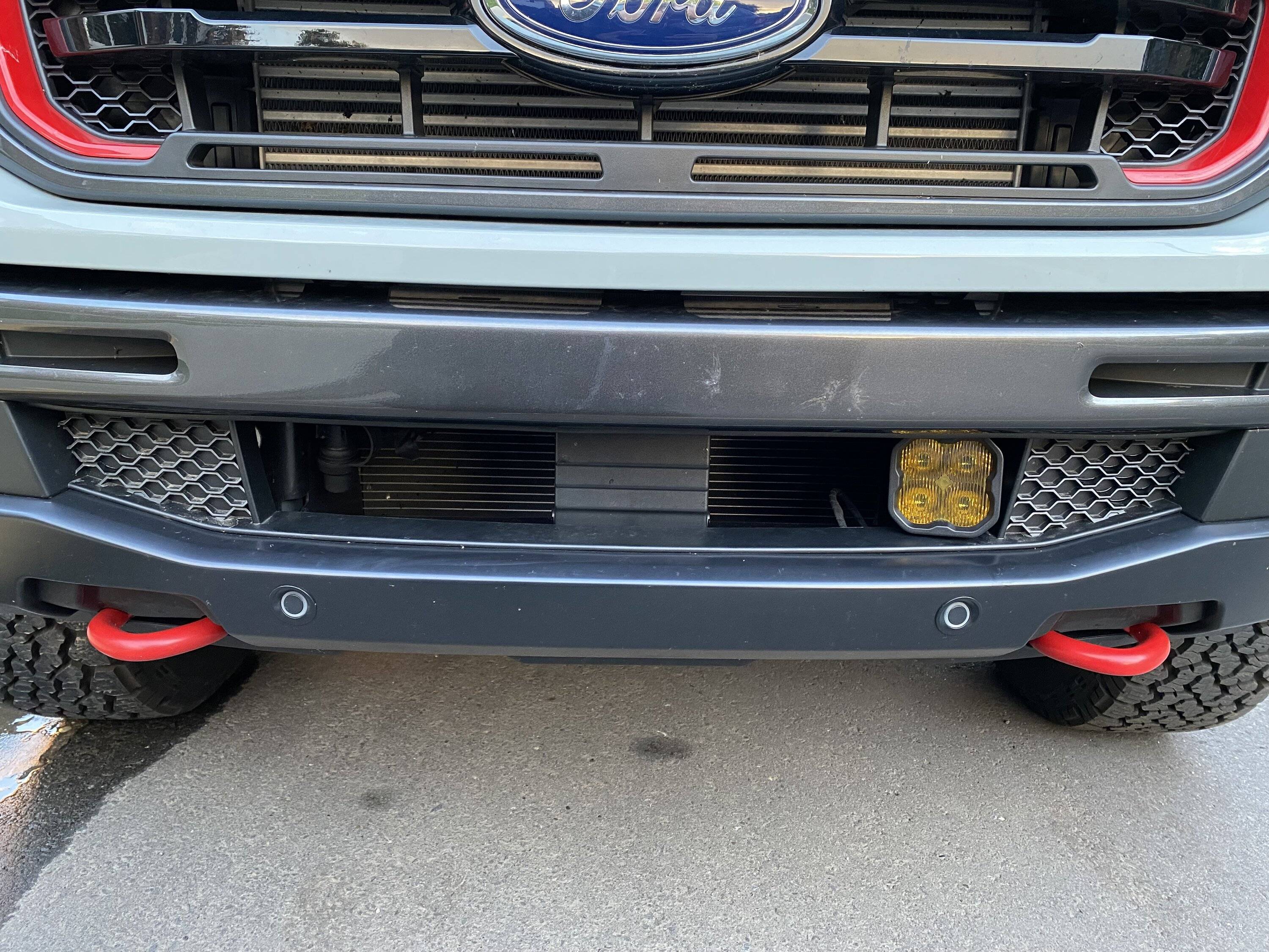

Ok.thanks. is there enough slack to adjust up /down. Did you tap it to your high beam switch?
There is enough room to adjust.
I have a Tremor and I used one of the upfitter switches for this. I also ran an extra set of wires to the same spot should I want to add a second set in the future. There is plenty of space for that and not have worry about adaptive cruise control radar sensor.

ok last question , did you bolt it on those push pins that are in thr upper side ?
I did not. I wanted the lights recessed so they were flush with the trim. I used three pieces of 1x1 aluminum angle. I mounted a vertical piece to the bumper brackets to the left and right of the opening. To those, I attached a horizontal piece.
That's how I mounted mine...that grille trim isn't going anywhere lol...
