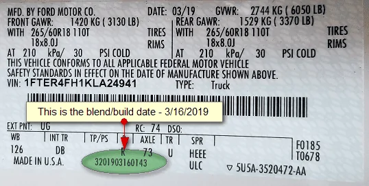

Lariat 2wd (18 inch) MFG 2/19 - How can I tell the exact manufacture date to know if I might be in scope of TSB-19-2052-2019?
