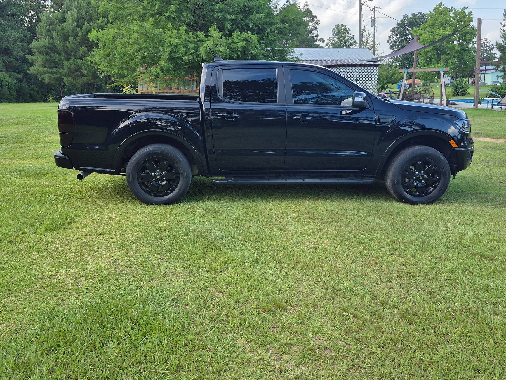

I did longer shackles and yes they hit the exhaust tip turn out. In my case I flipped the axle and needed the longer shackles to bring the rear back up some. I didn't need the extra payload however but this didn't change ride quality any.
I cut the turnout just behind the resinatior and welded in a piece of 3" exhaust tubing about 12" long. It will need a slight bend maybe 33° on the resinator end. That places the pipe just behind the hanger, still looks stock.
