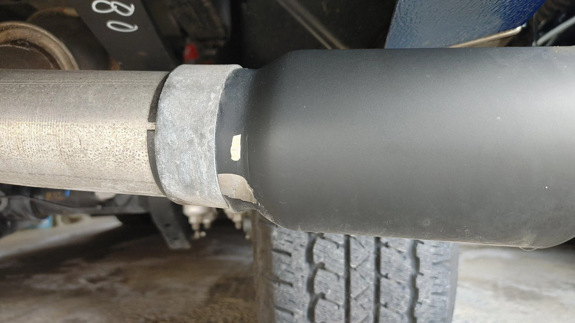

how is yours holding up? ive had mine on for about a month and the black finish is coming off. i emailed Go Rhino about it.

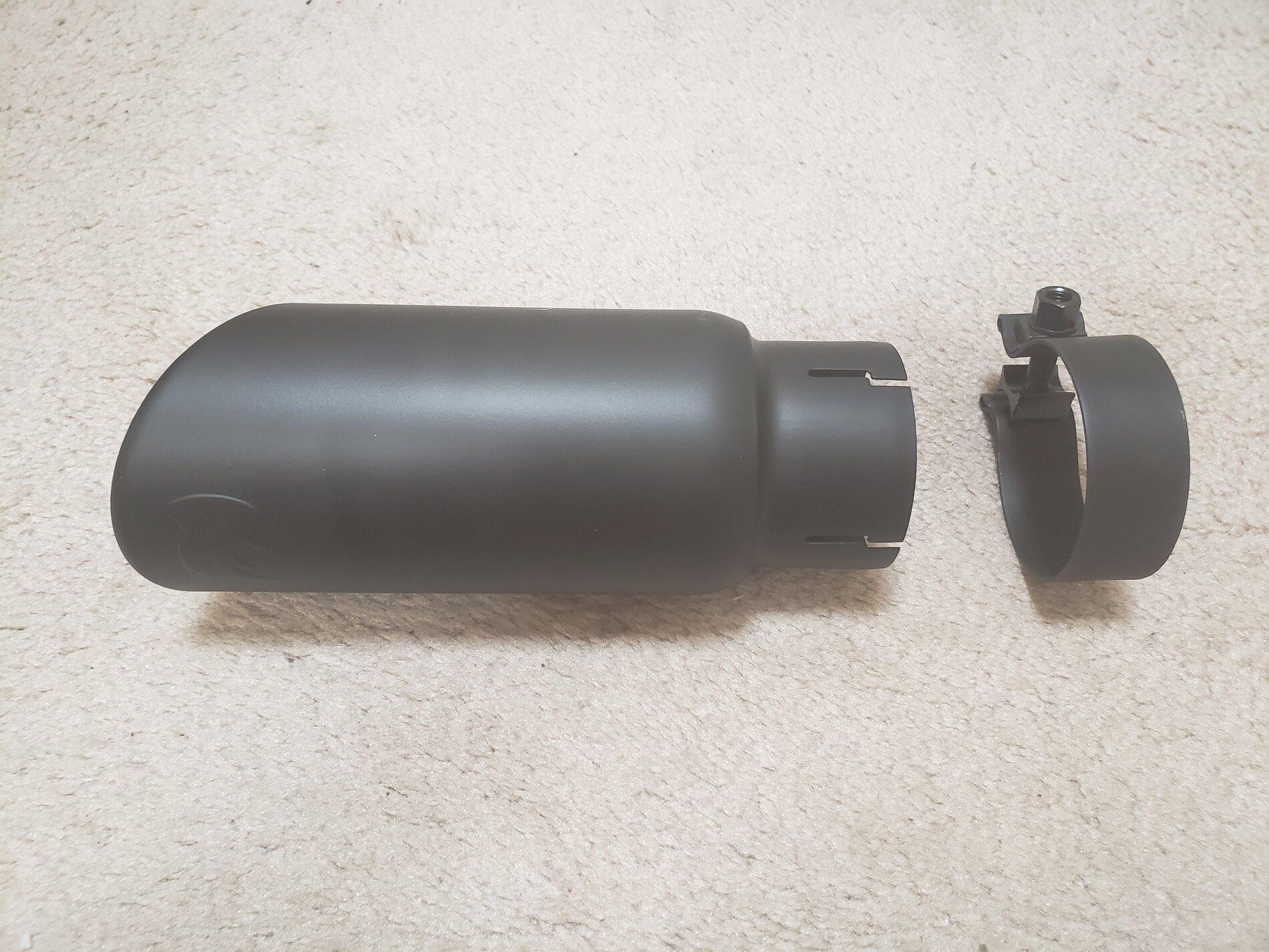

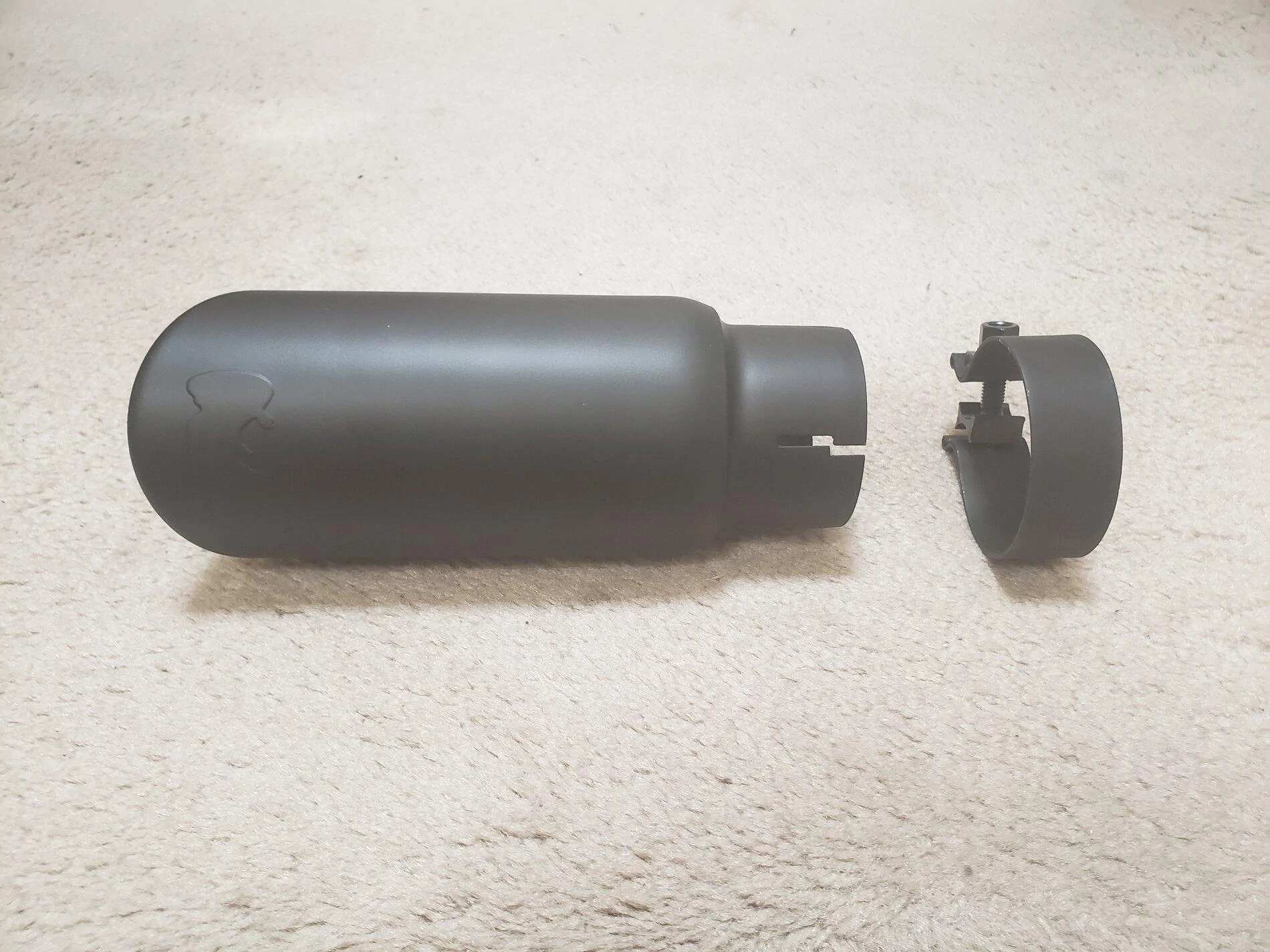

I just got mine yesterday, 3" inlet, 4" outlet, 10" length (GRT3410B) the same as yours. My clamp is black but your looks white or did you coat it with something? Maybe I have a different version of the same model?
Also, I will be following this link to see if any continuing problems with paint finish coming off. I might wait for awhile and monitor this issue before installing mine.

my clamp WAS black.. it looks like that now.. not sure why, i just washed the truck yesterday.

Go Rhino is sending a replacement out, this is what they said:
"This normally happens when the exhaust tip is used as an extender which is not what our tip is designed for. I can not tell if this is the case here because of the photo but I think this is the issue. The tip should slide as far as possible on the exhaust tip.The end of the pipe should be near the opening of the tip. We can send out a replacement all we need you to do is click on the invoice and send us a screen shot of that."

Glad to hear this. When I called Go Rhino directly before buying the Tip, tech support told me to install it this same way as you described with the tailpipe end flush with the outside of the Exhaust Tip and not extended out beyond that. But he did not explain why to do it as such. I was going to use mine as an extender but will instead install it according to their specs. Great to hear that they will back up the product. Did you buy directly from Go Rhino? I got mine from AutoAnytime.

i wonder how the finish is applied, i just did a quick search on powder coating, it says is good up to around 400 deg, then i saw something about "can you powder coat an exhaust" that said No, that can get up to 1200 deg, i assume thats not at the tail pipe. but if they are powder coating this tip, thats not the way to go. i may take the old one and use some high temp matte black paint on it to see if that would be better. since i will have spare anyway.

description on go rhino's site says the black tips are powder coated. some one needs to get back to the drawing board :D
