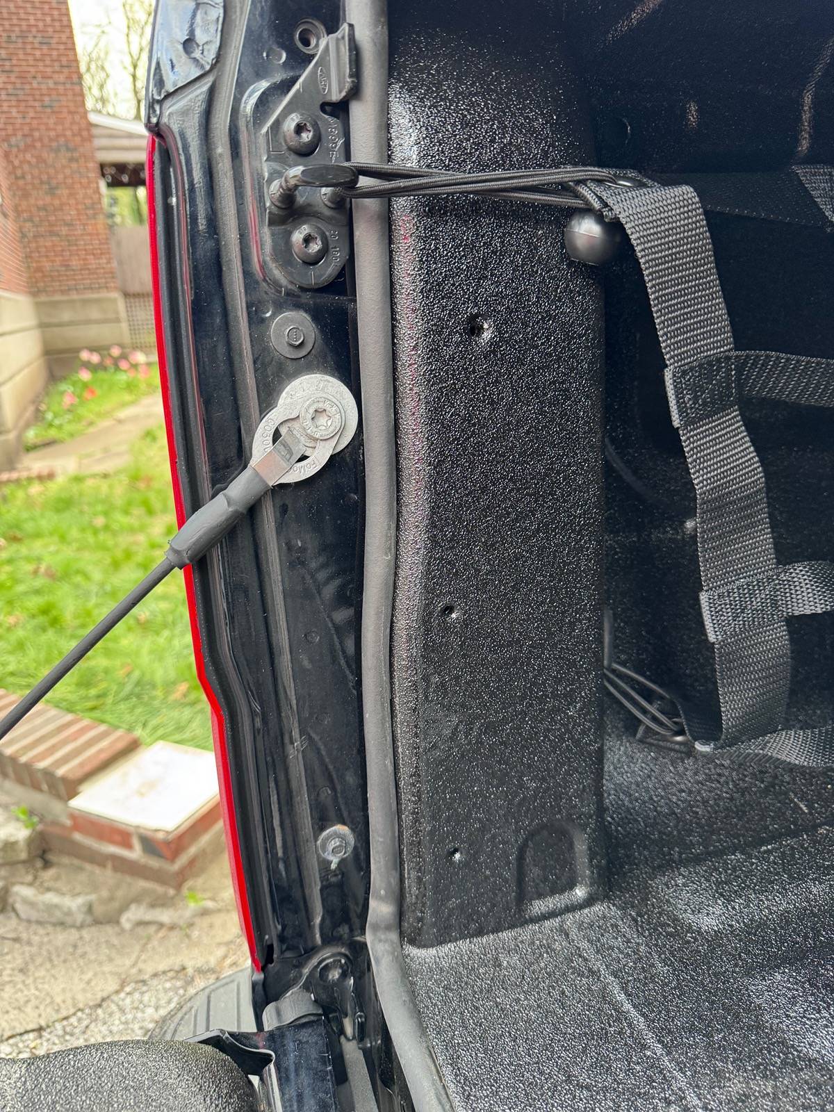

Anyone know the thread pitch of these holes in the back of the bed. I just want to install some tie down. The spray in bed liner makes it hard to just test different bolts.

Those look like mounting points for the swing case. Some folks on here will know but you might also check online for the swing case installation guide - it might have that info.
Also, members have used a tap to clean out those threads with good results.
M6 x 1

I had to tap all of mine out after getting bed liner. You may want to start with a drill to lightly clear some of the material right up to the threads, then hit it with a tap.
