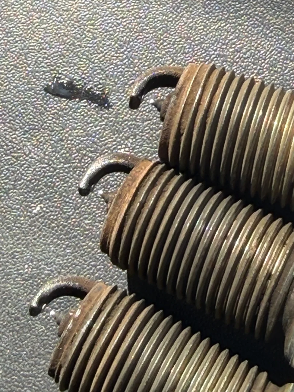

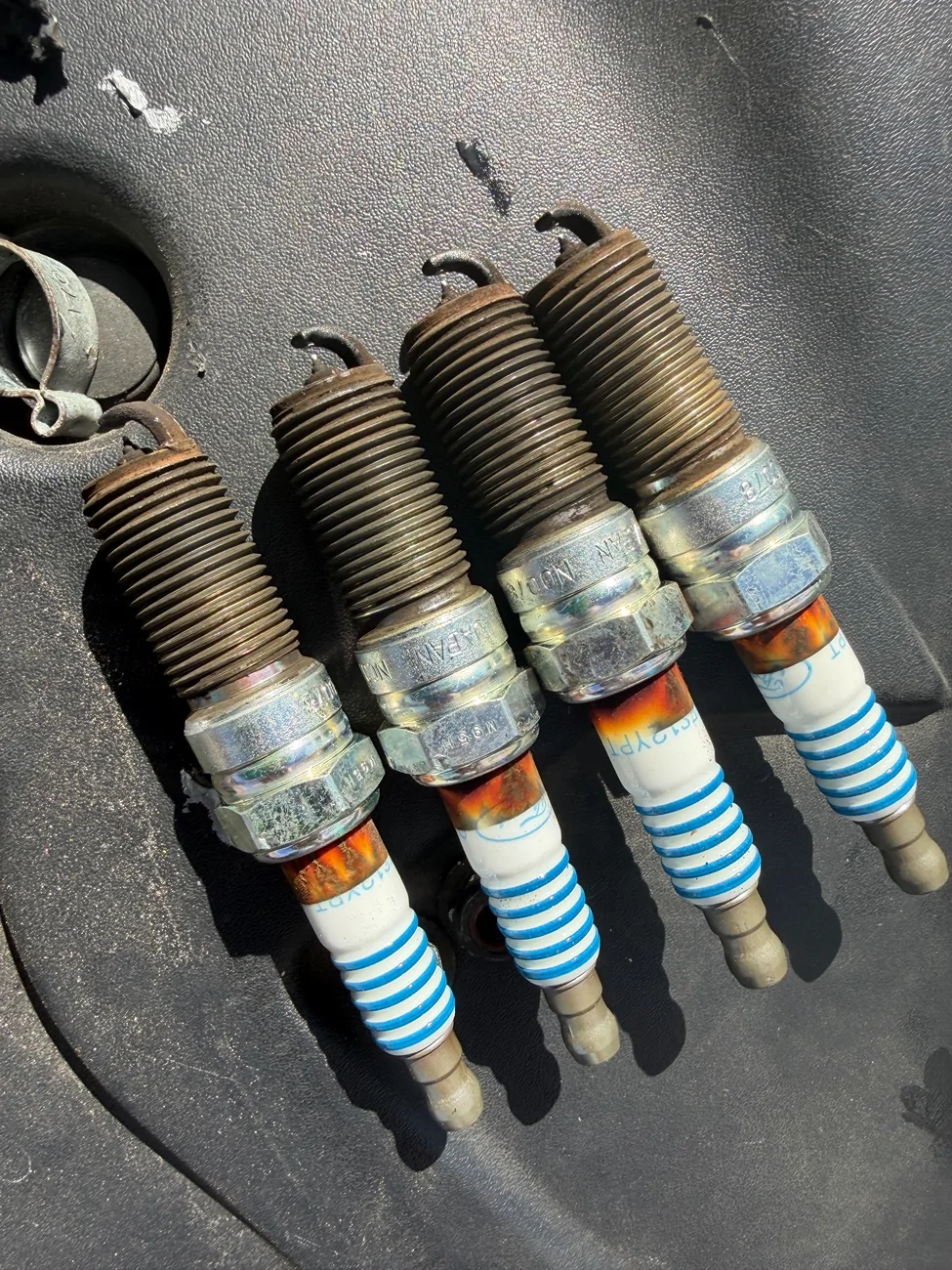

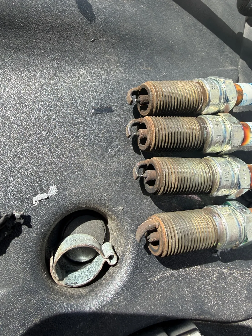

I replaced the plugs and she’s running smoothly now. There’s no sign of water intrusion. The plug boots look brand new. I also noticed that the fan clutch hose had deteriorated at both ends. I replaced it with a new piece of 3/8 fuel line and zip-tied the electrical wires with zips.
I’ve attached pictures of the plugs. They look a bit worn out but I’m still surprised that there’s no CEL light! Thanks everyone!
