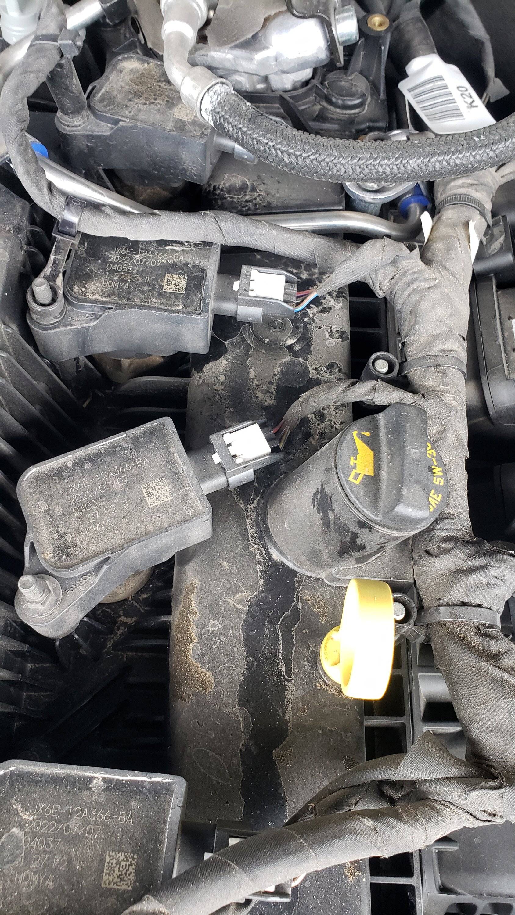

Engine bay is clean. A little AZ dust but no water evidence and no chewing.
It has been producing a little more exhaust moisture in the morning on start up. That shows up as steam from the pipe and a dribble of water on the ground. Odd for Arizona because "it's a dry heat" but then we have been living with perpetual rain out here for a while as an atmospheric river has given us TONS of storms and showers over the last few weeks. Lakes are rising and our snow pack is at 156%. So my assumption has been that the tail pipe moisture is normal for the conditions.
Now I'm suspecting head gasket after reading the comments here.

Head gasket is under the powertrain warranty for sure, but is your coolant level low? Pull the coil and spark plug and inspect, then double check that coolant level. that's all the further i could personally go (i'm not much more than an entry level home mechanic) before i'd just have to pay the diagnostic fee and let the dealer inspect it.
I'm not 100% sure, but the CEL/Cylinder 1 error would be in the computer log, right? So if the dealer inspected they could see it, i believe. best of luck!

Good question and normally I wouldn't. But from what I read on this site primarily people have replaced the coil and plug initially due to water damage. I live in AZ and there is rarely any water here and things dry out fast. I also don't drive in high water when off road.
So I need a moisture source to justify the corrosion that people have found that caused the issue. Since I don't have a lot of ambient moisture to explain the corrosion, and I seem to have an increase in visible light white steamy looking exhaust, that means the moisture needs to be coming form somewhere in the engine.
In the other threads, I see where there was an attempt to replace turbos, throttle bodies, add engine covers, etc but ultimately it came back to a leak in the head gasket. I have no way to diagnose that beyond observation and reading forum posts so I'm thinking / leaning that way. If it isn't the HG, then where else would water be coming from? Mind you in the quantity needed to do in the plug and coil pack?
I'm certainly open to other suggestions and not at all set on the HG being the issue. But in my extremely limited experience it seems to be the most plausible explanation.

Post a picture of your coolant level, sir.
