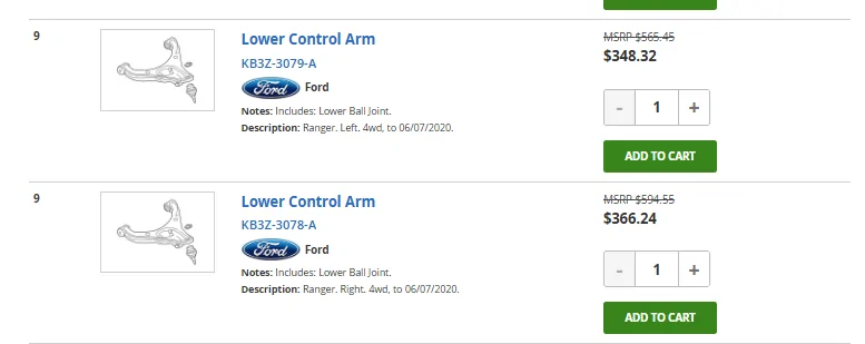

Unreal. Guess I'll start looking at a tremor conversion. Aftermarket LCAs at $2k is also unappealing
How many miles on your truck?
OEM LCA are about $350 per side.

It's currently at 63k but it the ball joint began clunking at least 5k miles ago, we just had a kid and I've been busy so it was on the back burner.
$350 instead of $20 is ridiculous, I won't buy OEM to replace OEM junk.
I'll start keeping an eye on junk yards for tremor knuckles, tie rods, CVs, and LCAs

since you have a 2020 - the year Ford changed the LCA's - Aluminum or Steel, it may be beneficial to determine which you actually have installed - If steel the Tremor LCA should be a direct fit and that is all you would need (to gain replicable ball joints)
However, the Ford parts diagrams are not the greatest in providing details for this matter,
We know that for the (Upper Control Arm & Ball-Joint) must match the Knuckle (Aluminum or Steel) due to ball joint taper (attach point) it appears that the LCA does not require this (mandate) for proper fit.
Bottom Line - is it may be entirely possible to just swap out the LCA's with Tremor style without any issues or any other modifications for either the Aluminum or Steel Knuckle, but would need some verification on this as being true and the only thing the Tremor Style LCA's provide is a stronger casting and serviceable ball joints other than that they are the same as the Non-Tremor arms

From the research I've done I would need CVs, tie rods, knuckle and possibly some brake line brackets. I definitely have the steel knuckle, that sumbitch is heavy
