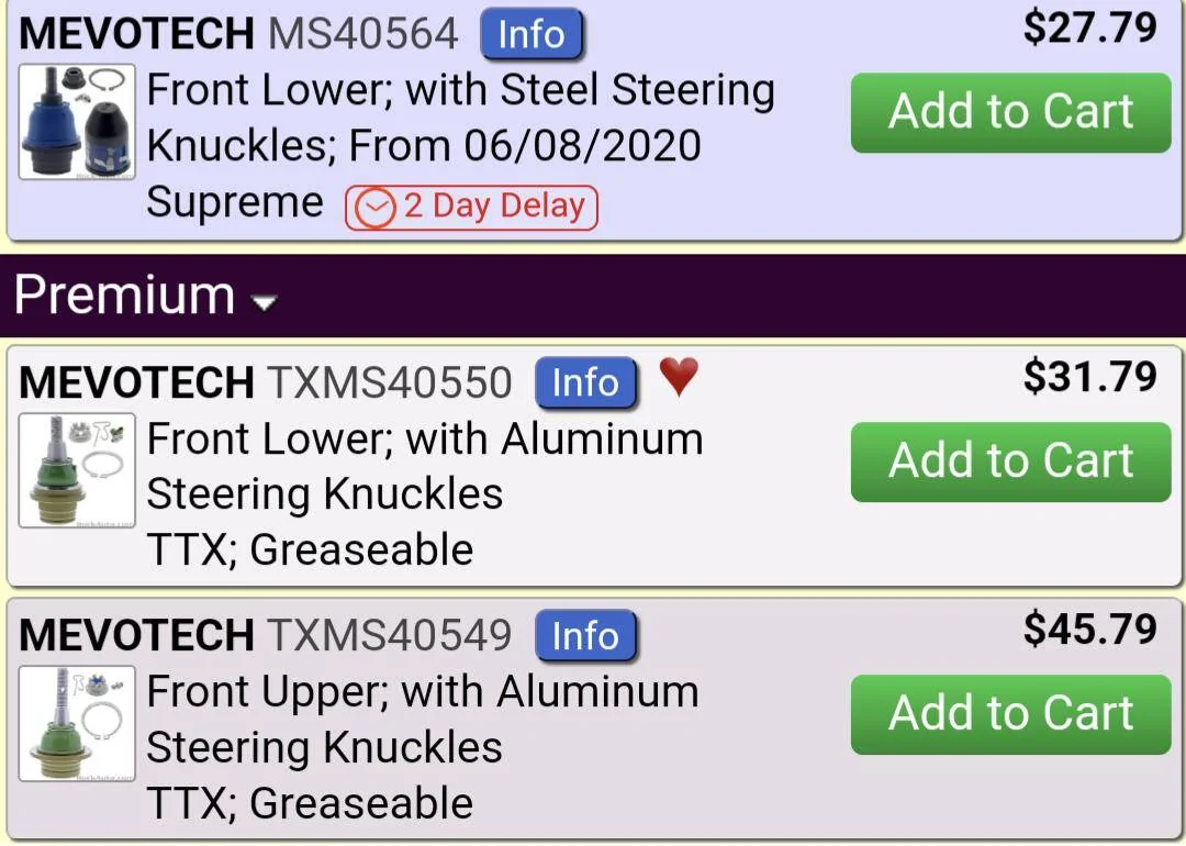

I forgot the date code is at the bottom of the sticker (as well) Build Date = 6/26/2020
X20200626xxxx - so they should be steel - since this was a transition month - I would still use a magnet to double check.
There was a period after the June build
date where they found some extra aluminum knuckles , that they mixed into production....use the magnet or eye test...
Steel are a black color , usually with some surface rust..

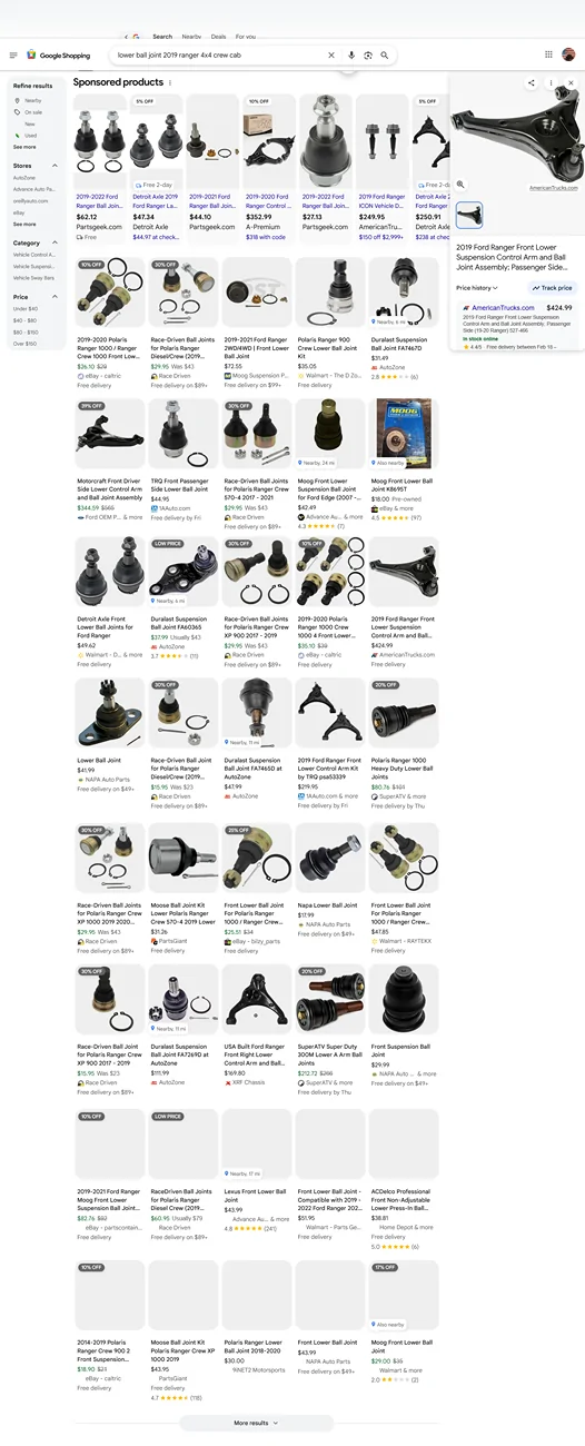

Hi everyone. The lower ball-joint on my 2020 Ranger is failing. Auto zone said i can only buy a control arm and it's $500 for the part. Is this for real? I can't press in a replacement ball-joint? Anyone have any advise on this? If i really have to replace the entire arm should i go aftermarket? I appreciate the help. Not sure what to do.
Here is some scoop to get your ball joints:
https://www.google.com/search?q=bal...cgH2uYCgAgA&sclient=gws-wiz-modeless-shopping
