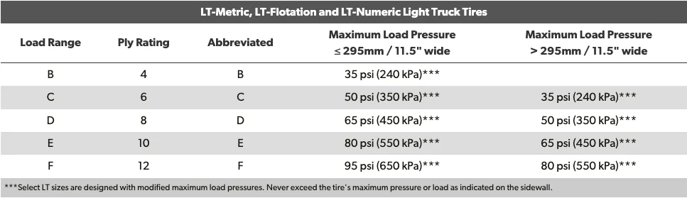

P Rated tires have less “plies”, therefore are more road focused, have softer sidewalls, handle less pressure, and less weight.
Pulled from Tirerack.com
LT rated tires have more “plies”, therefore can handle more weight and more pressure.
Knowing the above and understanding that a C rated tires are 50 psi typically rated 113 to 116 (roughly 2400 to 2700 pounds), conventional wisdom deduces that the 6 ply tires make the sidewall stiffer and allow for the pressure and weight rating.
