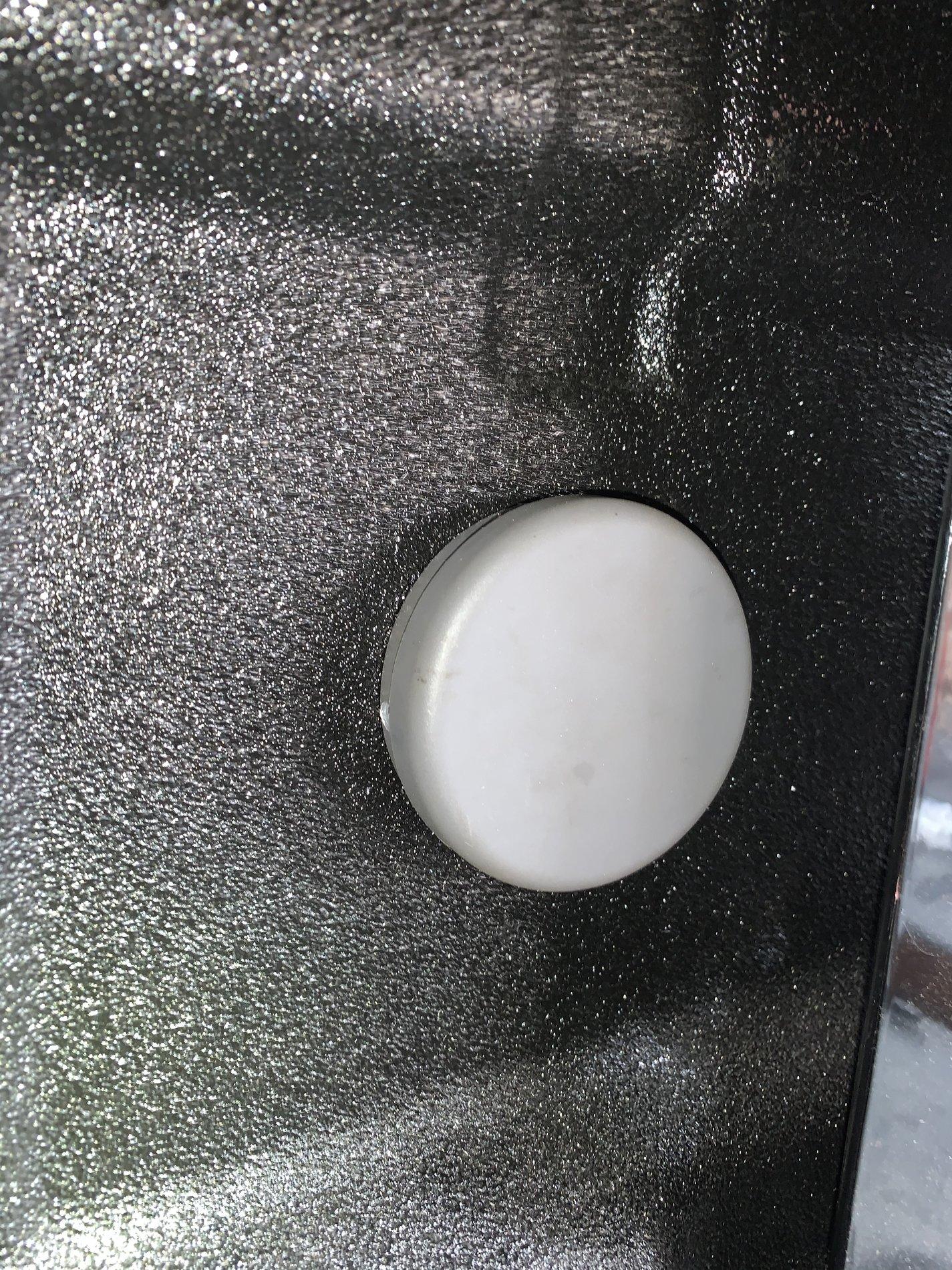

I’m in the process of installing a Viair automatic deployment compressor now. If I can find some info on the ARB locker I’d be all for it.
I’ve attached a picture of where my rear access to air up tires will be.
What is that plastic cap? I need a couple of those pretty badly.

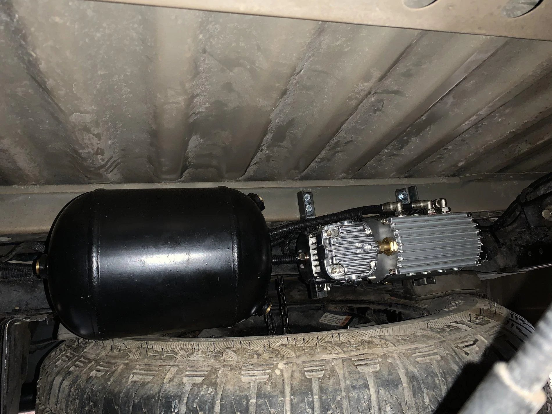

I’ve been wanting to install onboard air, just trying to figure out where to mount it. It’s tight under the hood, and I’m concerned about road debris/dust under the body. Have you guys found a good spot for the compressor?
My tank and compressor are going above the spare tire. Only place with enough room to fit and work on it. My compressor has a remote air filter that I’ll be mounting up high in the bed cavity somewhere and the compressor is IP67 rated so it’s good to go in the water.

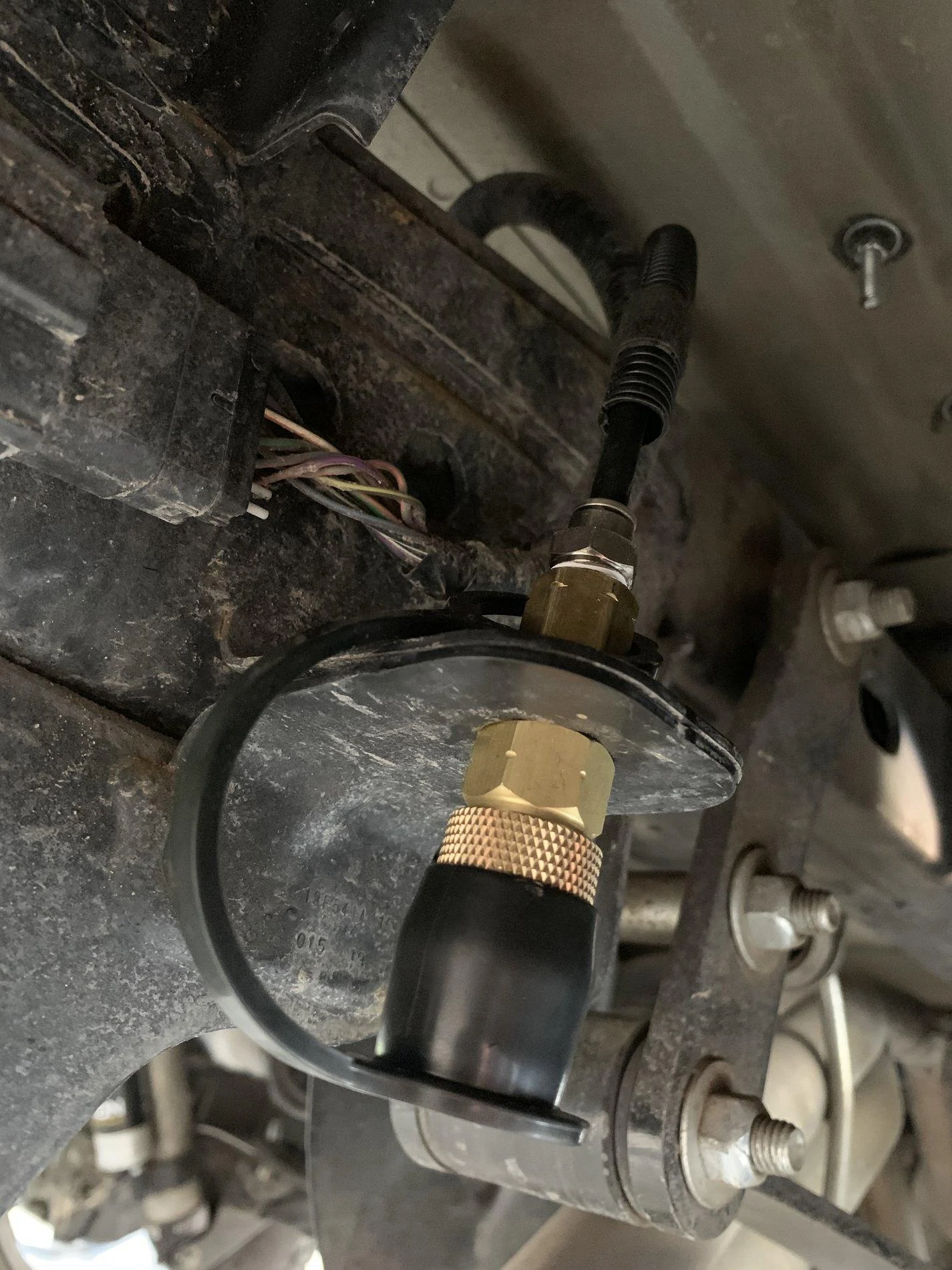

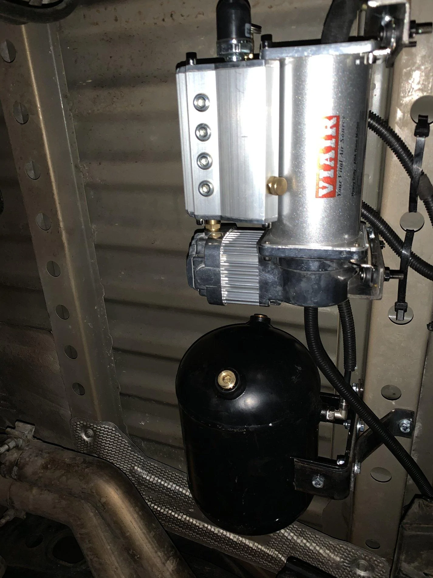

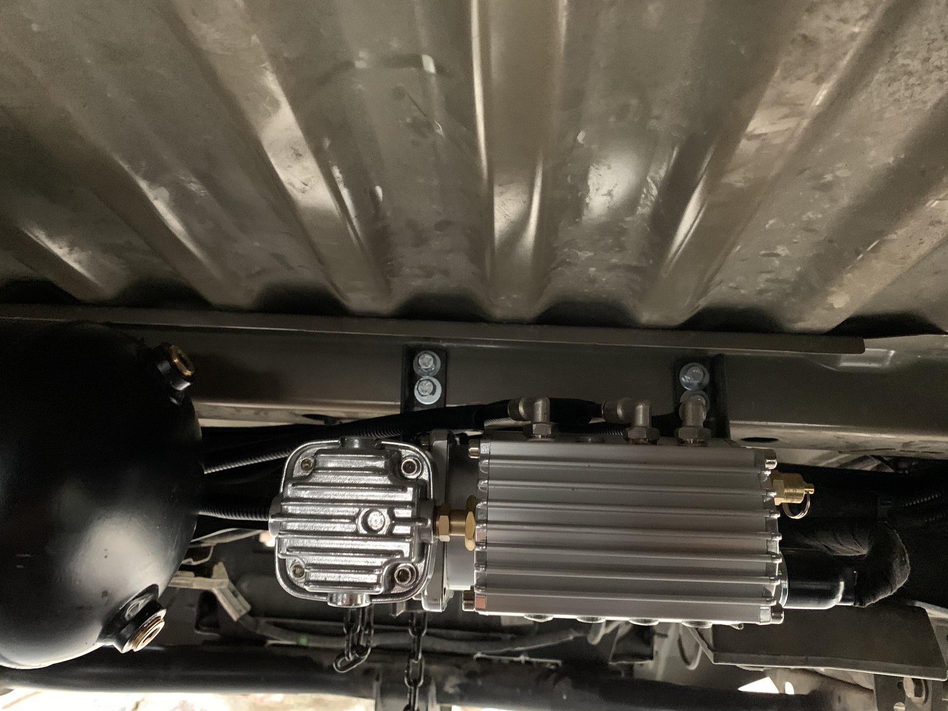

Okay air compressor is installed and running like a dream. Really happy with how this worked out. I’ll have to make a more detailed post later with how it all went.
Plenty of clearance in this area and would be nice if a machine shop could make some custom brackets for everyone else to utilize this space.

Not sure....can you still get to the spare tire winch?

Yes it’s accessible from the rear as it usually is. I dropped the tire to work on all this. The view you see is looking from the rear differential to the bumper. So the winch and funnel point are behind all of this.
Hi Andy,
Thanks for reorienting me. Nice job by the way!
