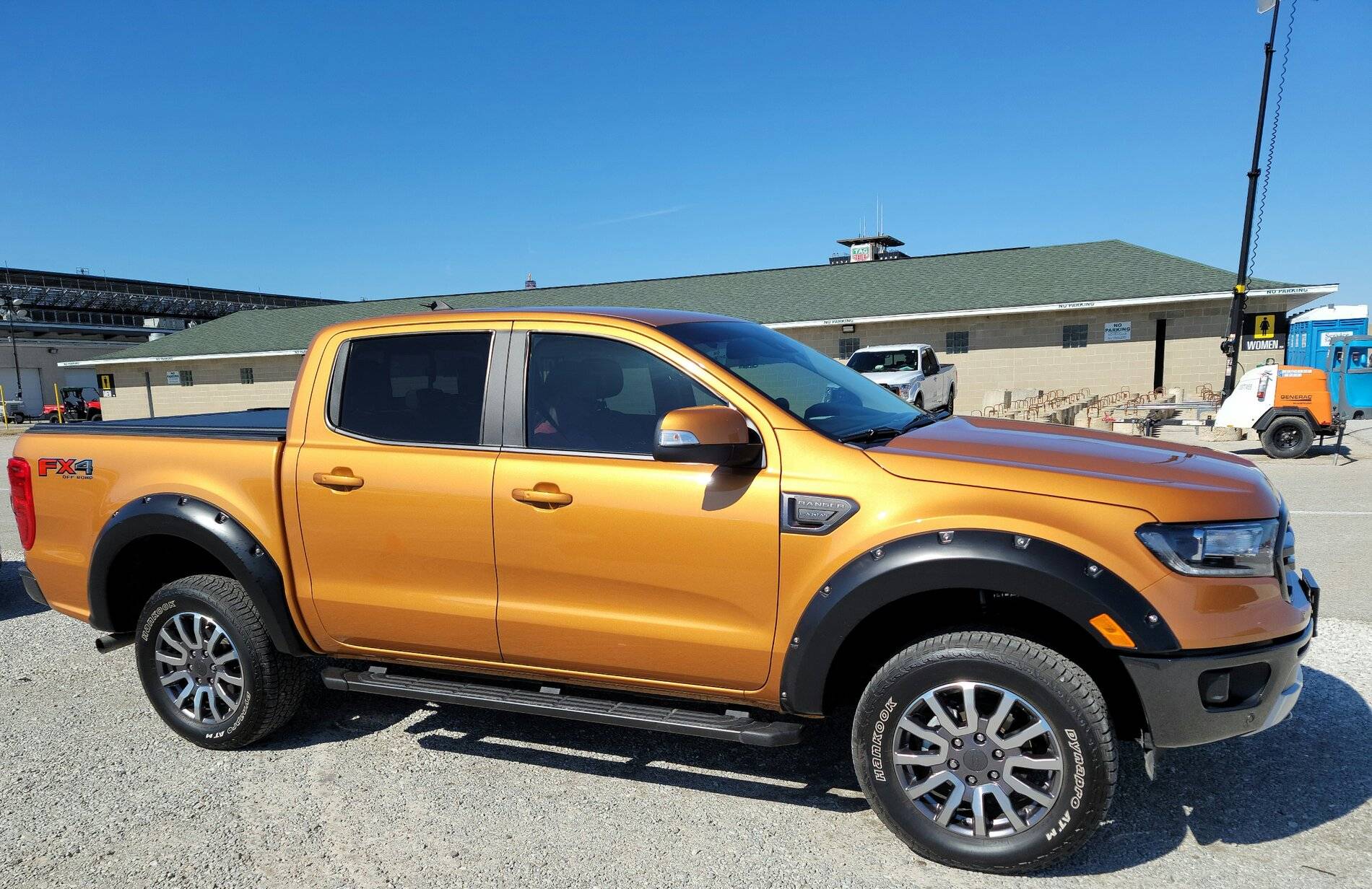

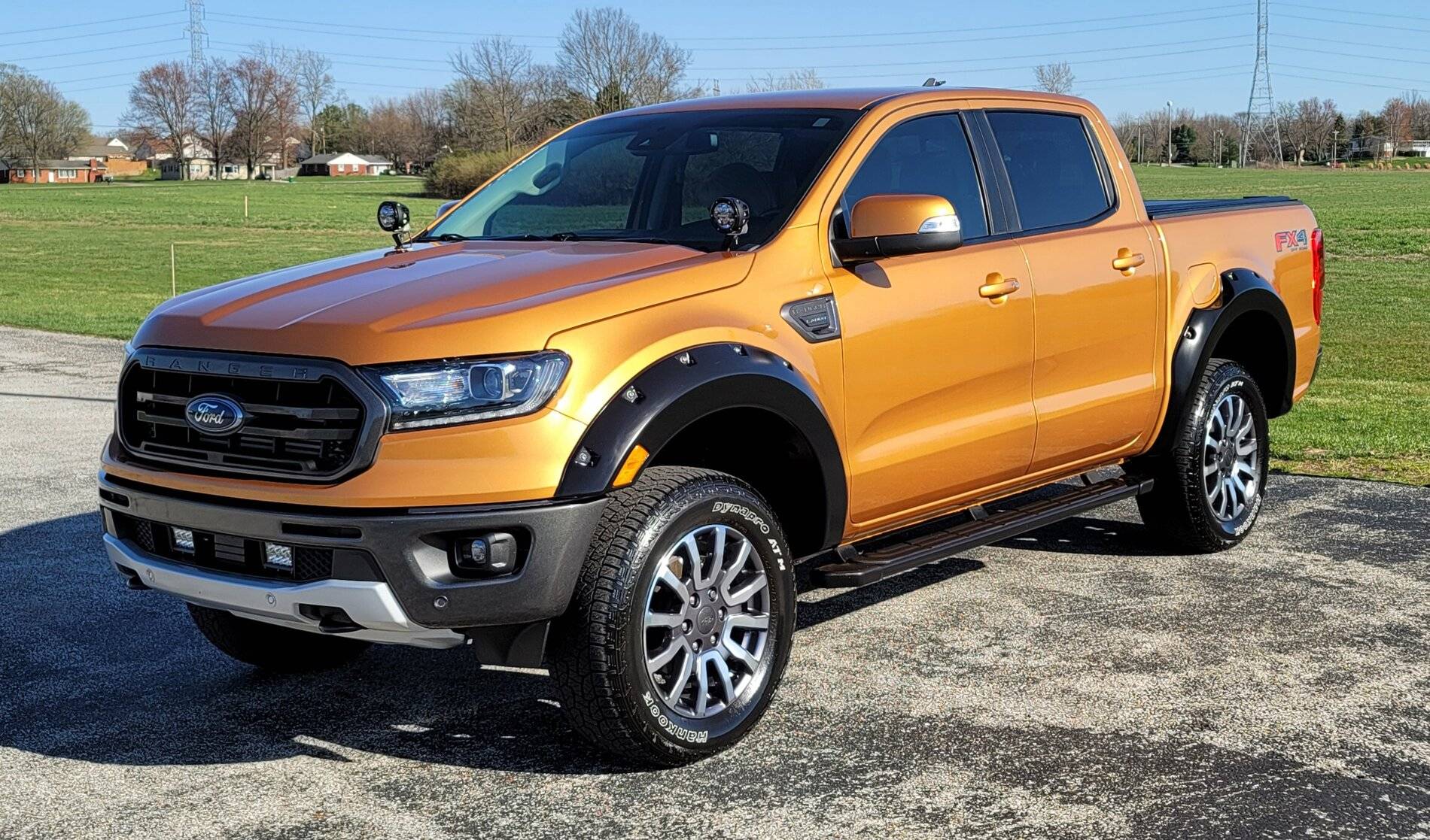

My truck has Bilstein 5100s, no lift in rear. 2 inch lift in front to almost level, I have a short garage header. I measured at the top of my stubby antenna and at that spot I only went up a half inch. Not going to add the last inch of level lift until I go from 265 18 to 285 70 17 then measure my clearance.
My trucks a 2019 Lariat FX4 with the 18 inch oem wheels.

EHS

Did you go with the 1.8" setting? If so, do you have any pics which depict the "almost level"?
We did the 1st band, I think it's a 1 1/4"? Then we added a 1 inch plate at the top so its between 2 and 2 1/4" lift , I chose a hybrid combo so I didn't loose out on ride quality. If I can go up more there is a lower plate that mounts under the shock so I don't have to drop the spring assembly again.

EHS
Ahh gotcha! Thanks for the clarification. It seems most people are sticking with either the 1.2" setting or going straight to the 2.5" setting. I think 2 inches is perfect.
